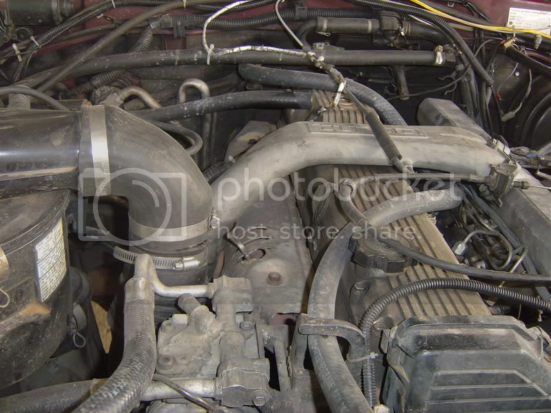

maybe this help .. in my 2H
Thats a 2h, but the idea is the same. I put it in a similar place just ahead of the crossover pipe, behind the a/c compressor. 2 inches from the head. It's that bent silver looking thing coming out of the hole on the exhaust shield.
Remember to take the turbo off before drilling a hole in the manifold. Turbo's don't like metal shavings in the impellers.
Hope this helps.
