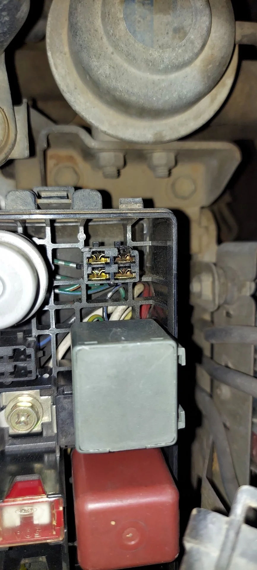

Daily driven with 315,000 miles and 7 years since I replaced it, this is what it looks like as i type this. Where is the fire?

The only fusible links in the cruiser are the ones at the battery in the little plastic box. If you just replaced the wire between the relay and fuse, that's good. It's a tried and true upgrade for this problem.
