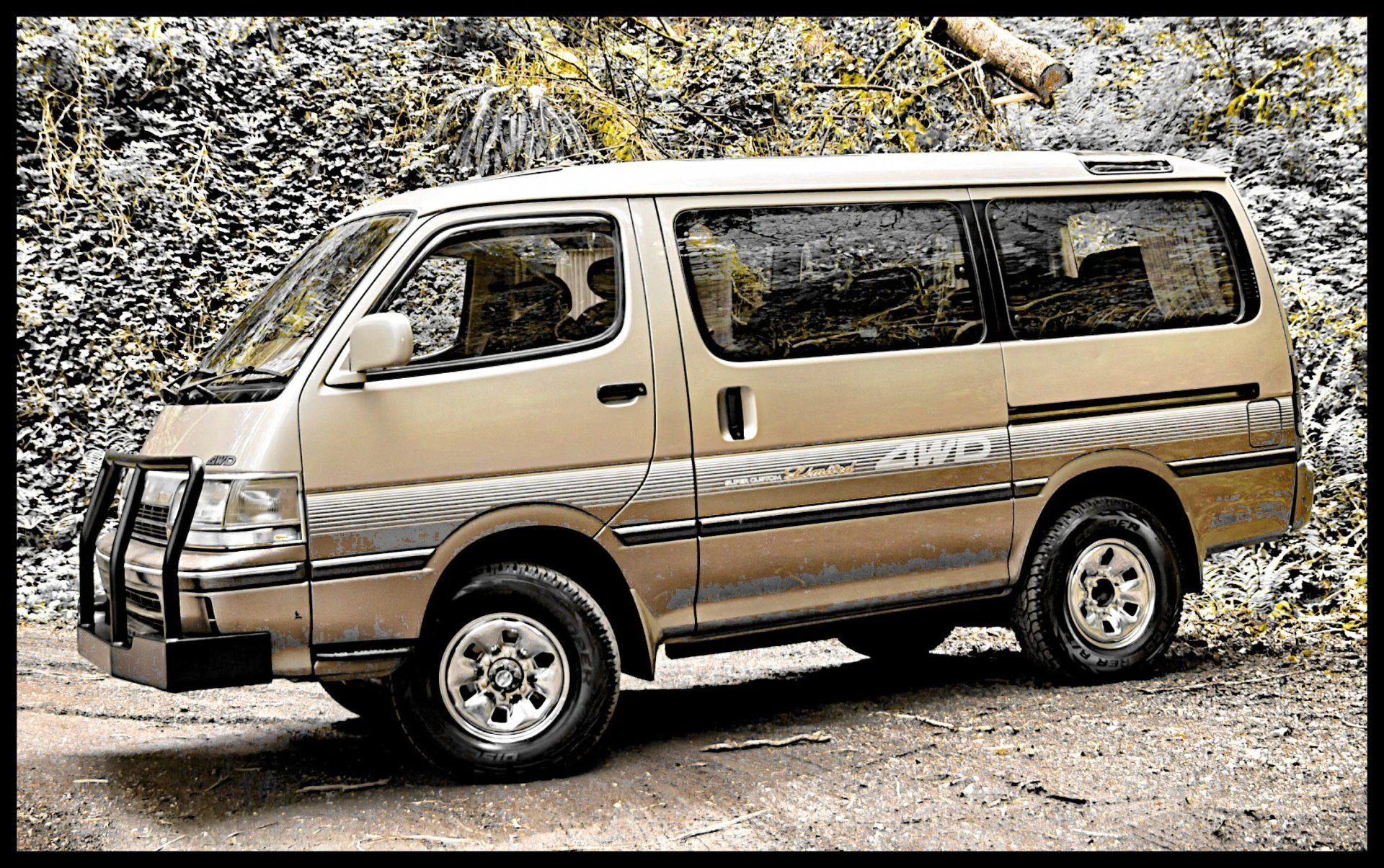

Early ‘90s Toyota 4x4 vans, diesel powered. Limits and capabilities. ??? This the HiAce
Discussions on the early ‘90s Toyota 4x4 vans, diesel powered. Limits and capabilities. - title of new thread.
Early ‘90s Toyota 4x4 vans, diesel powered. Limits and capabilities. ??? This the HiAceView attachment 2326719
I love the combo of missing/flaking paint and tire shine on a dirt road! Did they apply it before or after driving to that spot to take that image?:lol:
1993 Toyota HiAce Super Custom Limited, 4x4, 2.8L naturally aspirated 4 cylinder diesel engine. Hi-Low range. It can be fitted with an after market air locker on the rear. Also can be lifted easily 2.5” to accommodate larger tires on 15” rims. I think you can also find 16” rims that will fit. Biggest drawback is that it is very slow on hills and cannot travel at speeds commensurate with highways in the american west.
