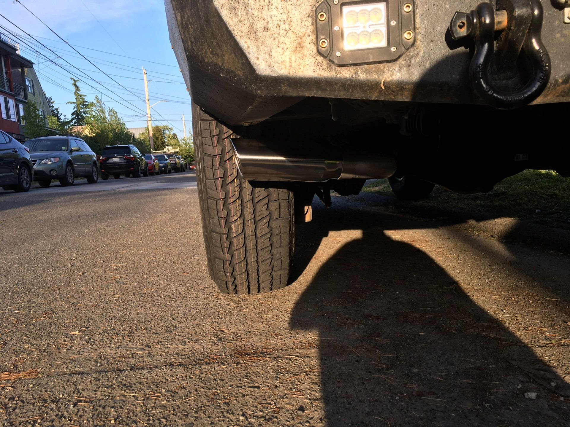

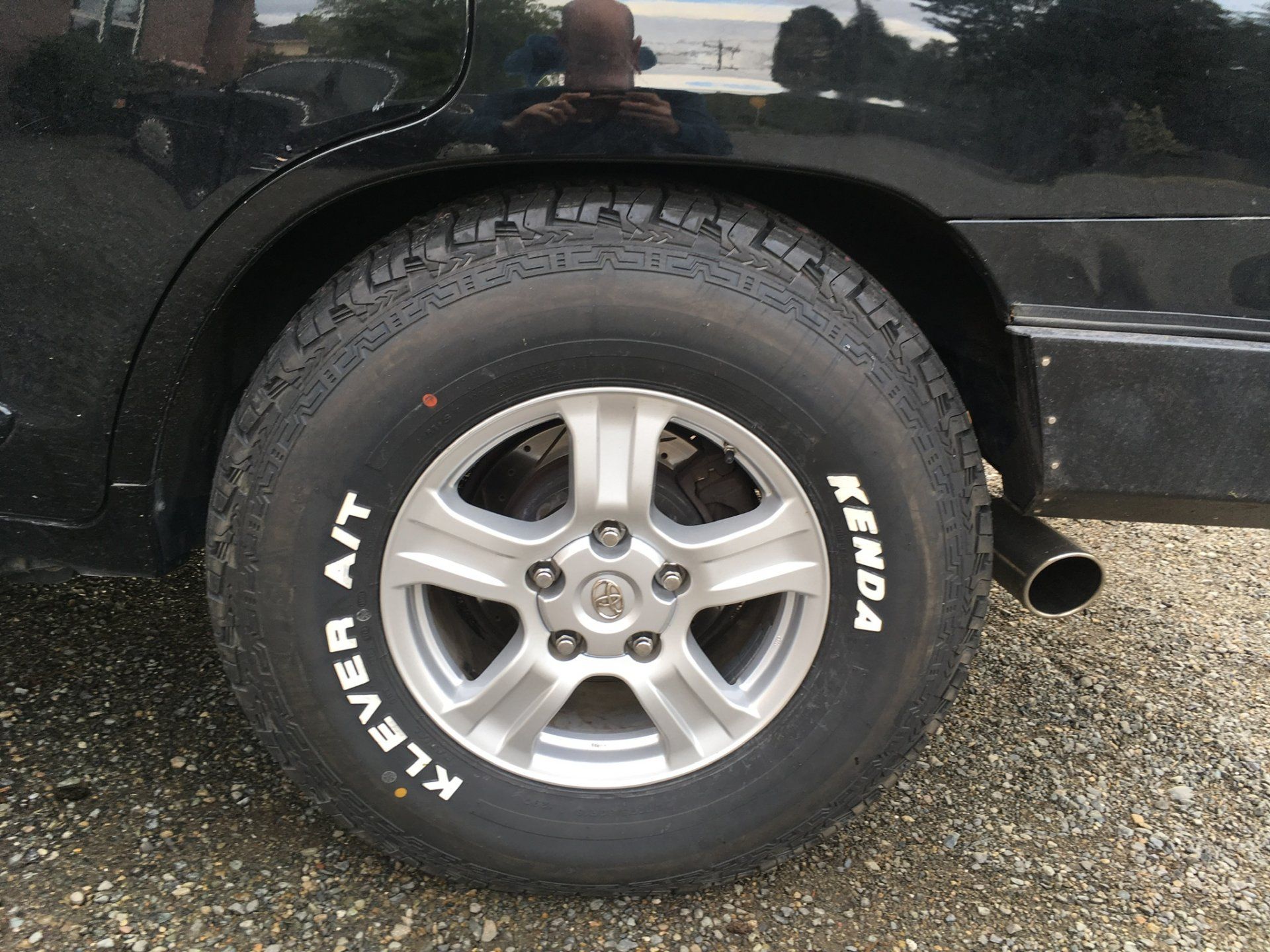

When I did a full custom exhaust on my FJ-62 to deal with the higher manifold placement due to the 2FE I did a side dump with a slash cut tip because I would hit the pipe out the back from time to time. Worked great. I was worried about exhaust maybe coming back in but it wasn't an issue. I never got into a place where dropping off a rock was an issue though because, well, 60/62 quarter damage is body work not a plastic shell.
Haven’t shelfed it yet.
I don’t notice it , so I guess pretty good !??
I did notice after the resonator cut and before I got around to the repointing, that put exhaust smell everywhere diffusely.

This is encouraging. @jrmudder92, I like how high and tight you got yours. Thanks all.
For sure. I wanted it high just in case of hitting a rock or what not.
