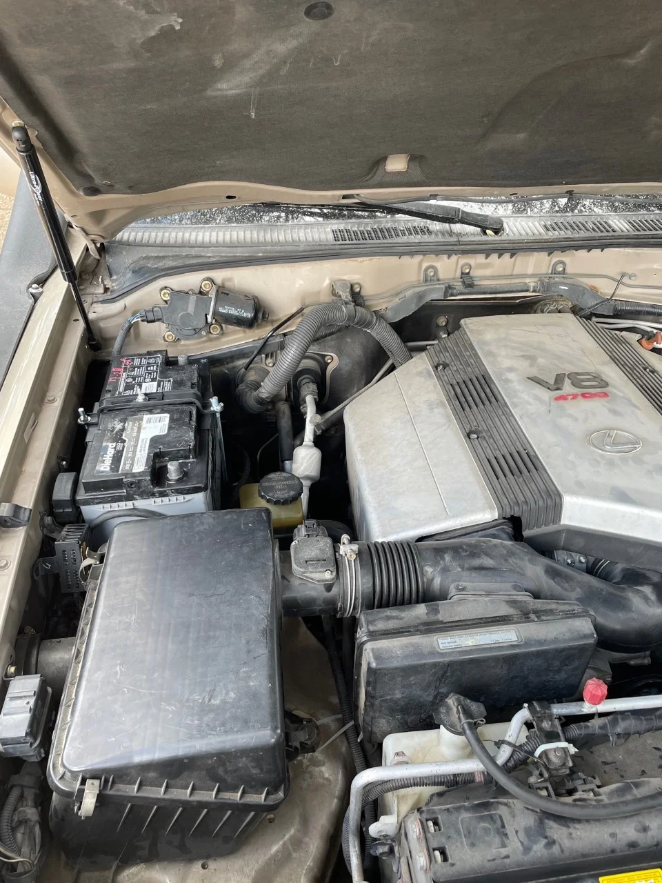

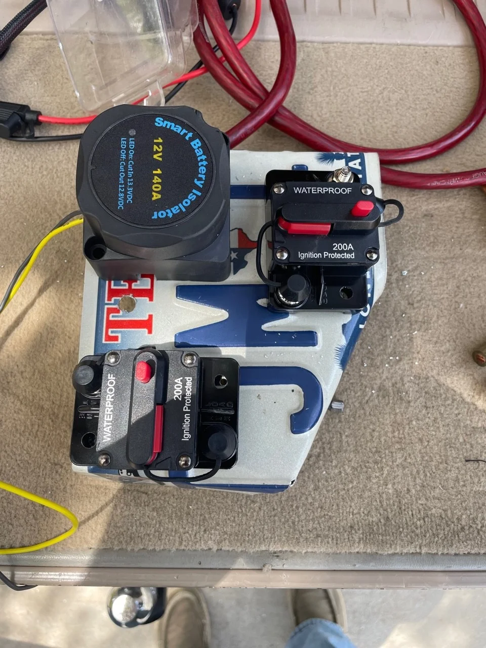

Does anyone else have a dual battery set up using something other than the Slee tray? I just don’t want to spend $200 on that tray when there are generic options for $20-50. Does anyone know of a thread or have you done that yourself? I’m sure there’s someway to get a generic second battery tray installed where the AHC goes, I just would like to see some examples before I start messing with it, if possible.
