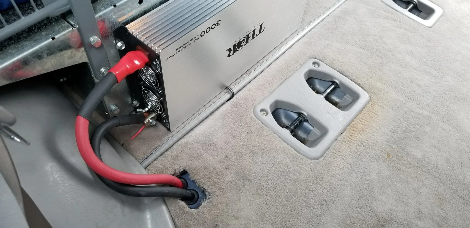

What gauge wire is that run to the power inverter? What do you plan on powering with it? Looks like a very expensive unit, I assume you have a use for it.

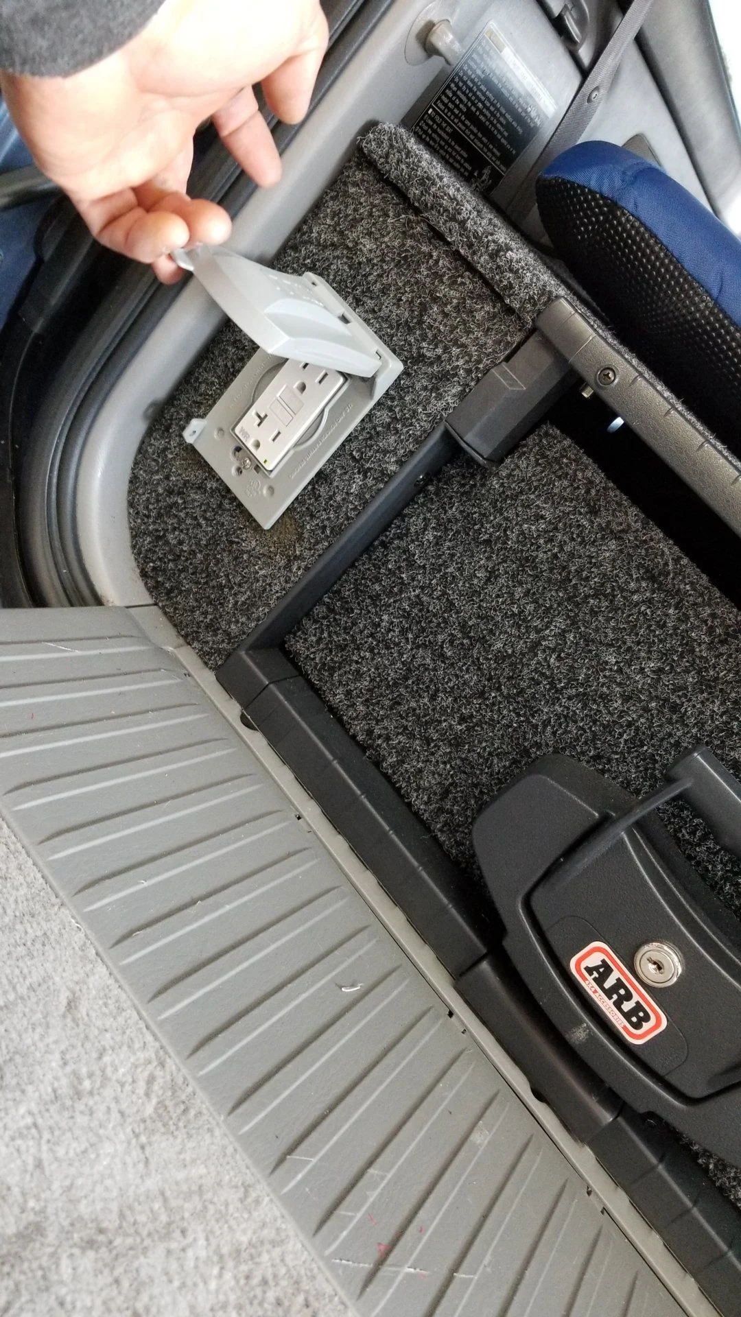

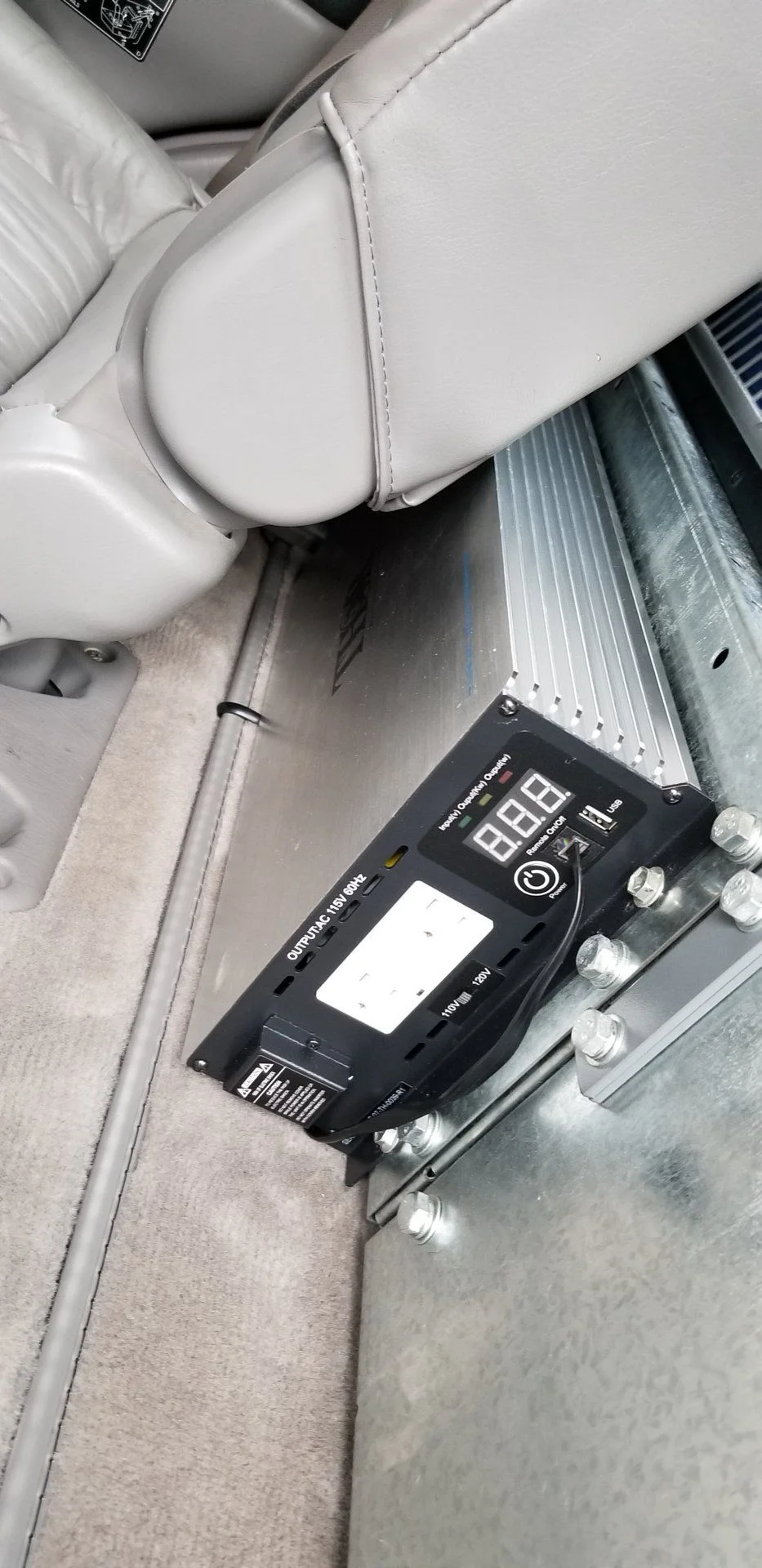

Do you have any more pictures you could send me? I just bought 1000w inverter to connect to my secondary battery and can't find a good spot to install it in my 00 Landcruiser.
This is true. There is really not a good place to put it. You can't have it too far away from the battery. Also,
I grabbed these from Amazon:
https://www.amazon.com/gp/product/B0161NXKB0/ref=oh_aui_detailpage_o09_s00?ie=UTF8&psc=1
The wire that came with the kit was only 10ft long and all black. I had to run the wires outside the cabinet. They were too think to hide. I thought about putting some protection on the positive wire but the coating on them are pretty thick. If you have drawers, the space behind the rear seat seems to work. I really don't know other spots. Maybe if yours is small enough, it will fit behind the quarter panel trim?
I figure the amount of work/effort to install was the same so I went with the biggest one offered. Daughters are 8 and 10 so I'm planning some camping trips.

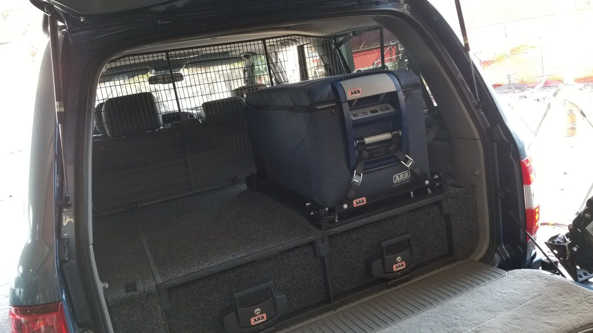

Can you take a couple of more pic's showing a little more surrounding area? The close up's are great, but I'd like to see the "big" picture also.
