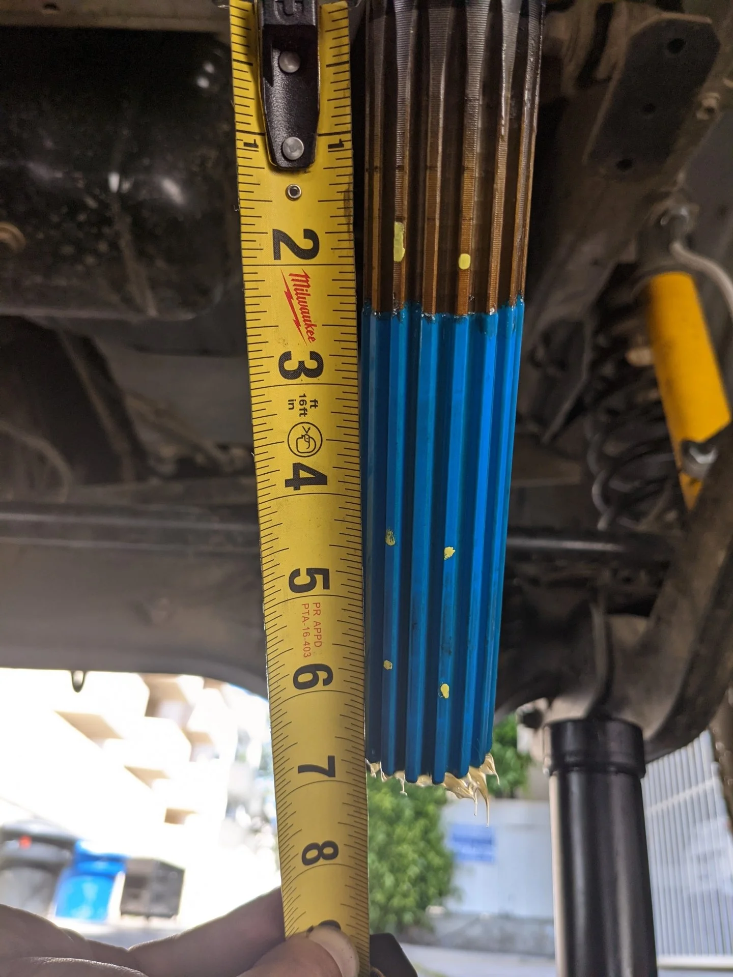

You will measure flange to flange while you're at ride height.
  • Like
Reactions: CJK
I was typing exactly the same as what @enox said. It will take more time to grab your tape measure and walk to the car than it takes to get the measurement
