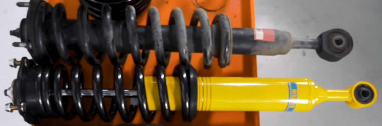

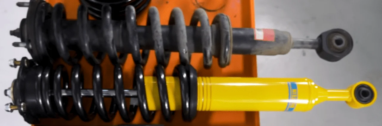

I went and dug more on how the Partsbox Cruiser was built. Their setup does add quite a bit more droop travel looking at the length of the aftermarket coilovers. Looks to me like ~2" longer droop travel, which is not unheard of with some suspensions. They did also add a front diff drop which should account for the stress of added droop to a degree. The unknown in my mind is their alignment and if they tried to bring the tire forward too far with the UCA, as that's perhaps known as a CV stressor? And whether they've been using OEM CVs to @04UZJ100 point. Just something doesn't seem quite right with a CV letting go in such fashion.

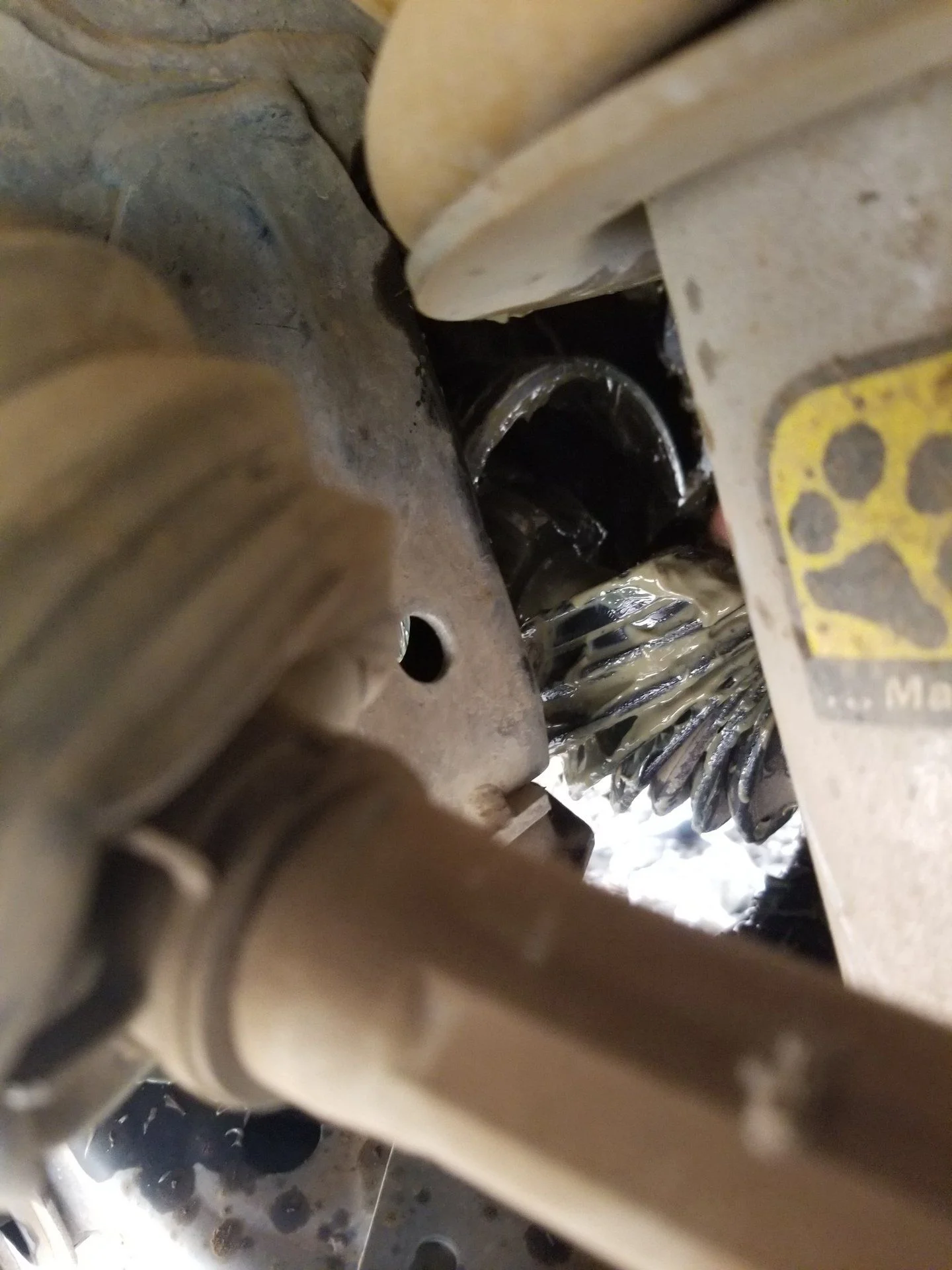

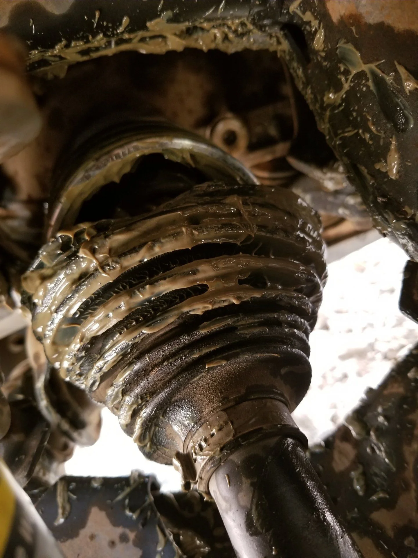

Interesting read here. Good stuff. My failure was driver side too. When my CV busted it was on a steep incline, loose dirt and lots of wheel spin when it decided to give out. Not sure if the boot got torn earleir on the trail and then failed at this moment of woefully ignorant driving.
Specs
2013 LC
87,000 miles
2" tough dog lift
33" tires
Weight is approx 450lbs over stock

This is something I’d like to add to my tool chest and mechanical knowledge/skills. Thanks for the link. I ended up driving home with the center diff locked and the front driveshaft removed. It was a noisy ride home and uneventful. fortunately nothing else was damaged with the CV flopping around.
