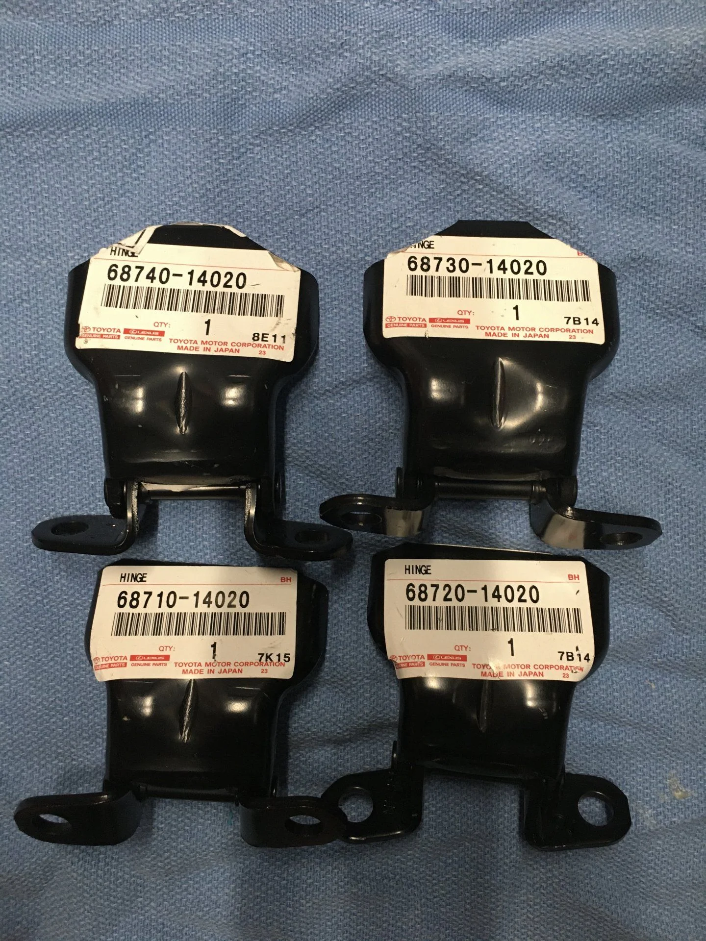

Hinges are available new from Toyota. FYI.
Buy/order a cheap correct wrench.
I looked for hinges and couldn't find them on the McGeorge site, do you have a part number or a site?
Thanks all for replies and photos. I've ordered the Toyota door adjustment wrench to fine tune the adjustment.
