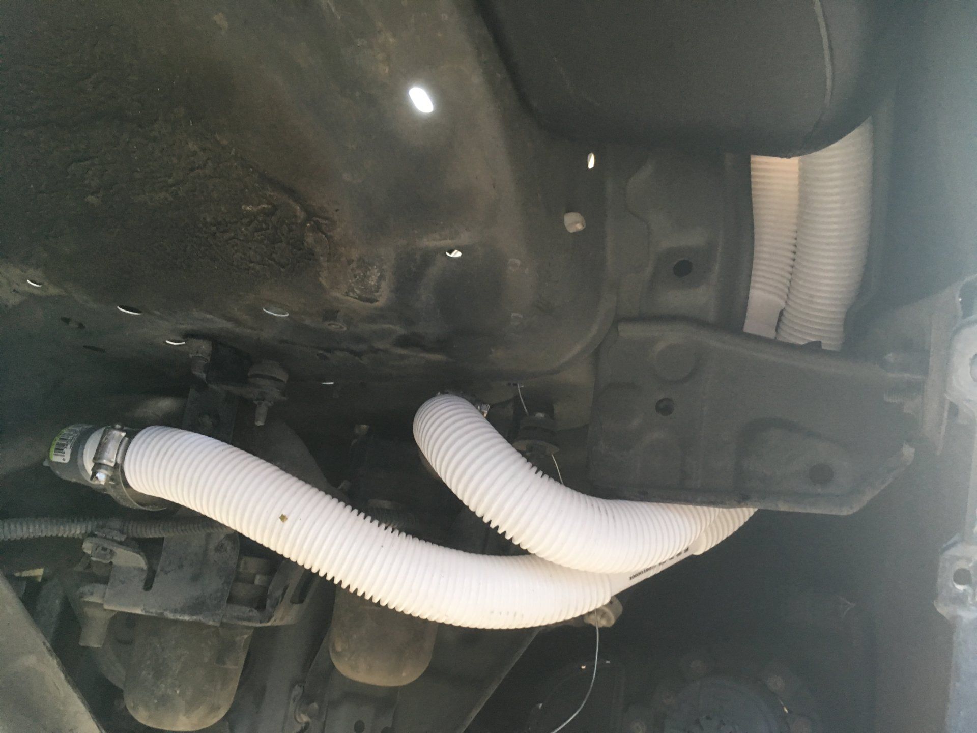

I plumbed the air intake pumps into my snorkel. All right there within a few inches of each other
Tgats clever.
Seems the function it seeks to cancel is a totally useless EPA thing. I like the idea of just deactivating it. I’m told its badically plug and play simple.
It was about $15 for a couple fittings and some random hose. I guess the AIP is still a risk, but I think far less so.

I disconnected the horns and removed the factory hose from the air pumps. The air pumps are in the right hand front wheel well, behind the wheel liner.
I wandered around Home Depot and eventually found some tube about the same size in the washer dryer section.

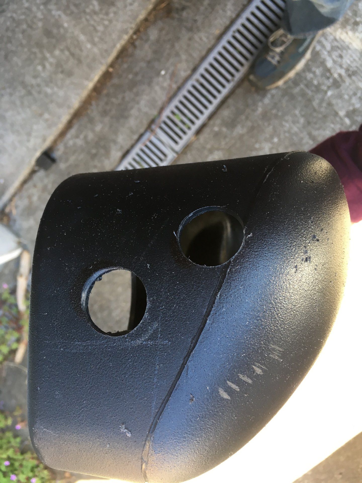

Put a couple fittings into the snorkel in the front to connect to. I used double barb, it wasn’t great. Suggest using actual bulkhead fittings, but the principal is the same.
Connect up the tube and now the air pumps won’t drown.
There was one report of a forum user rerouting the air pumps and using smaller diameter and having an issue so make sure to preserve the diameter
