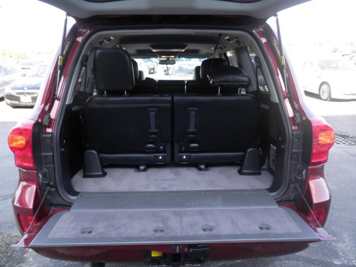

Does anyone make drawers for our truck with a third row installed. I use my third row quite a bit with the kids and would like some drawers that I can take in and out when I need to. I’m hoping these aren’t going to be custom only, but I’m afraid that might be the case.

I believe there are several. What is the measurement between the seats in the upright position? Mine are removed. For example, the Landshark Reef 40 boxes without side wings are 40" wide.
It's pretty niche. The 200 market overall is niche... I'd recommend just getting a drawer module that will fit- Goosegear, us, whomever- and make your own mounting solution/plate. It won't be perfect but any organization is better than none!
The space is about 36”, which is an odd size from what I’ve seen.

Do you want one drawer beside a third row seat? Or something that is behind both third row seats? Or something to go between the stowed third row seats?
I can confirm the land shark single drawer will fit with a third row seat deployed and stowed.
If you want two drawers in between, a stacked land shark would fit ‘high tide’ and have some space for bags to the side.

I hear what you’re saying, and a single Land shark might be my only fabricated option. I’m ideally looking for a drawer(s) that will fit between the third row seats up in the stored position (approx. 36”). My end game is to have storage with a sleeping platform while I’m out.
IIRC 36" is the distance of wheelwheels in CJ/YJ/TJ jeeps, so those products may fit your needs. I had these in a wrangler years ago and they were very sturdy.
Exterior Dimensions30" L x 35 3/8" W x 8" H
What about going the other direction and doing really thin seat, that could bolt to the top of your drawers? Like an early model FJ40 seat... you'd need to get a little creative with the seatbels but that would be pretty easy for lap belts. Then you'd have actual drawers under them, and the kids could sit on top.

Wondering if one seat would fit with one ARB drawer. I haven't made the measurements, but will
Just looking to see if anyone did that? I would then use wolf packs with the seat up for stuff that I have in the 2nd drawer or stack my two drawers and mount fridge to floor with seat up??
Just thinking about it for now and wanted to see what others have done and what works.
from when I bought it. looks like one drawer should work. Measure twice before I do anything . . . . If I decide to do anything

I can do without 8 seats as it's a rare occasion where 2 cars will do. Definitely need 6 however for road trips. I took the drivers side 3rd row out which made for a ton more room. I'm considering a drawer to better manage the space with a fridge.
I saw a pic somewhere recently that had the drivers 3rd row taken out and had Dobinson drawer in. Couldn’t find it.
Yeah it fits.. but it's really tight to get that seat to flip down, you'll have to squish the seat foam a bit, and the galvanized metal of the ARB drawer will get the edge of the seat really dirty. Also be careful the bolt heads don't tear it. But yeah you can make it fit Ken. it's not gonna be fun though.
