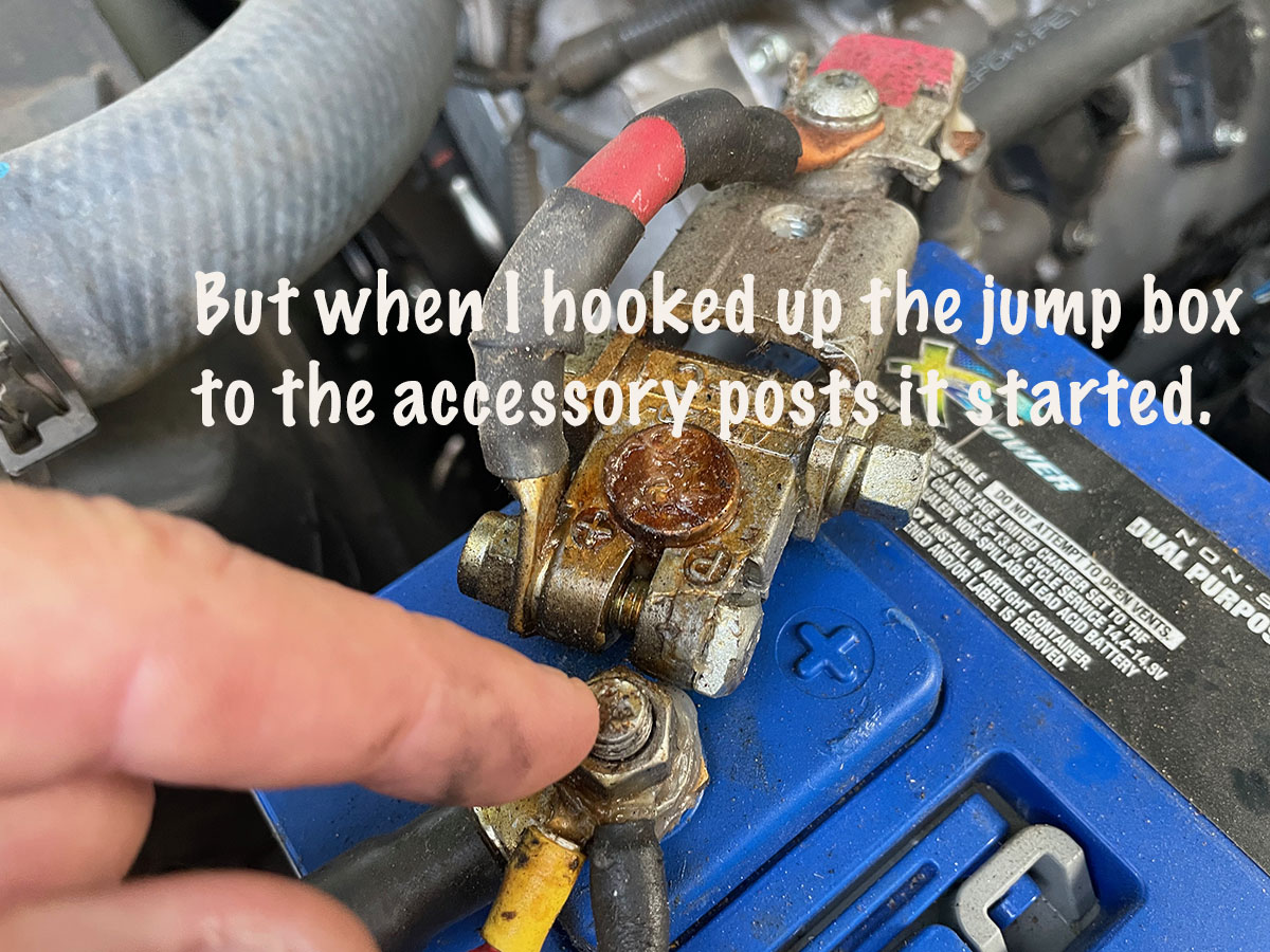

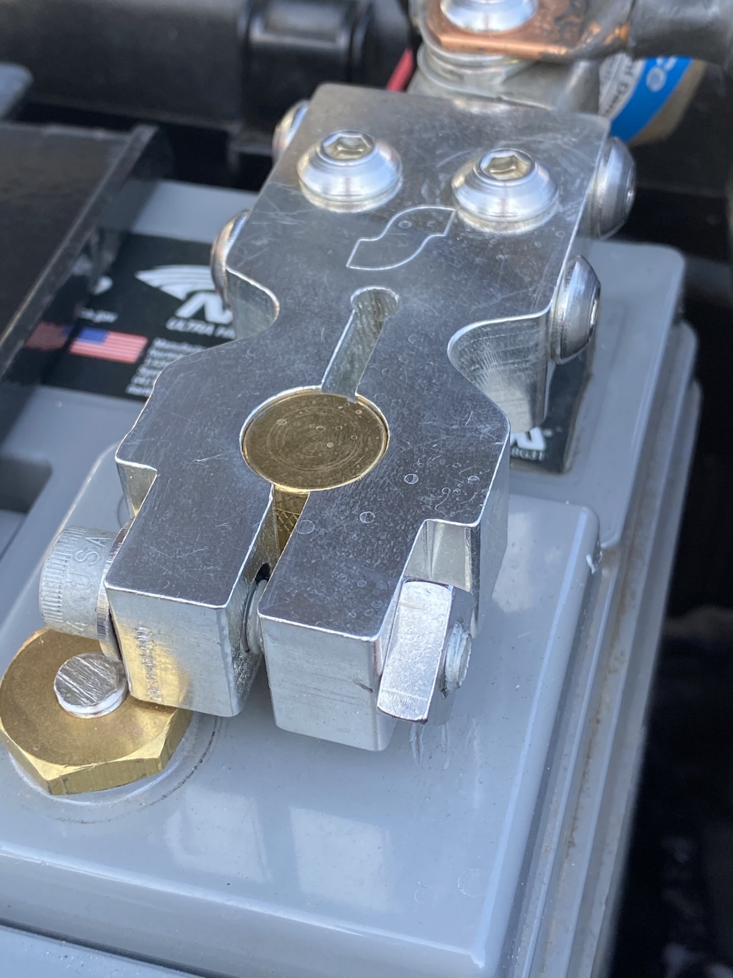

Just a thought. Do you have the newer Slee billet aluminum terminals or the older Slee military terminals with aluminum extensions? If the older ones, check for corrosion between the aluminum extension and the military post (see below).
This.** (about terminal extension above)
**With the older slee terminal extender, clean the surface between the sandwiched layers of metal after removing its little bolts…not just the terminals on the battery. A fouled terminal extension could alsi prevent jump starting if current still has to go through the fouled extender.
But first… Are you getting zero power to ANYTHING (interior lights, dash, etc) when jumping? If so, its not your starter. ;) This would also point to the terminal extender being fouled. I’d wager if you jump, bypassi g the extender, you’ll at least get dash power, lights, etc.
You could also bypass the extender and jump start by connecting the positive to the extender itself…just to see if it turns over. I’ll bet it will.
No jumper handy? Pull the dead main (clean any extender surfaces)…& swap in the aux battery in its place. Try starting.
**If any of this doesn’t make sense or you’re unsure… STOP. Don’t do it. Consider towing it to a dealer.

2. yes, the vehicle was totally dead. No lights on the dash at all. Battery was at 5.30 volts. Second battery at 12.5 connected by battery switch. turning switch on was no help.
3. I DID have problem with the connection corroding on the Slee Battery extenders shortly after installing them a year ago. Chris Slee said to make my own bypass cables and install them. I did.
4. When I tried to jump it with my jump box. I attached it to those aluminum Slee battery extensions. I actually attached it to the place that must be bypassed by the cable bypasses I made.
5. when I attached the jump box to the accessory posts, immediately, the cruiser beeped, the headlights came on, and my wife started it right up.
Look at photos to get a thorough understanding of what I just wrote.

What Cole said.
You probably don’t have bypass cables as Cole does, but Cole’s bypass cable photo helps show where you might connect a jump start cable (+) if you try again. So you’d be getting current to basically the spot where Cole’s extra cable bridges to (past the slee extender).
Also suspect your main battery is basically toast at the voltage you mentioned.
If you determine that the slee extenders are too fiddly (and prone to fouling)… Slee now makes these now (although this is an earlier prototype). They eliminate the stacked metal and are super solid. The final version just tweaks the tightening bolt and a could other minor changes…
