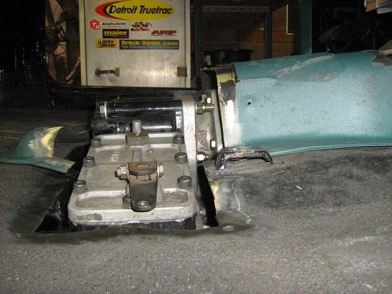

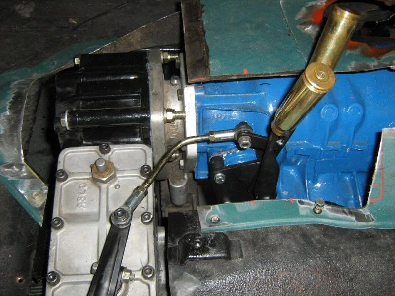

Well, it almost fit. I knew that I was going to have to cut the floor. Over the next week or so I will be making twin stick shifters, and patch the tunnel cover thingy.
:steer:

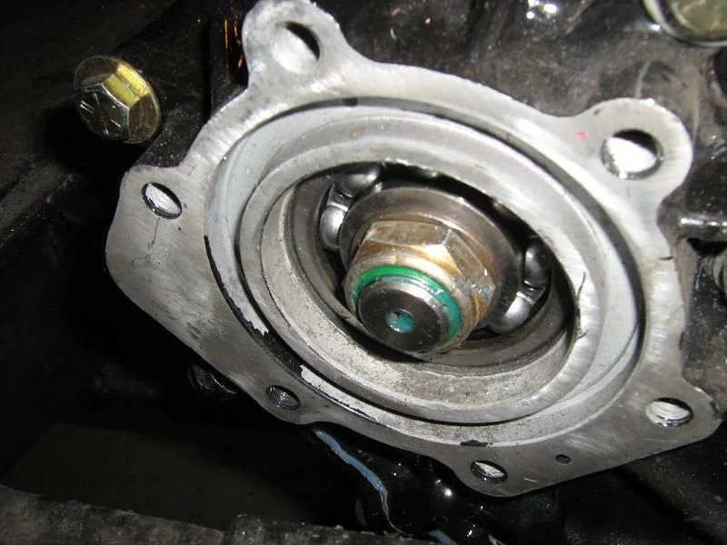

As for the hole in the top of the plate, I will probably dribble a bit of gear oil in there to ensure the bearing is not dry.

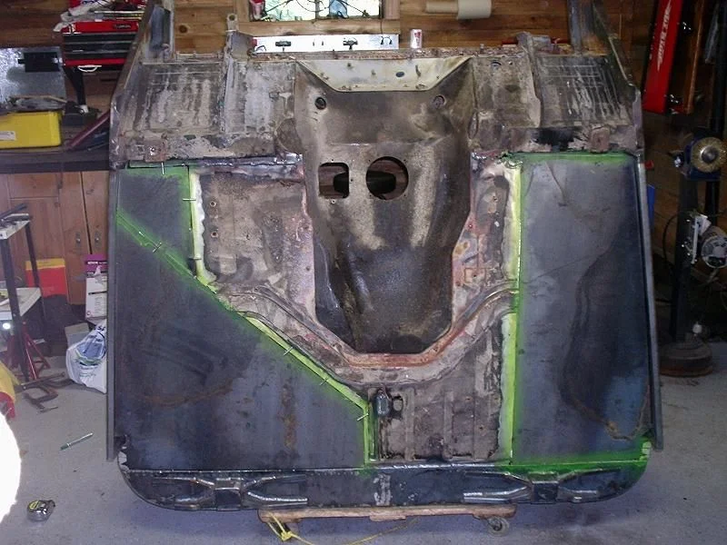

I wanted to keep a little of the original style of the rear tub body mounts. I came up with this to replace the rusted crap. The last pic is it just sitting on the tub. More pics of the finished product welded on tomorrow. I am very happy with how it turned out.
