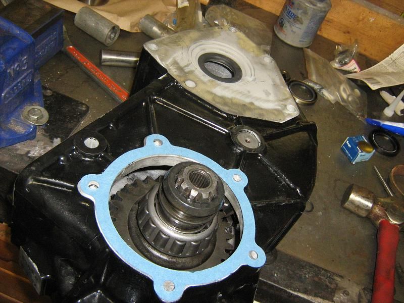

I rebuilt the tcase... (CAUTION, TURD POLISHING TO COME)

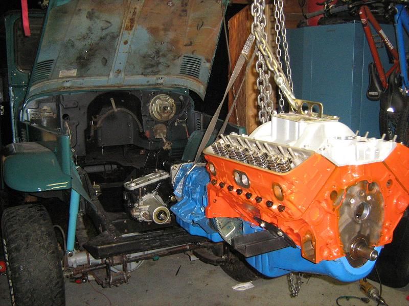

I got the trans / transfer / adapter together tonight.

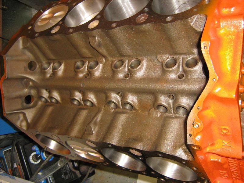

I bolted the engine together yesterday with rebuilt 2002 Vortec Heads and other stuff.....
Pics tomorrow of swap. It has been a long time coming. Trust me.

ok, ok, ok.
I know I have been a little picture light and vague on details lately. I have been busy over the Christmas break, and I am trying to get as much done as fast as I can.
Today was a long day getting the engine / trans / tcase in. Pics of that in a second.
As for tech....

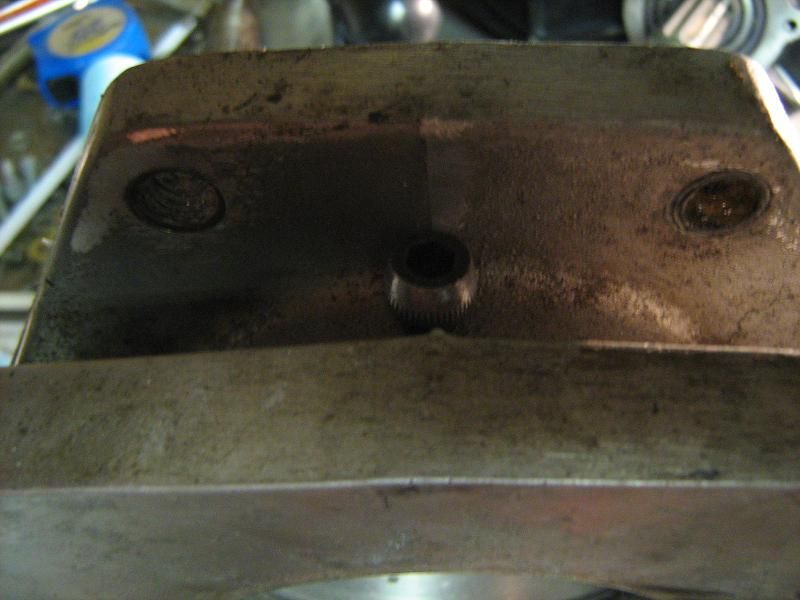

I may have found a fault with the Advance Adapters plate I bought (Other than a couple stripped out holes !?!)
Anyway, there is no prevision for LUBRICATION for the bearing on the tcase side of the adapter as it is between two seals. This is just a factory 3 speed trans rear outputshaft bearring that is usually lubricated by the trans gear oil.
I added a "Fill Plug" to the top of the adapter. (.75" area to fill)
Nice work! That should be a sealed bearing so the fluid does not pass through and into the adapter. I have found trans fluid in my adapter not much ¼ cup, but it never past through the sealed t-case bearing. I have my old set up at home and can look to for the bearing number if you want.
