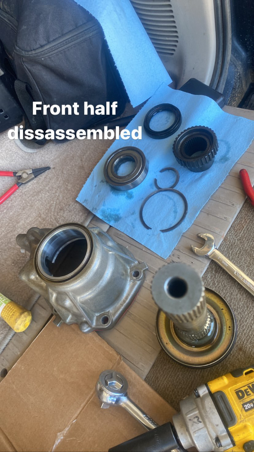

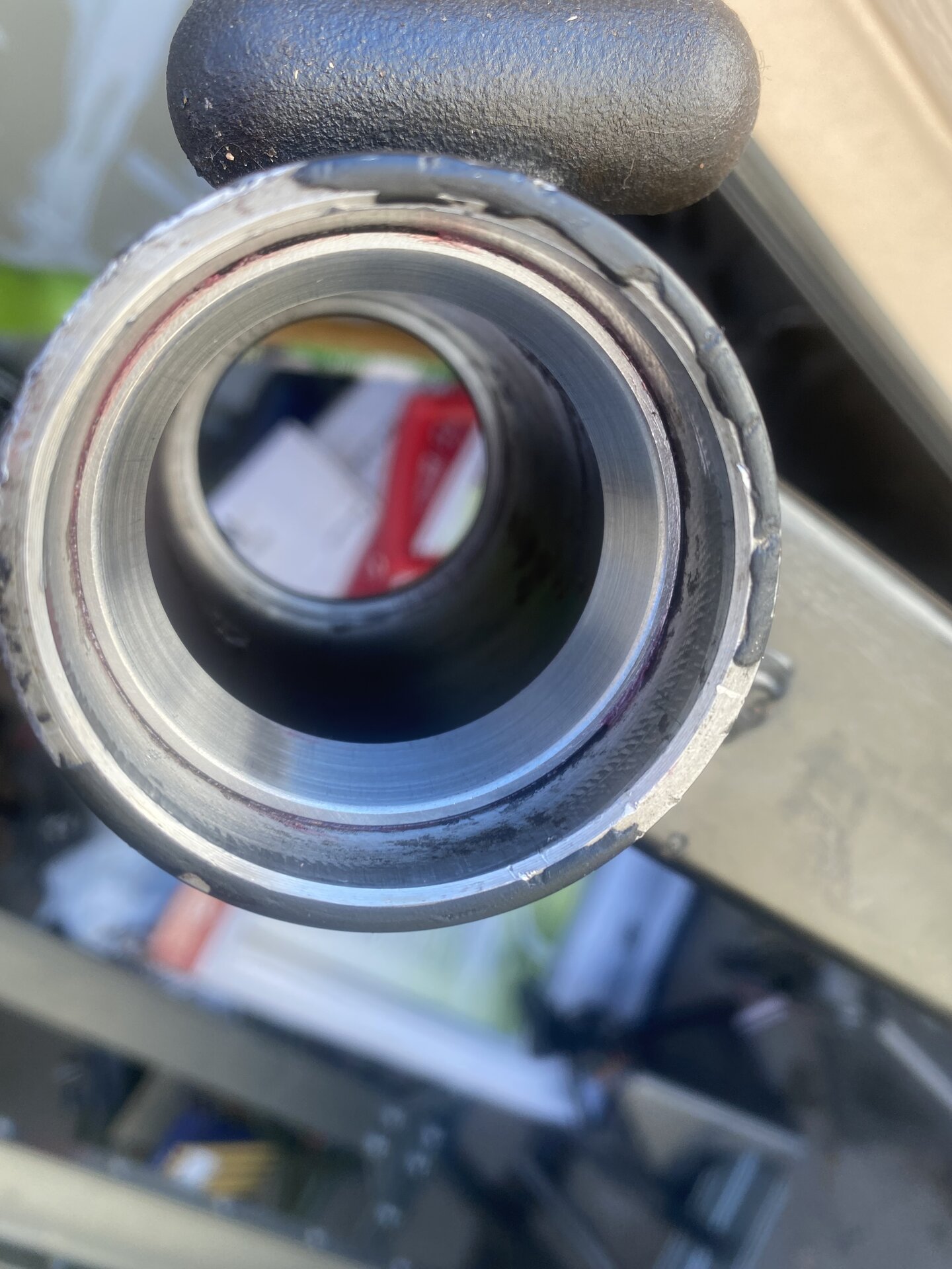

A quick call to Cruiser Outfitters and the two bearings and seals for each end of the Tcase were on their way. Two days later and they were at my house.
Separating the transfer case from the transmission wasn’t necessarily difficult, but getting it onto the ground was a bit of a process. I had borrowed a motorcycle jack from a work buddy but it wouldnt fit in the tight quarters. Using a HF jack and our cumulative strength, @GreenLandCruiser, another neighbor and I managed to wrestle the transfer case out of its tight little nook. Once it was out, the fun began.
Insta saw these first

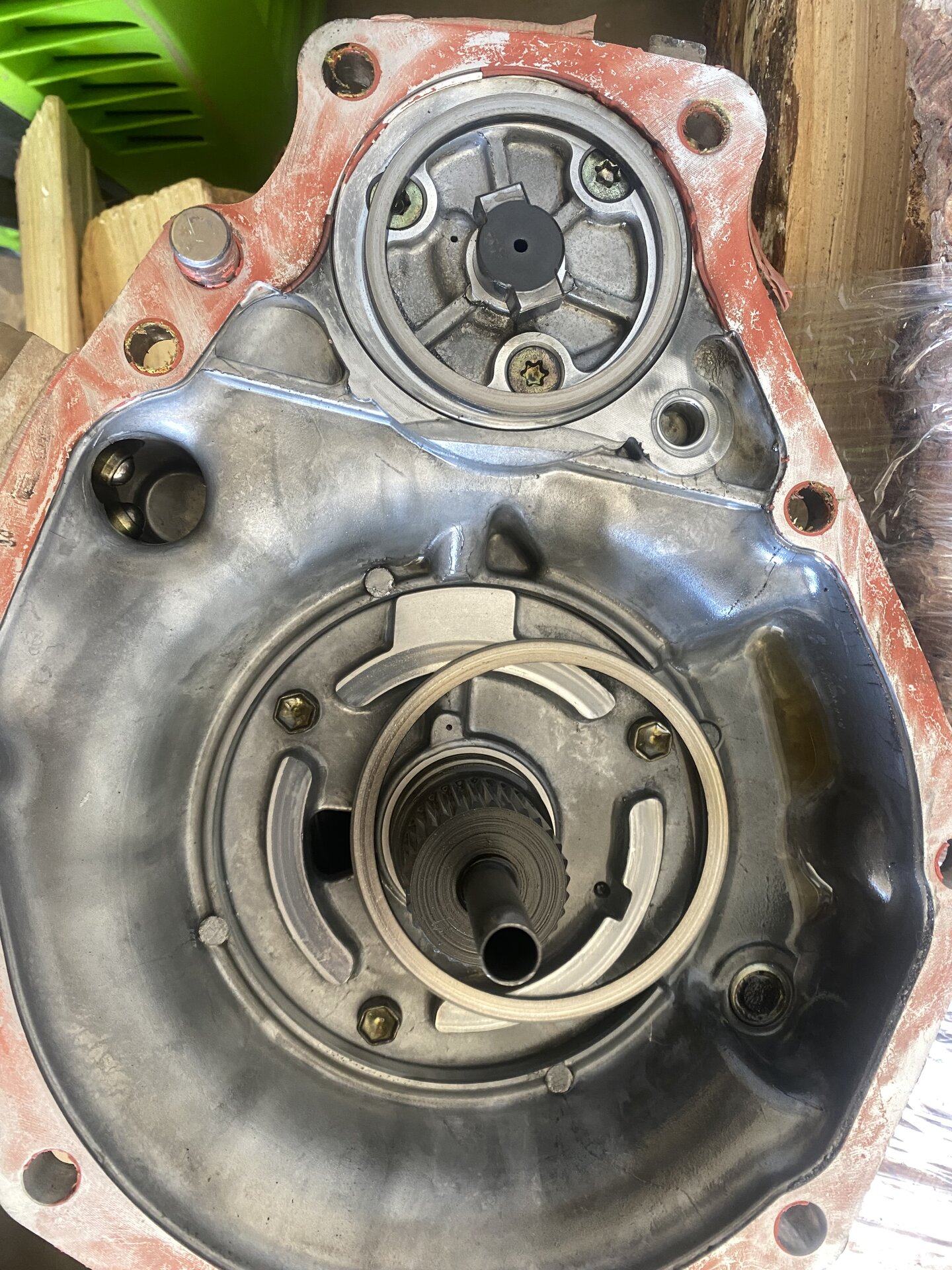

Pressing everything back together, praying my initial measurements were solid.
1/2 of success
At this point, I realized I needed to stop taking pictures and get this s*** done. Heres some shots of the back side. I was really impressed with the conditions of the internals. No metal chunks anywhere, no signs of oil change neglect.
The second night, Antoine, Adam, another neighbor Dash, and myself got her put back in. The install was mostly drama free, other than getting the case angled properly to seat on the dowel pins. We reinstalled the driveshafts, removed my wheel chocks (firewood), and started the old girl up.
She was all good.
Btw @Leroythe02LX ā€˜s youtube tutorial for the tcase was on repeat for a couple days. Highly recommend taking a peek at this if you’re diving into this job.
Transfer case reseal tutorial

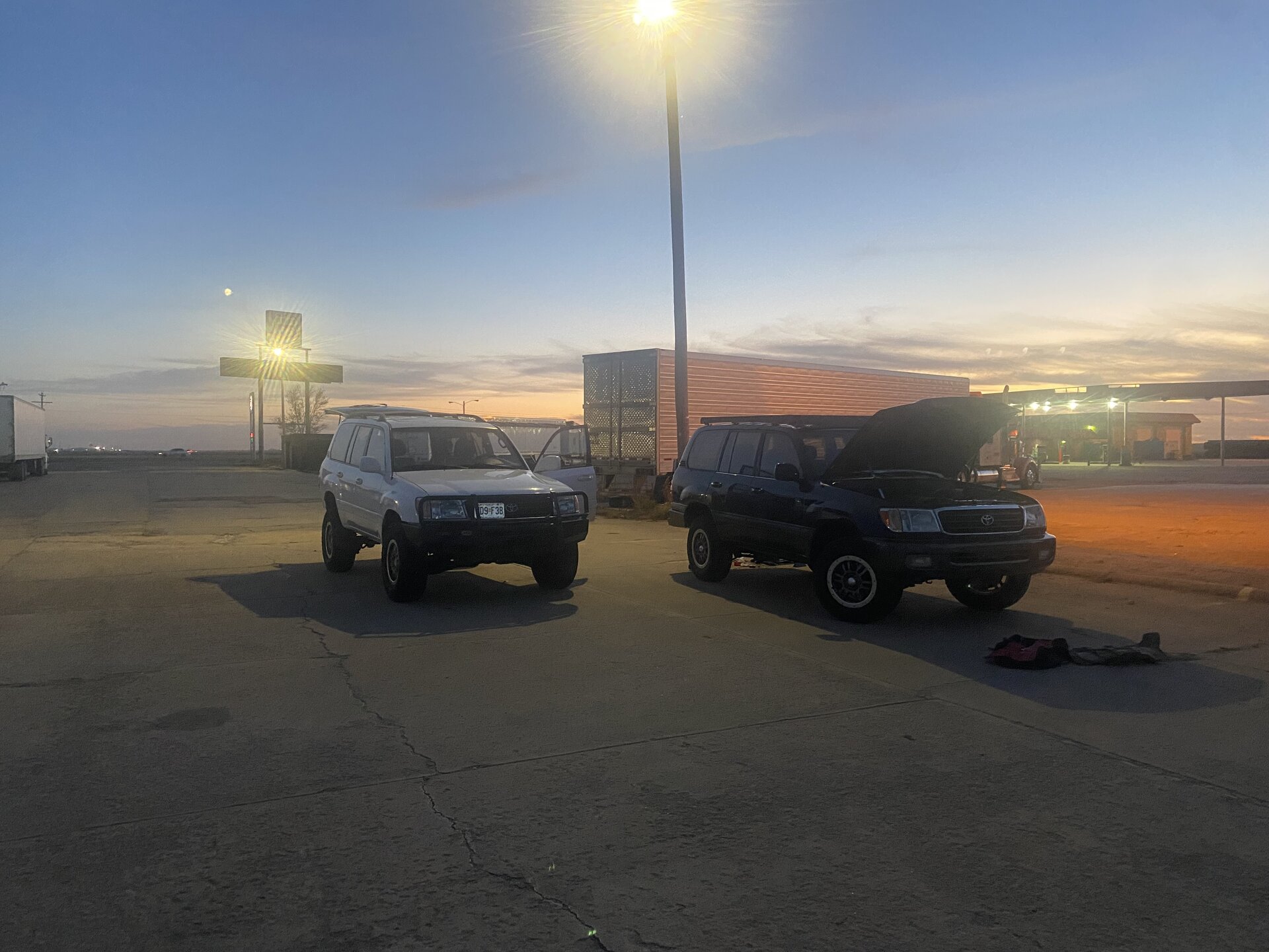

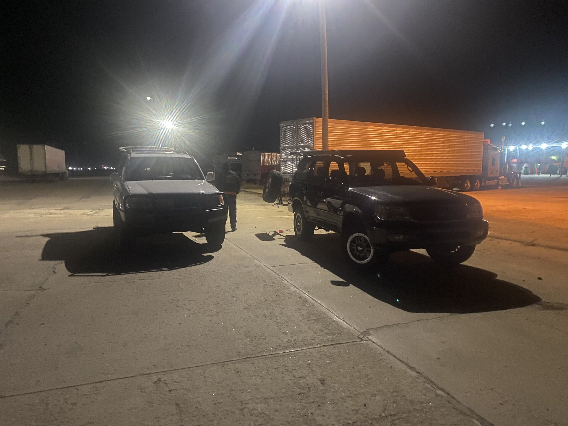

Remember when I said the Cruiser never let me down until it did? Well this is when 21 years and 358,000 miles of use/abuse started to show itself. About halfway to Kansas City, I look down at the dash to see the battery light on. f***!!! Not only was I in the middle of nowhere Kansas, but I had no idea how to change the alternator on this vehicle. I pulled off at the next exit looking for a gas station, only to find a marine repair shop. I pleaded with the receptionist to sell me a battery or hook me up with a charge from one of their vehicles. She looked at me, annoyed, and said no. šŸ˜‘ I continued begging her until she finally gave in and went to get the owner of the shop. The owner, who was an absolute gentleman, told me to pull around the side so he could hook up his battery charger. SCORE! While the battery charged, he called around to all three of the the local auto parts stores to see if anyone had an alternator for the 2UZ. Within 100 miles, one O’Reillys had the part. It wasnt OEM, but I really didn't care at that point. I’d have to drive about 25 minutes east to pick up the part without the battery dying on the way. I hopped back in the cruiser and headed down the interstate going way faster than anyone has any business going in a 100 series. Luckily, I made it to Salina, KS and set up shop in a truck stop parking lot.
I called Garret to let him know the situation, to which he replied, ā€œWant me to just pick you up an alternator in KC and bring that and the bumper to you? We can install them in the parking lot.ā€ ARE YOU FREAKING KIDDING ME?! So I sent him some more cash and began figuring out how the hell to get the alternator out. I didnt have much spare coolant, I opted to try to fish out the alternator without removing the lower coolant hose. What a bitch! After about 2 hours, the bad alternator was free!
At about 4p, the angel also known as Garret showed up, alternator, pigtail and wires in hand. He also had a beautiful chunk of steel to hang off the back of my rig. View attachment 3201626
We split up, I installed the new alternator while Garret installed the bumper. View attachment 3201628
By 8pm, the installs were complete. We were both exhausted and ready to get the hell out of that windy, cold truck stop parking lot. I thanked Garret endlessly and headed back to Colorado, proud to have successfully repaired the rig in less than ideal circumstances.
I will forever be thankful for Garret’s generosity and kindness in this situation. He is a genuinely decent human being in a world full of dickheads šŸ˜‚ He is also a great business owner to deal with, so if youre looking for a custom bumper or sliders, I will always recommend people to reach out to him

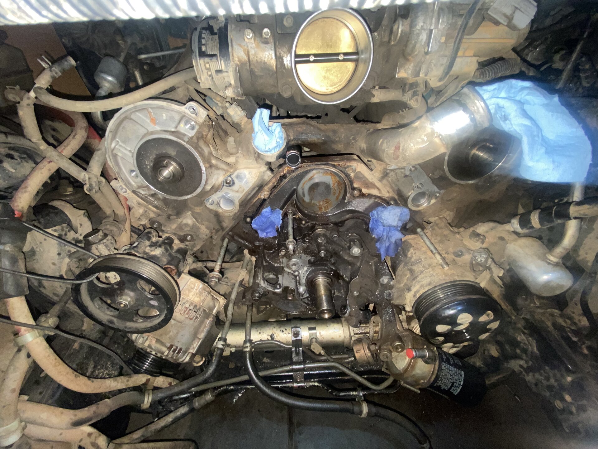

Continuing on the quest to eliminate the failing pulley bearing sounds, I decided it was time to take on the timing belt job. I didnt suspect any of the associated TB pulleys to be bad, but instead the fan clutch bracket. Obviously this is most of the way into a TB job so I’d do some while you’re in there work. The TB/WP kit was ordered from Cruiser Outfitters, with the bonus being cam seals and a crank seal. A new fan clutch, fan clutch bracket, thermostat & gasket were ordered from Rock Auto. I also called up Bob from Stevinson Toyota in Aurora and got a pretty good deal on an OEM radiator as well.
I also had noticed a while back that the metal engine oil cooler hose that runs down to the filter wasn't properly attached to the driver side cam cover as it should be. There is a stud that bolts into the head that is supposed to protrude out of the cam cover, and the oil cooler slips over the end. Well mine was just kinda hanging out, rubbing on the serpentine belt lightly. I ordered one stud for each head and the nut for each. More on that later.

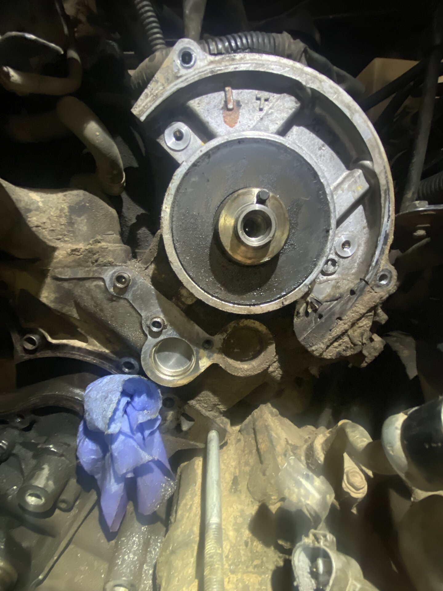

Day 1: tear down! The Otramm videos are great for this. Both the original and updated version were on repeat for a few weeks. Everything came off easily, thank the lord. Removing the radiator made things ALOT easier. Also, no need to loosen the rear AC compressor bolt, just bend the harness bracket to remove the fan clutch bracket. Here’s where she sat at the end of the day-

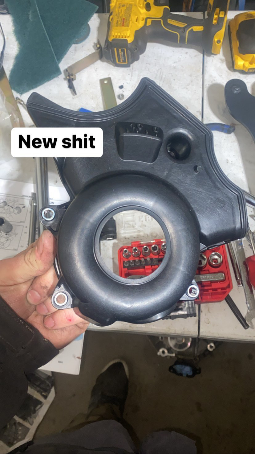

With everything removed, time to assess the carnage. Both cam seals were leaking, crank seal was leaking, the mouse door was just plain gone, and the lower timing cover had two wholes drilled in it (wtf). PLUS, that stud in the driver head had been snapped off and left for the the next guy (me) to deal with. Fml
I ordered a lower timing cover and mouse door at Stevinson and grabbed my EZout set to get to work on my broken stud. I had plenty of practice extracting bolts/screws that I mangled in my previous work as an aircraft mechanic. 3 hours later, the stud was not out. In the end, I had to drill out as much of the stud as I could and run a tap into the head to fix the threads. That was as good as it was going to get. The problem was, when I threaded in the replacement stud, it was sticking out too far to sit flush against the cam sensor. So, I grabbed the angle grinder/flap wheel and shortener her up! Good as new. There would only be about 4 threads of engagement into the head, so some loctite would assist. However, the stud is also kept in place by the dowel on the head, and is held by a nut on either side of the cam cover. Heres a shot of the head after the battle
After that, it was time to wait for parts and hope that the job could be finished the following Wednesday.

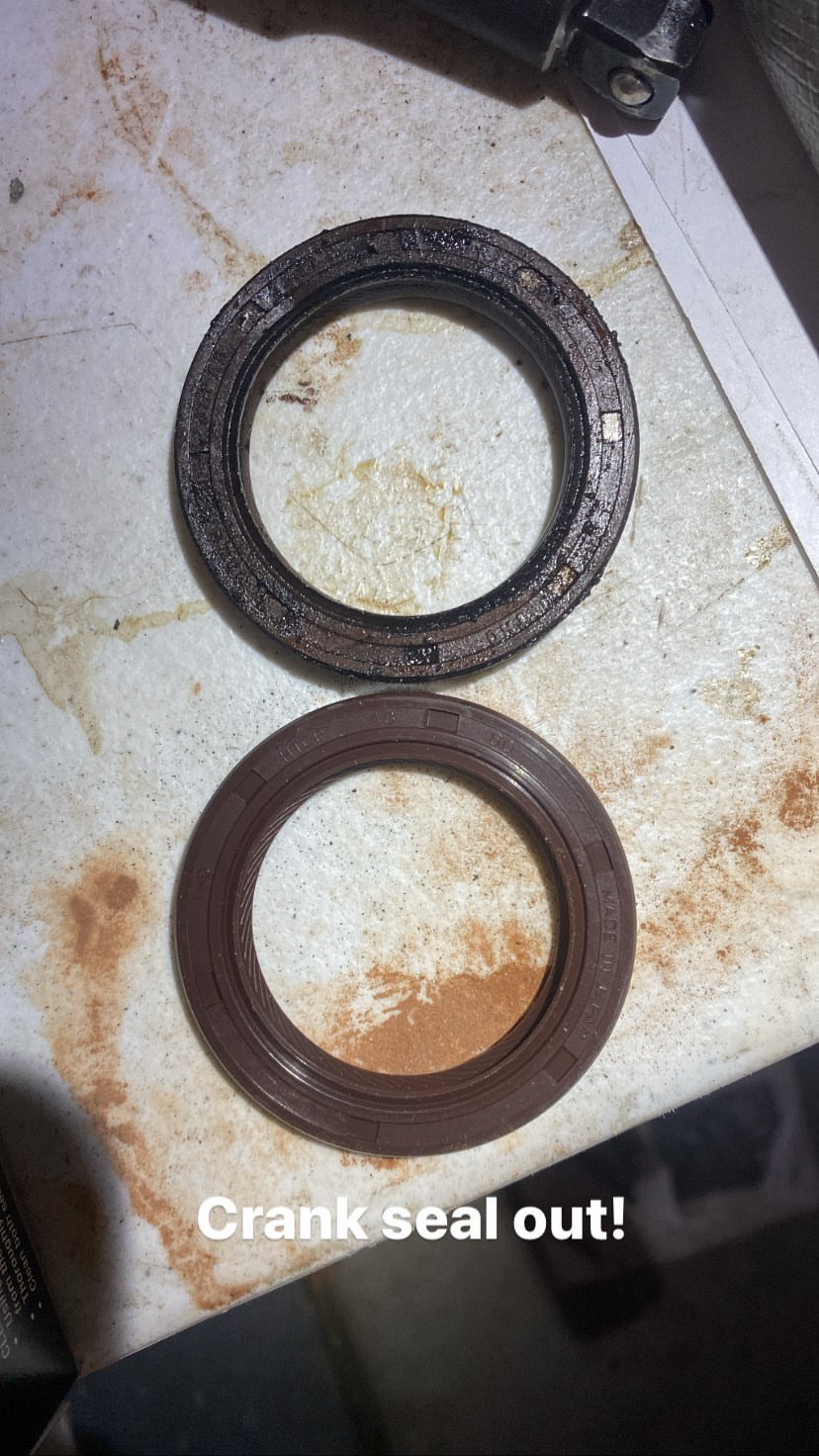

Day 2 of the TB job started with the cam & crank seals. The cams didnt look OEM but the crank did. Either way, I drilled a hole in each, inserted a wood screw and pried the old seals out.
Next, it was time to clean up all the dirt and oil residue that was caked onto the front side of the motor. This was probably the most time consuming part of the job. Once that was done, it was time for reassembly. Look at how nice that new cover looks. Too had itll never be that nice again
Reassembly went smoothly, with no issues whatsoever. Otramms video was very helpful here too, saving alot of time looking up torque specs. When I finished, I added a little bit of bling to the cruiser.

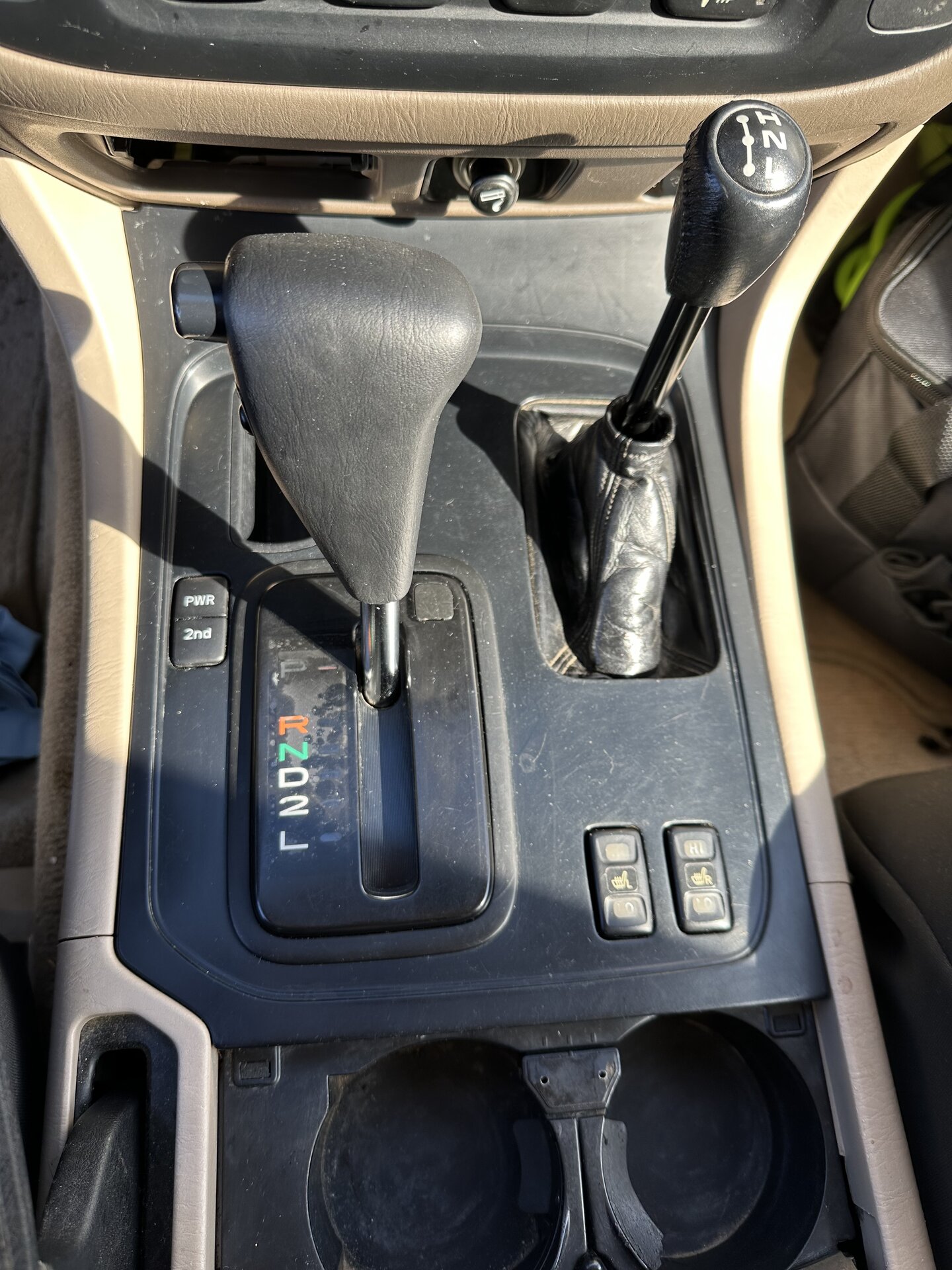

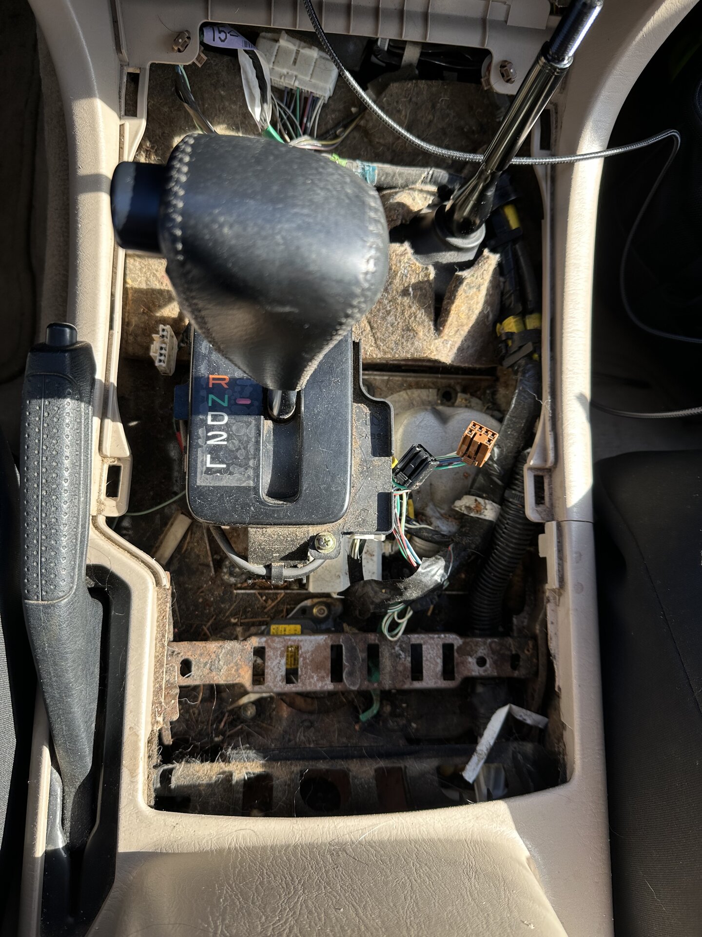

Finally, I decided that it was time to swap out the transmission shifter. The original leather wasnt damaged, just old and not quite soft anymore. So I decided to drop in a vinyl covered replacement from an 80 series. It feels great in the hands and wasn't a very difficult job. Now I need to decide if I want to swap in the matching rubber transfer case shift knob. As much as I would love to have a poverty pack 100, its just not in the cards. I've been trying to source a set of cloth seats to swap in with no luck so far. Hoping that I can snag a set from LandCruiserheaven or another importer.
Chefs kiss šŸ¤ŒšŸ¼
