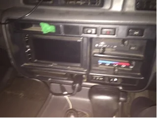

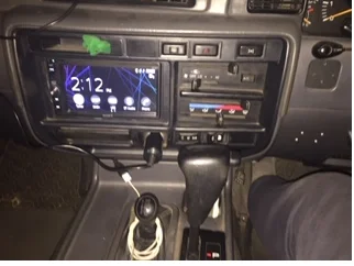

I have the below one (Sony xav-ax205db) in my 80 series and it fills the double din space perfectly just like the original double din radio, 200w, runs 3 cameras, apple car play, DAB+, CD / DVD player, SUB etc....

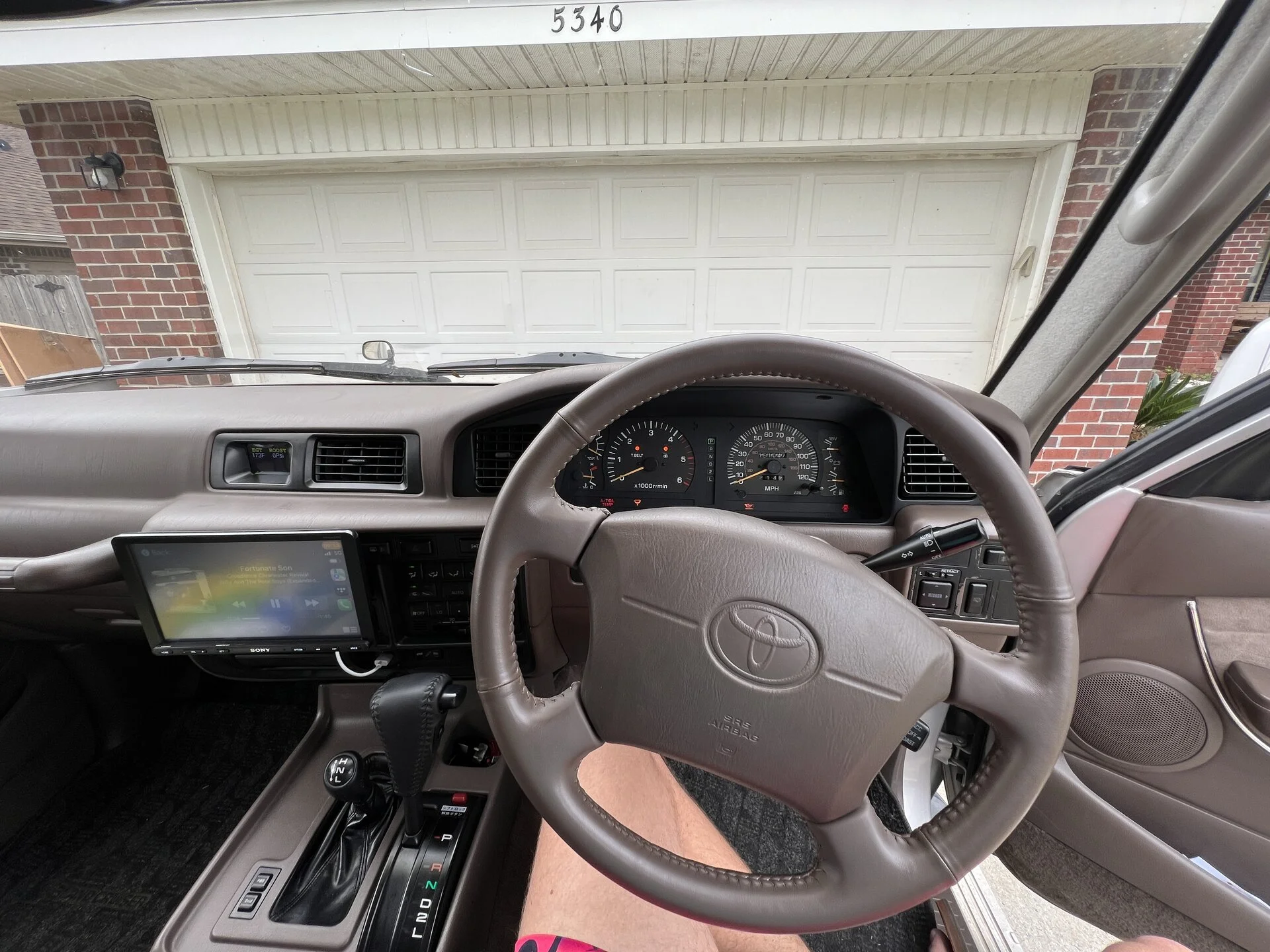

Sony XAV-AX8000 and BOYO VISION VTK601HD in the rear bumper, that's what I have. I have had that Sony head unit since 2020 and this is the 3rd car it has been in. Its a single din and only one video input but you could get an input camera switch for multiple inputs.
