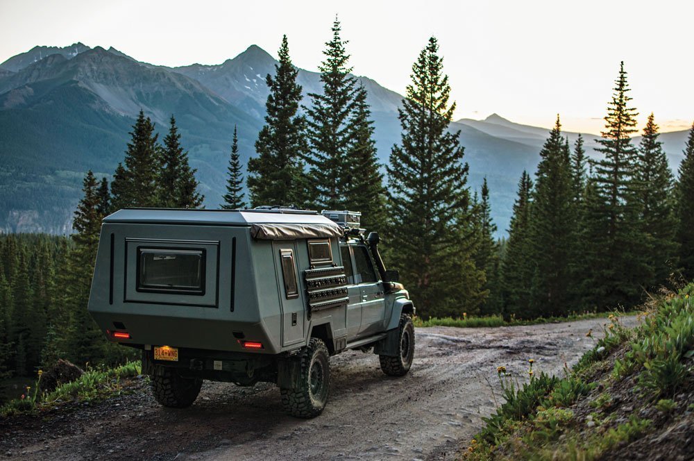

Does anyone have any suggestions on how to cut the back of the cabin of a 79 double cab and build a camper box , and tie in with the cabin?
Attached is the back of the 79 double cab, and my idea is to keep the back completely open into the box, basically build some sort of troop carrier out of a double cab. (but a 4 door, 4 seat).
On another picture, the camper box is shown, but as always, the camper is separate from the cabin, I want to open it up and have one open space
I have no idea of how to tie the box to the cabin, and make it removable. and how to make it in a way that would avoid noises and leaks.
If we can install a gasket between the 2 parts and put bolts and nuts every x inches .
Thanks in advance
maltec-land-cruiser-70-series-diesel-conversion-overland-camper-tent-bugout-vehicle-truck-3.webp

The Maltec build you pictured is actually open to the cab. More detailed photos here.
-Rob
Oh , I didnt know.
Unfortunately is not possible to figure out how they made it.
anyway, I have seen a few cases where they intalled an accordion rubber gasket, that might be the most safe bet without having to get a degree in engineering. :)
