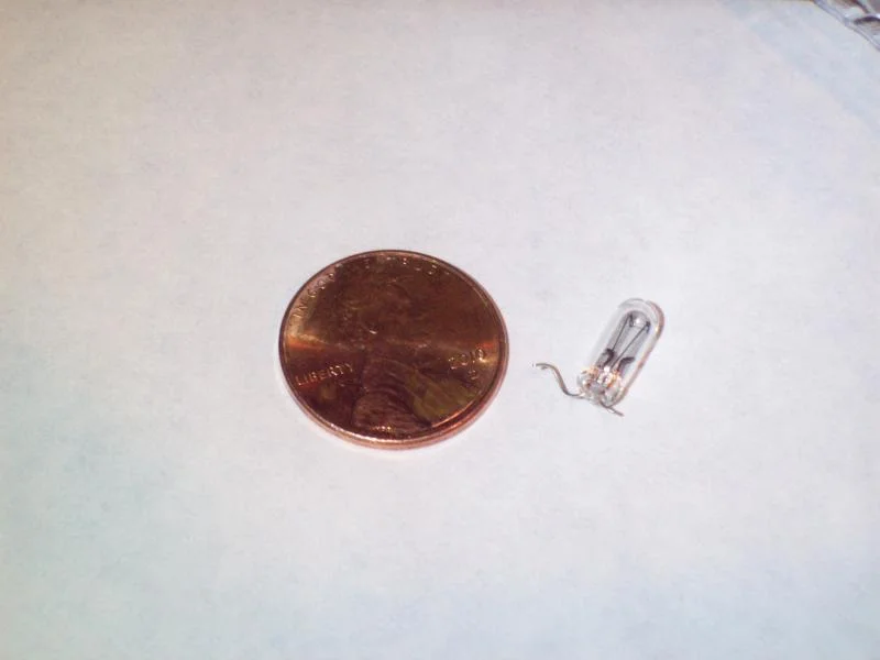

Two wiring options with these chimes; transformer or 2 9v batteries. this one was set up with the later.
Makes sense..
Spike, thanks..
Little minor surgery, cut it's heart out.:cool:
