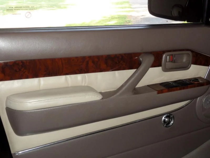

I'm sure this question has been answered before, but I didn't have any luck with my search terms. The LX comes with nice wood trim on their door panels (see pic below). Can that be swapped into our LC door panels relatively easily? Or is it an involved custom job?
And if it can be done, is the trim still available from Lexus?

You have to cut holes in the LC panels for the wood trim to work. It isn't a very difficult job just takes a while. I got used panels from a wrecked rig and put them in my LC
Search for Romer's leather seat thread. It shows some detail about how the woodgrain mounts to the panels.

ERG80, thanks for the help. I found the thread: https://forum.ih8mud.com/80-series-tech/217863-installation-replacement-leather.html and it has pics of it =-)
Steve, it looks like it should fit. Why do I want it? Because my wood grain (my interior as a whole honestly) is in almost mint condition. And even if it wasn't, with new Lexus wood grain inserts, I could easily match & replace all the rest of the wood trim with a new set. I think it makes the interior look a heck of a lot nicer. Very classy IMO. But like you said, to each his own.
