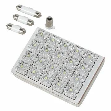

.....after you replace it go with the LED wafers, they are awesome. The great thing about LED's is they are bright as heck and you could leave it on for weeks and not kill the battery.

Where do you get the wafers?
I have previously bought some online but the last two sets I purchased I bought from Autozone as well. The ones I bought were 20 LED wafers and were $19.99 each. Might seem pricey at first but two years later they are as bright as ever and I never worry about leaving a door open or one of my family leaving a dome light switched on. The advantage of buying from Autozone for me was no shipping and the store near me is awesome about returns. If you care about your night vision I would consider going red in front and white in back or all red. You can still see very well with red and your eyes will not need to adjust near as long as when using white.

I am curious why one would chose a 6 LED bulb style LED over a 20 LED wafer. I mean these 20 LED wafers turn night to day, the installation is simple, are the bulb style LED's superior in some way.
