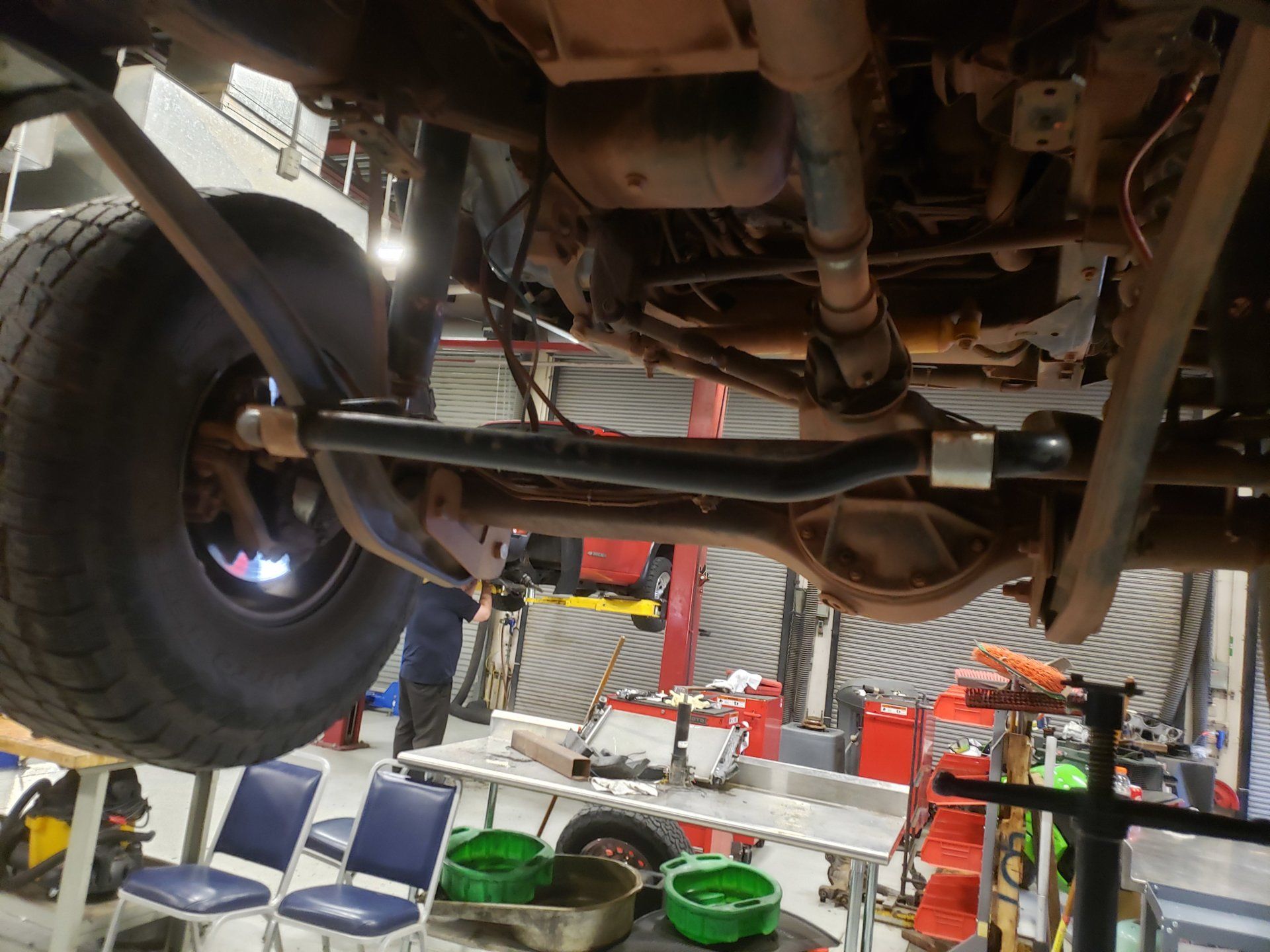

I got more data points from swapping out the Slee 4" heavies with Dobinson 3" heavies. The rear axle requires the twisting as I mentioned above. However, the front doesn't require the twisting method. Once you disconnect the sway bar from the frame (as oppose to disconnecting from the axle) and undo the bottom shock nuts, the front axle will drop like crazy. BUT, be mindful of stretching the front brake line. I have extended lines so this was a non issue for me. Axle will drop down enough to have the front springs literally fall out!
I found it easier to disconnect/reconnect the sway bar from the frame mounting than dealing with the axle end mounting. At the axle end, you have to line up the sway bar end and the space is tight. It just requires more fiddling than disconnecting/reconnecting at the frame mounting location.
See the pics below.
