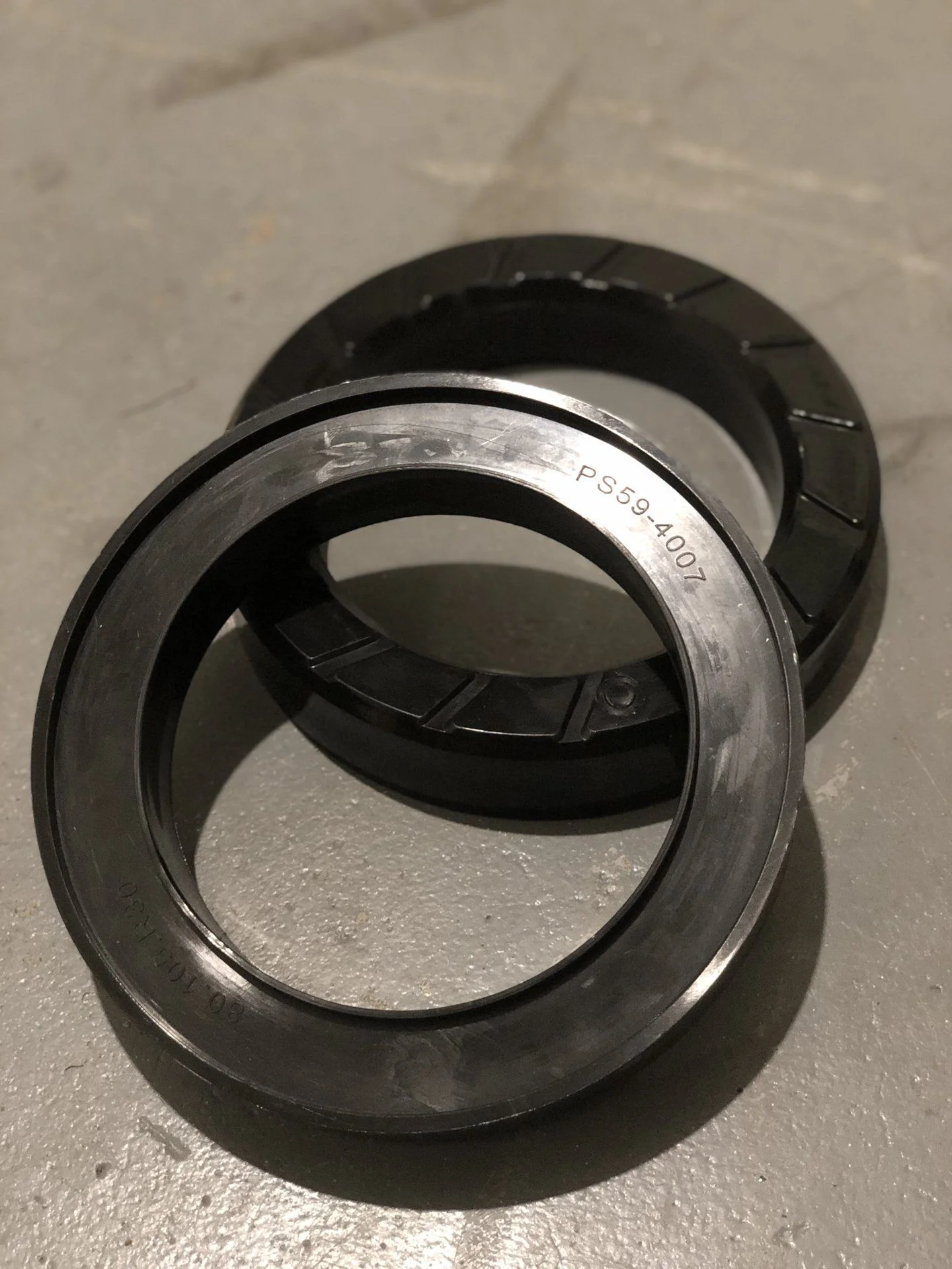

After I installed new stock springs, I found that my rear pressure was running about 7. To bring the pressure down I decided to install 30mm spacers.
Well, Slee was out of rear spacers for my LX so I looked at Ironman and Dobinsons.
Ironman spacers looked exactly the same as the Dobinsons but the Ironman, besides being green, said that they fit 80/100/Lx450/Lx470. Dobinsons said only 80/105.
Since they looked like the same casting which the Ironman site said would fit the LX470 ----and the fact that Dobinsons was only $50 a pair, I bought the Dobinsons.
Well as my luck will have it, the ID of the Dobinsons was about .150" smaller than the OD of the spring tower that they had to mount on. No way could I force them onto the towers.
I figured that they had to fit (hey Dobinsons) so I tried heating them up using my heat gun and finally a bucket of boiling water to expand them. No Joy.
So I turned the ID down just enough so that I had to push them on with a good amount of pressure. Happy I have a lathe.
Anyone else run into this? Are the 80 and 105 spring towers smaller in diameter than the 100 series?

The picture you posted looks different than the picture on Dobinsons website.
I know- thus my confusion. I have seen both styles on different websites which sell Dobinsons- all saying that they are for the rear springs. The trouble is most of the photos of the spacers installed are often generic and show some other truck.
The part number should be on the spacer, as such...
Dobinsons 30mm Spacer ps59-4007

They seem to be doing the job so I am not going back in even if they are the wrong spacers.
After I turned the ID's down I hand pressed them up onto the towers and they seated well. Brought my rear pressure down from 7 to 6.2 MPa. Rear raised up by about .500". Height sensors are averaging close to 0 after 3-4 cycles.
Arrrgghhh.... I got bit by this today! And with the Ironman spacers! And it appears to be the same issue you had @MarkTR. Just like you mention, Ironman says these fit an LX470, but it is not true. The ID is too tight.
Stock appears to be around 134mm ID and the Ironman's are 132mm. Sounds like a small amount, but it is indeed enough to keep it from sitting flush at the top of the spring perch. Unfortunately I don't have a Lathe, so now I'm trying to figure out next steps. Maybe I can find a shop that will turn these down for me.
