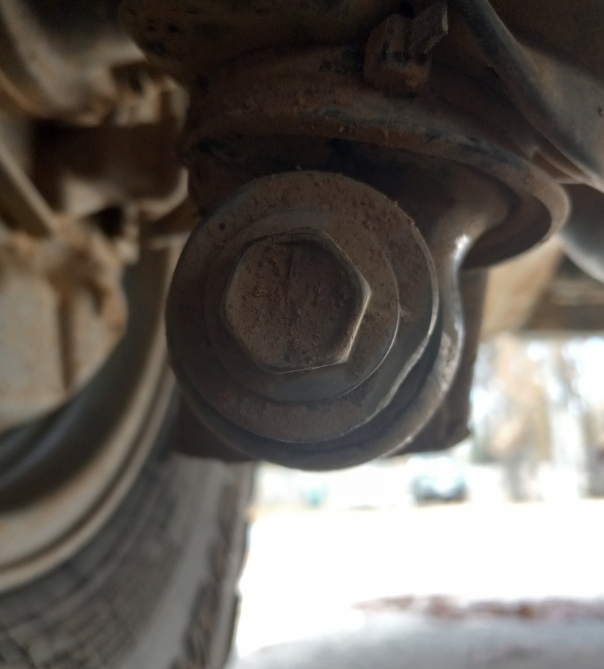

...So for the lack of 1 (one!!!) upper mount bushing washer and one lower mount bolt, the truck is on stands until tomorrow...
I actually just installed the shocks with the hardware they came with, so only the bottom bushing bottom washer and top bushing top washer. Went to double check the install instructions and they don't say anything about adding extra washers.

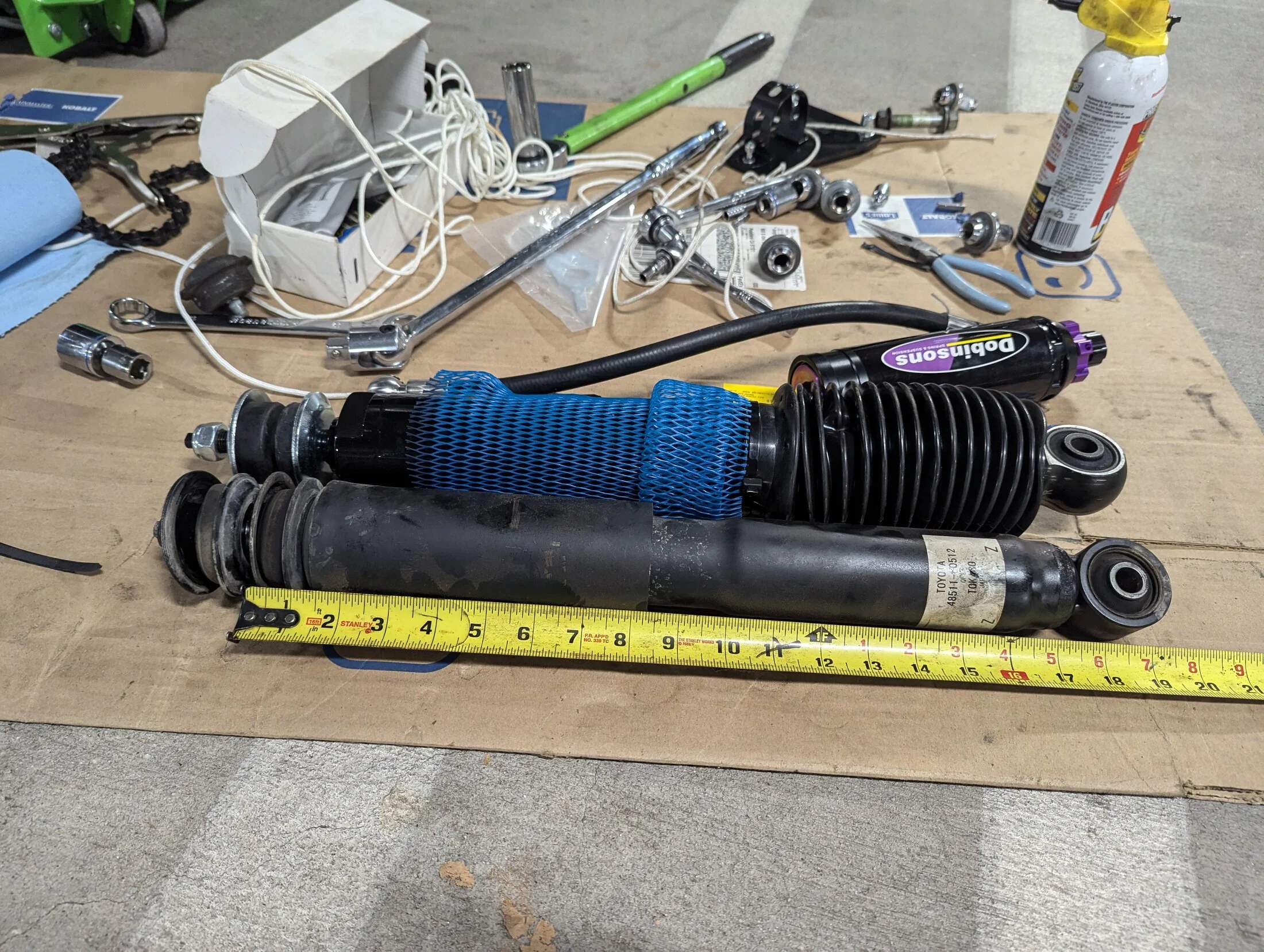

Pic of factory and MRA shocks side by side:

Pic of factory and MRA shocks side by side:View attachment 3797044
Iirc, I called the vendor to confirm bushing/ washer orientation. If there was a washer on both sides of the original bushings, IMO, there should be on these as well.

Damn, that's annoying. Wish the 100-specific instructions would've mentioned that. Might have to go back and redo my install then 😒
The shocks have 2 lipped bushings that meet in the frame mount without locating washers.
Sweet! Thanks for the info. I figured there must've been a reason I didn't include the factory washers. When I was installing. Was dreading having to go back down there before my trip tomorrow. I'll post my feedback and settings after the weekend. Cheers 🤙
