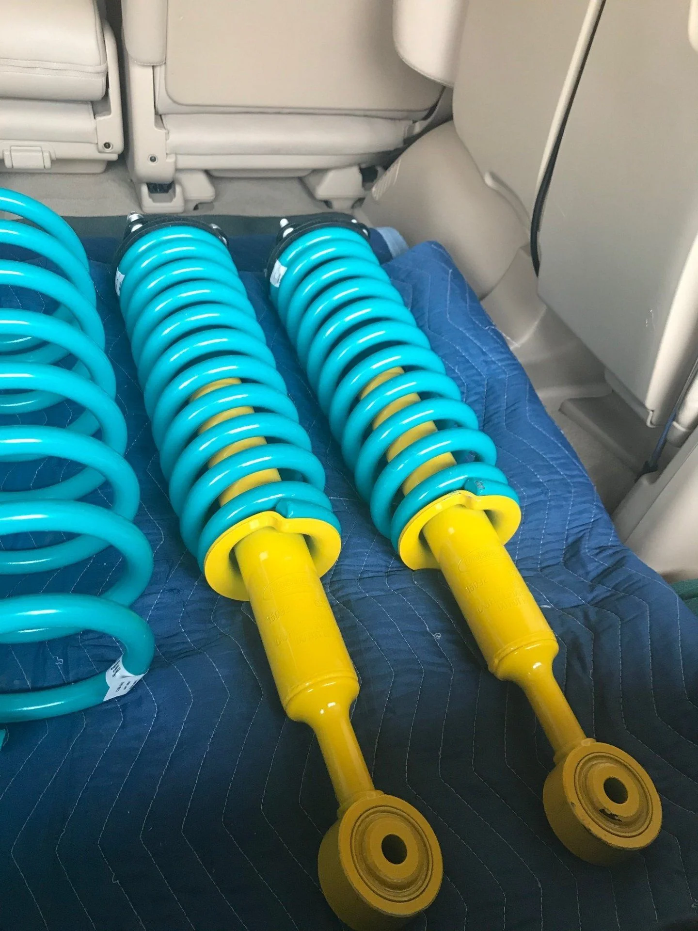

Installed Dobinsons IMS with C59-540 coils in front and Tough Dog 20 mm coils in back last week. Waiting on things to settle before I take new measurements. So far so good, no trail use yet.

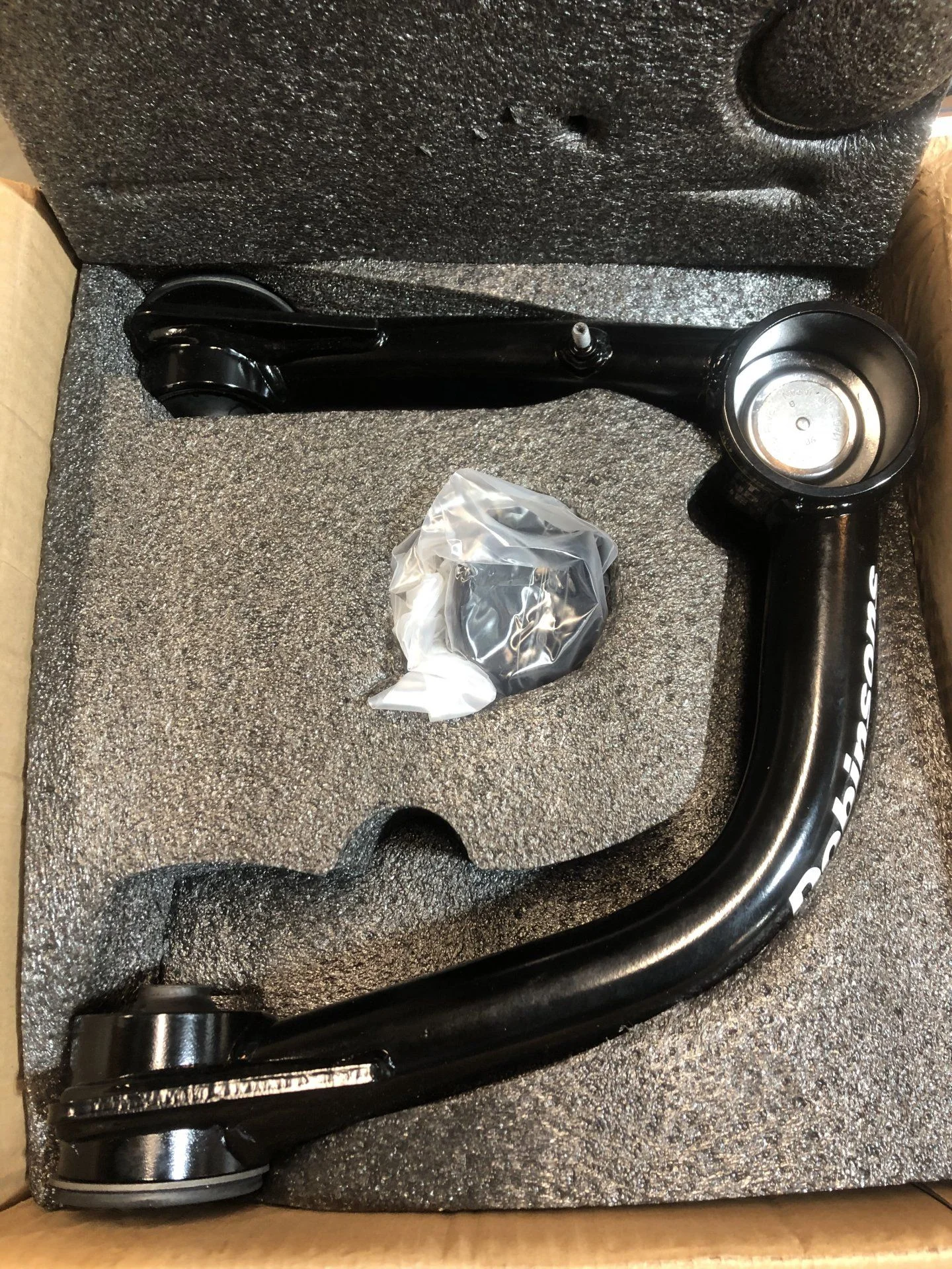

I can only comment on the Dobinsons UCAs. I have them, and like them a lot. They are very well made, good quality workmanship, fit and finish. They come very well packed in custom cutout foam lined boxes, and arrived undamaged. I opted to have them pressed in by the vendor, since I don't have a hydraulic press anymore. i got mine through member @crikeymike at Exit Offroad out of Florida. They allowed me to get my alignment dialed in perfectly with my lift (mild King 2.5 setup). I like that they have OEM style rubber bushings and replaceable OEM style triple 5 made in Japan ball joints, rather than urethane and other styles of ball joints less suited to durability in my driving conditions. I would highly recommend them. Maybe drop Mike a PM or give him a call to see if he can connect you with other folks that have run the Dobinsons 200 suspension?

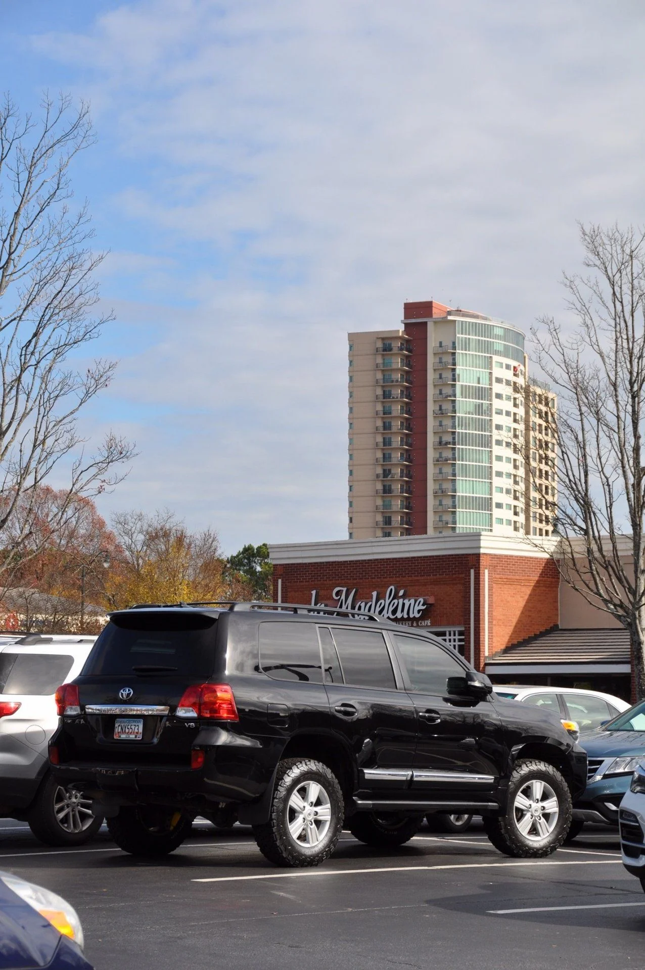

I can snap some pictures later, preferably after I clean it up some. It snowed in Oklahoma and my black cruiser now looks grey.
