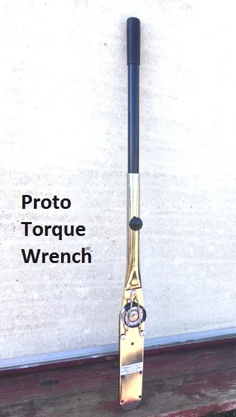

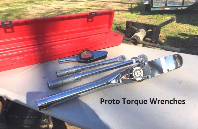

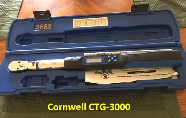

My CTG-3000 digital is 2% =/- and my Proto's are all 3% (clockwise) and calibrated....but that level of accuracy isn't normally needed for general automotive repair.
You can end up investing a fair amount of money in your torque wrenches.....so take good care of them and they will last.
