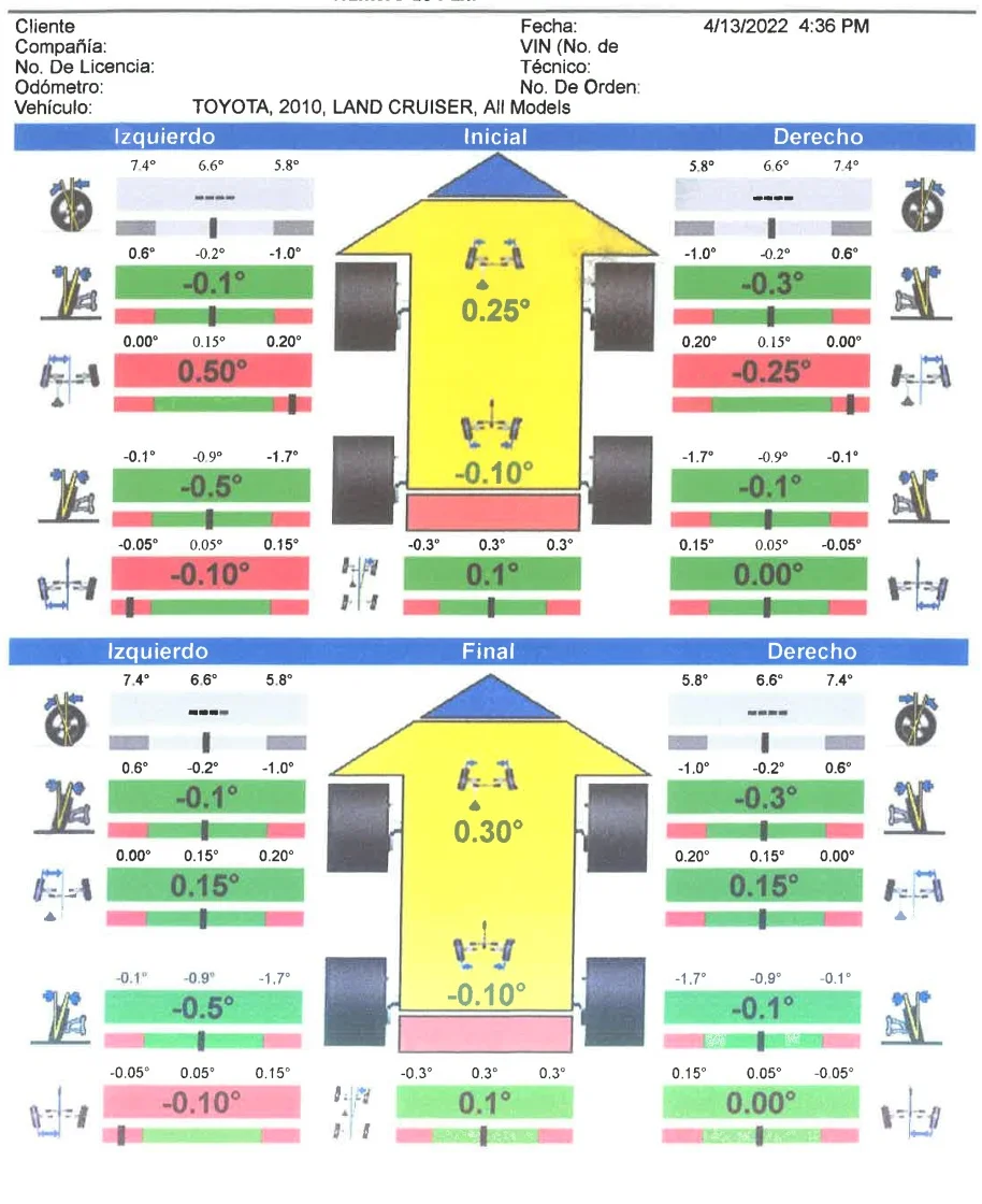

Fitted some 305/55 r20 Falken Wildpeak AT3W´s some days ago. Lift is OME 2" front.
The truck needs new UCA to get caster back into spec. Question is will I need to correct camber too?
Leaning towards the Nitro Gear UCA´s with 3º of additional caster or the SPC UCA´s with Camber +/-2.0° Caster -1.0° to +3.0°.

Not sure those printouts are showing caster measurements?

The first line of the print out shows the caster @ -0.2º per side.

Ah, couldn't tell if that's a reading as it's so low.
