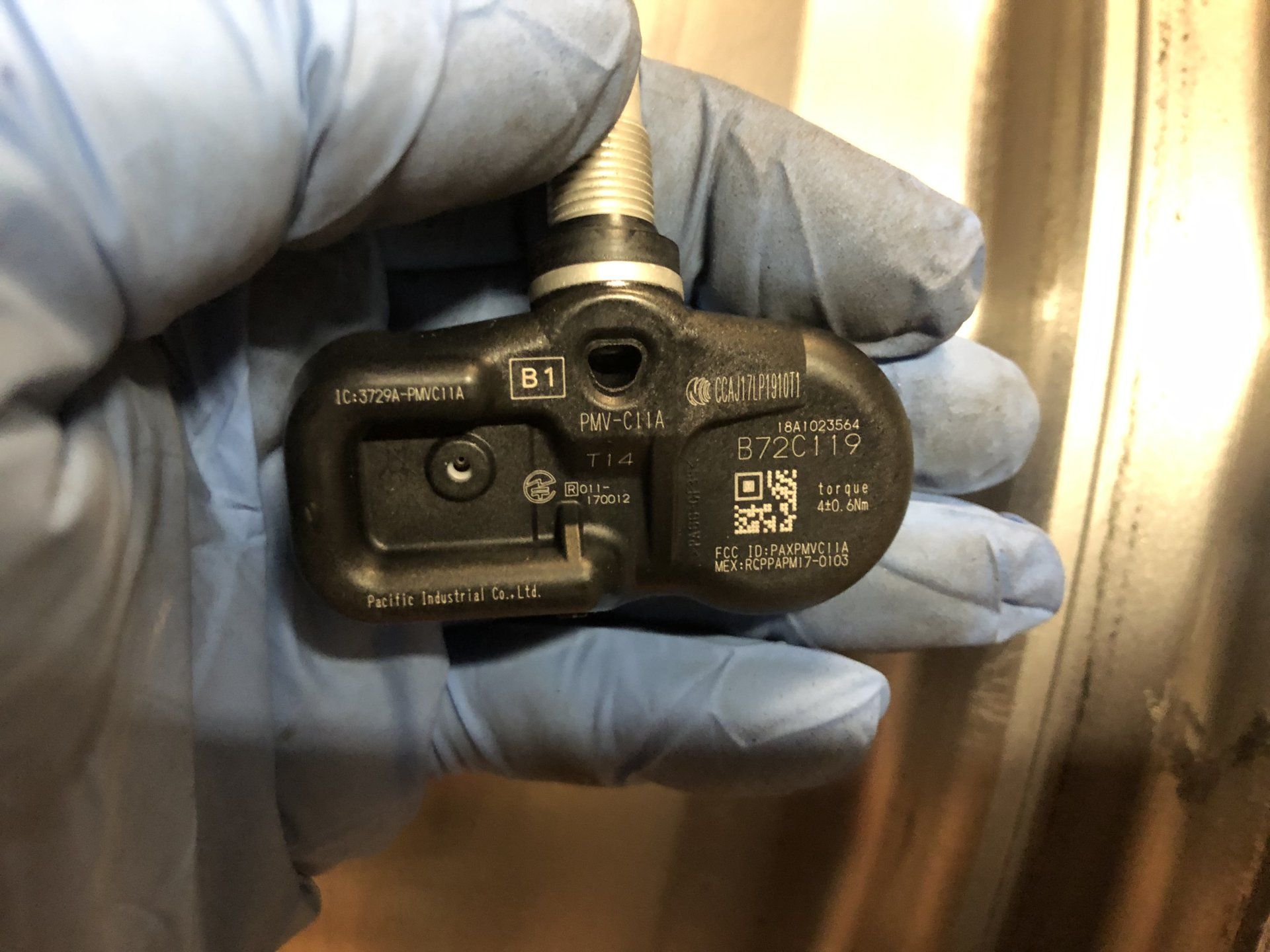

Hate to drag up an old thread, but this is literally the exact situation I'm in and I know @bloc is an active member. My only new/different info is that I ordered 4 Denso 550-0103 (marked PMV-C11A) from eBay and a 5th from Amazon. The one from Amazon had, for lack of a better phrase, nicer packaging, even though technically everything was the same, the Amazon Denso sensor packaging seemed sturdier. Either way, had my tire shop install all 5 tires and sensors to a set of 5 RWs. Cut to 3 weeks later after I've finished repainting the RWs I go to install and only the Amazon sensor gets picked up by the truck. I used Carista to program the sensors through OBDII. Techstream verifies the changes as well (I need to order a VxDiag, since my version of cable wouldn't program TPMS).
Did you ever figure anything else out about what got the sensors working? I've now put a few miles on them and the TPMS light did not clear, but i haven't checked Techstream to see what's not working again. I'm assuming it's still going to show 4 sensors not connected.
Barring any revelations from this thread I'm going to take them back up to the tire store, the owner told me he'd program them for me if I didn't get it worked out.

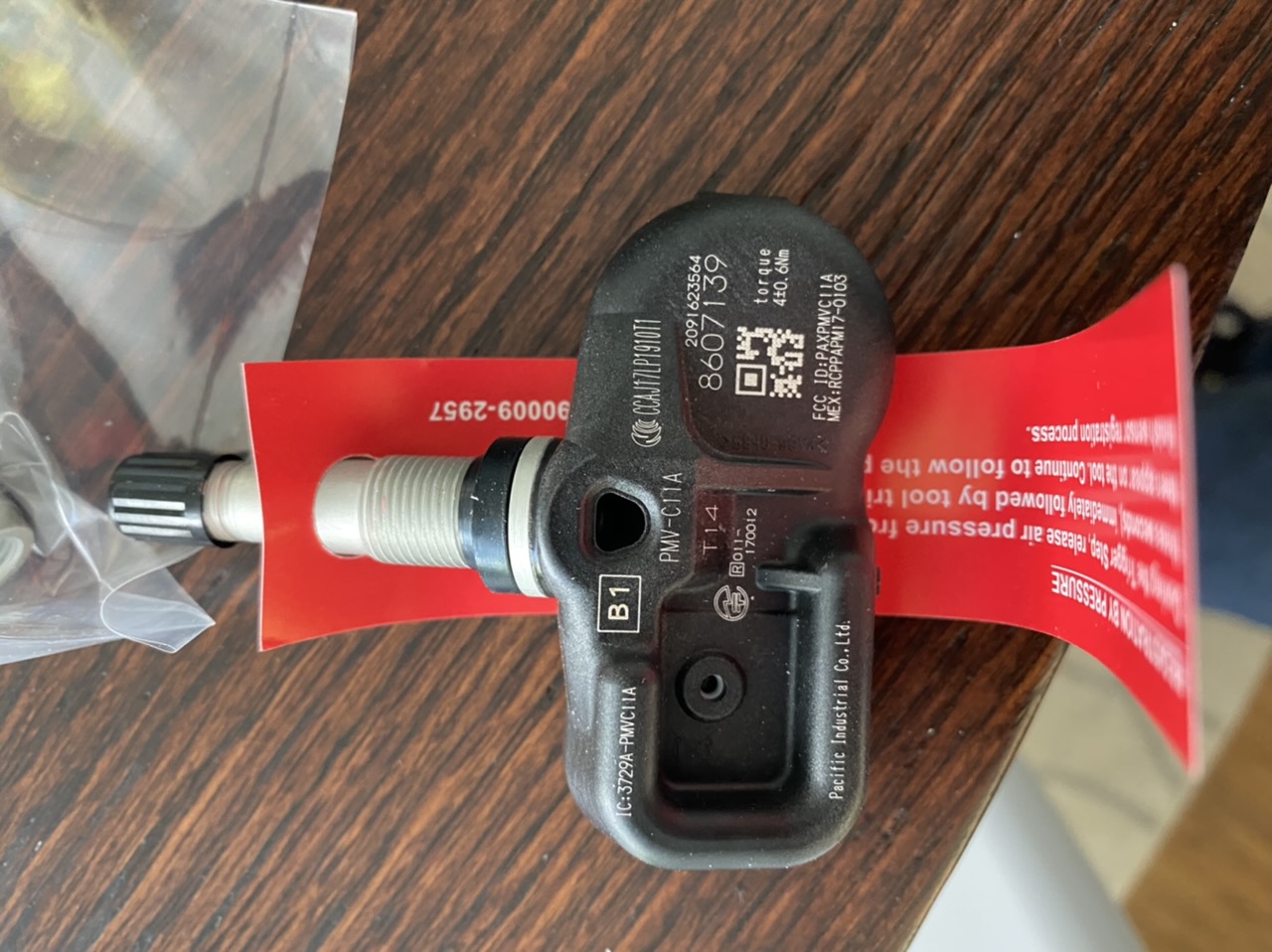

Hmm.. well.. I have tried a cycle of drop and raise twice now and on two wheels/sensors, but haven’t tried raising -> lowering -> raising them. I’ve read both lowering 6 psi in 30 sec and 20 psi in 30 seconds. Pushing the valve lever on the valve stem will not release 20 psi in 30 seconds.. 6 psi is borderline. Do I need to get a valve stem remover to relieve air fast enough to set off the sensors?
I also am not totally convinced my eBay sensors aren’t fake.
4 eBay sensors
Vs Amazon sensor. The markings all
Match, but the markings are much more vivid on the Amazon sensor that started up like a champ.
I would be wary of fakes. And yes to the core remover.. super useful for off-road travel. I’m not familiar with the specifics of rate of drop, though.
