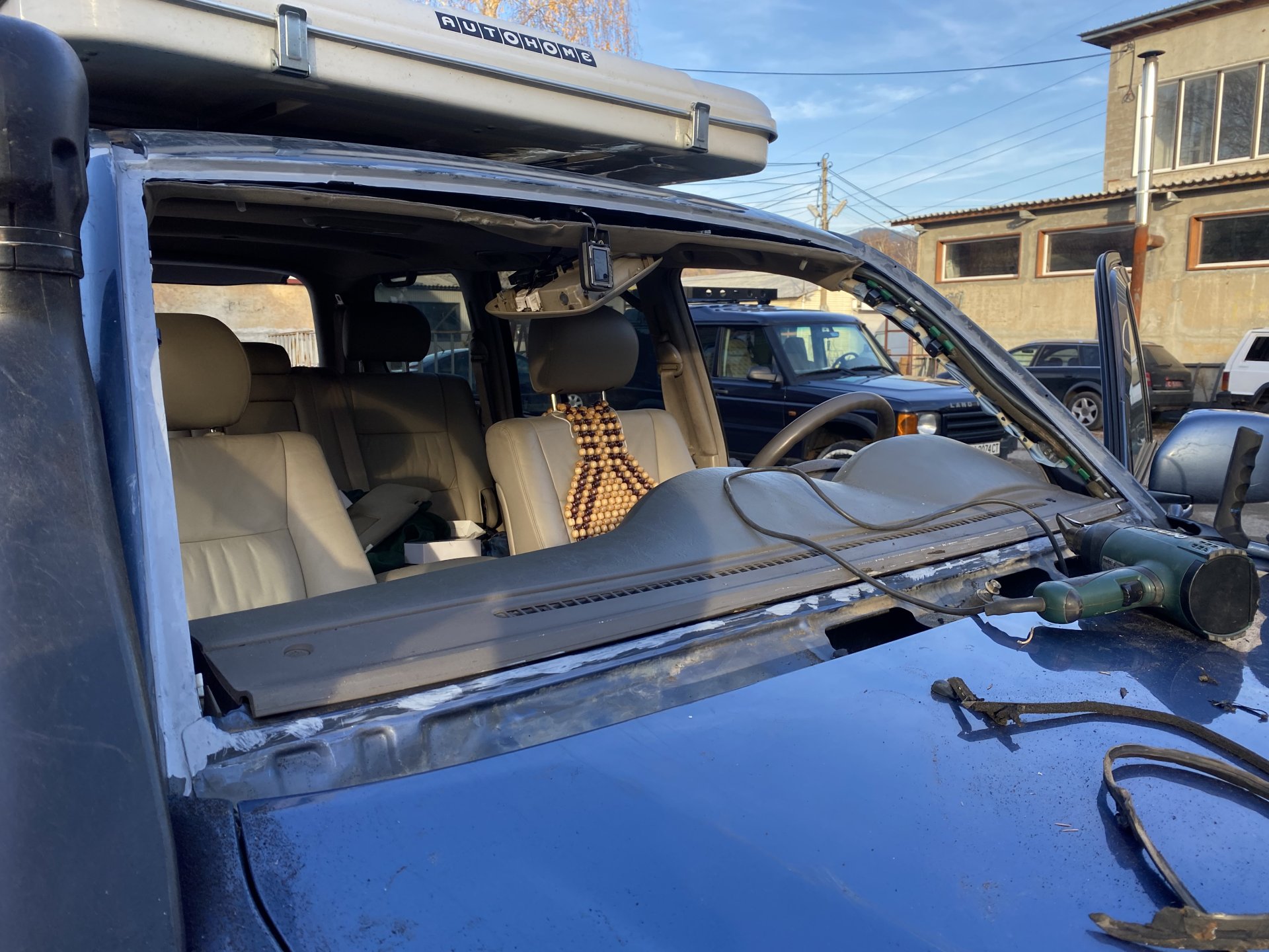

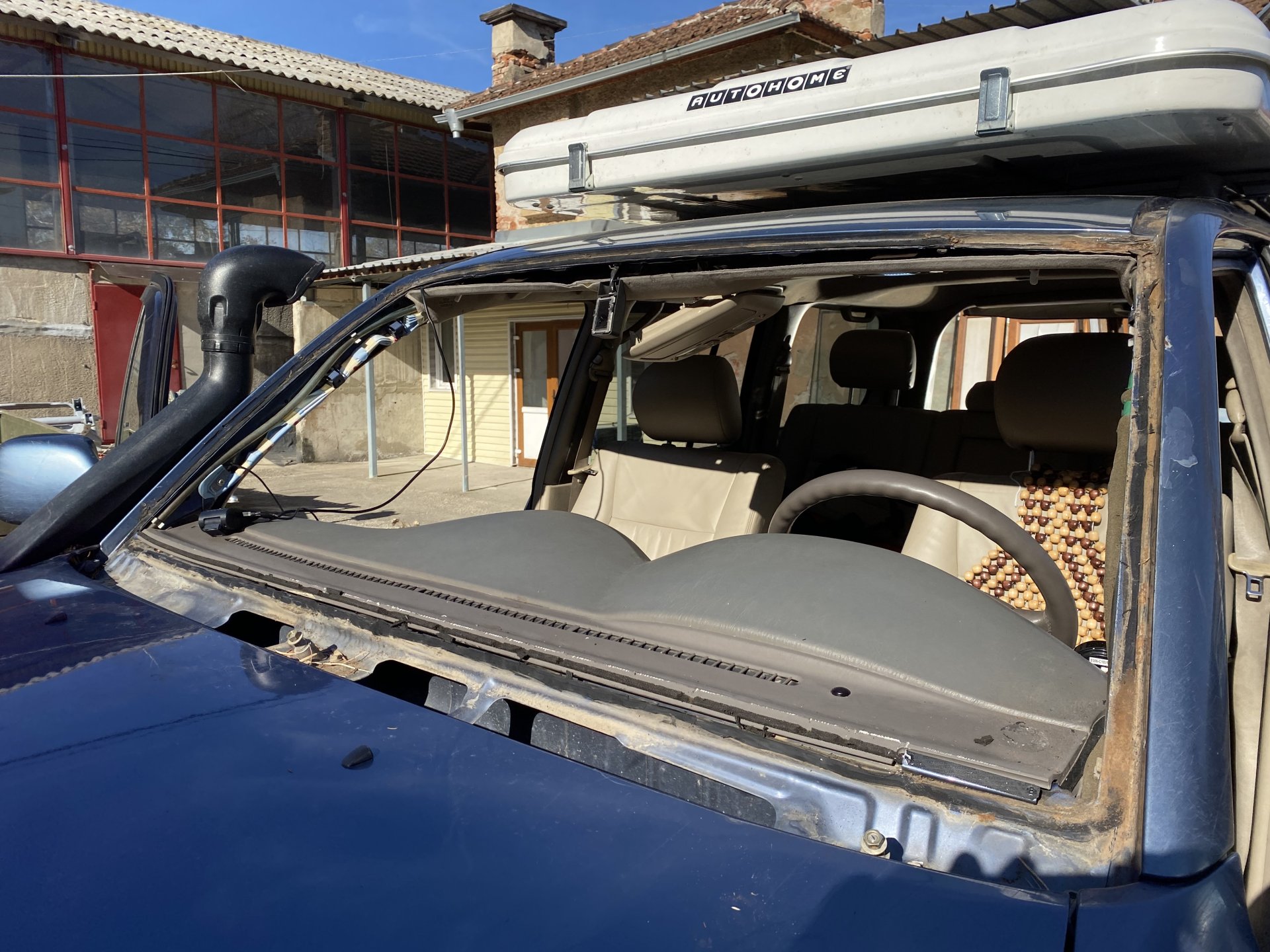

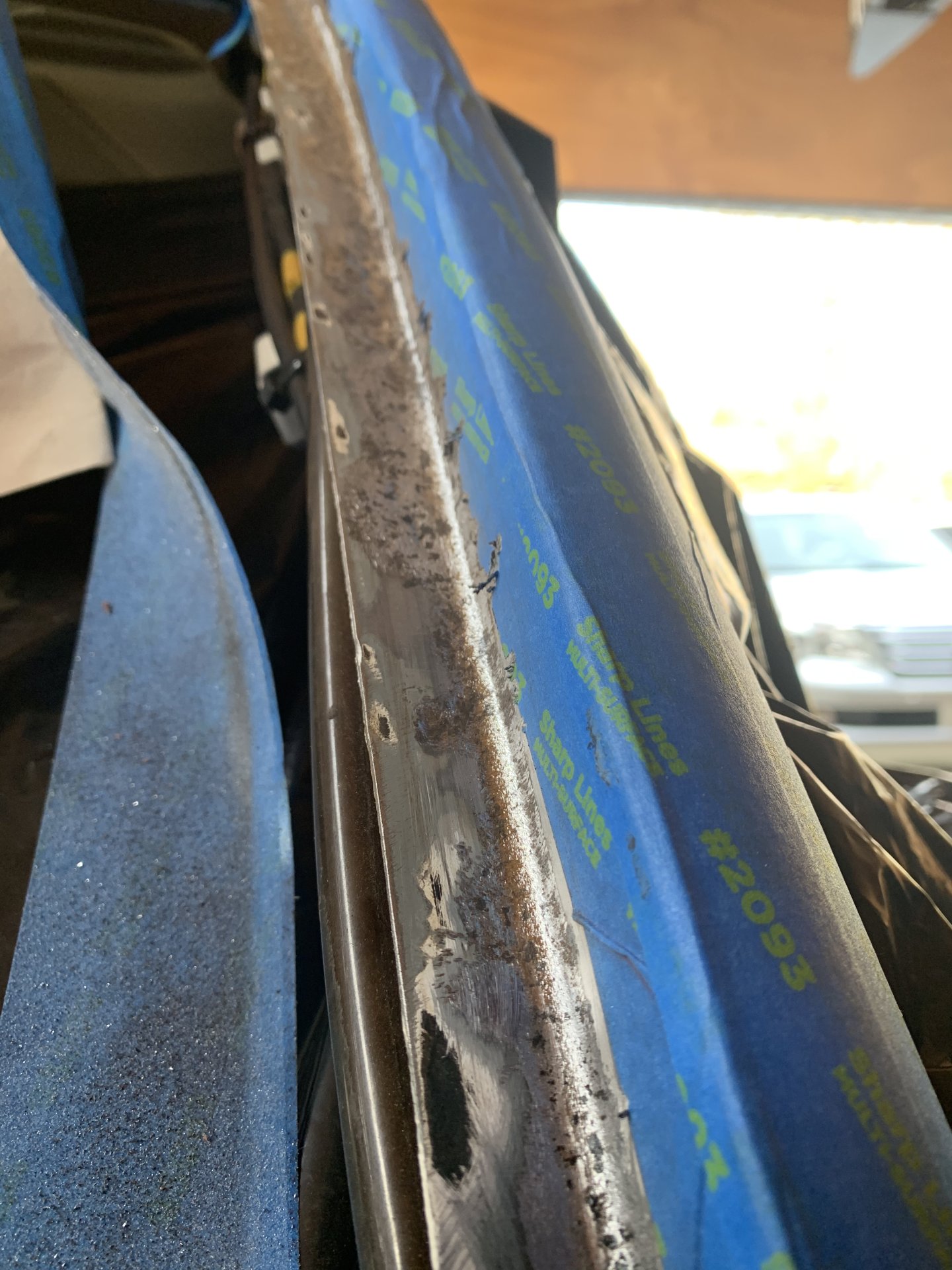

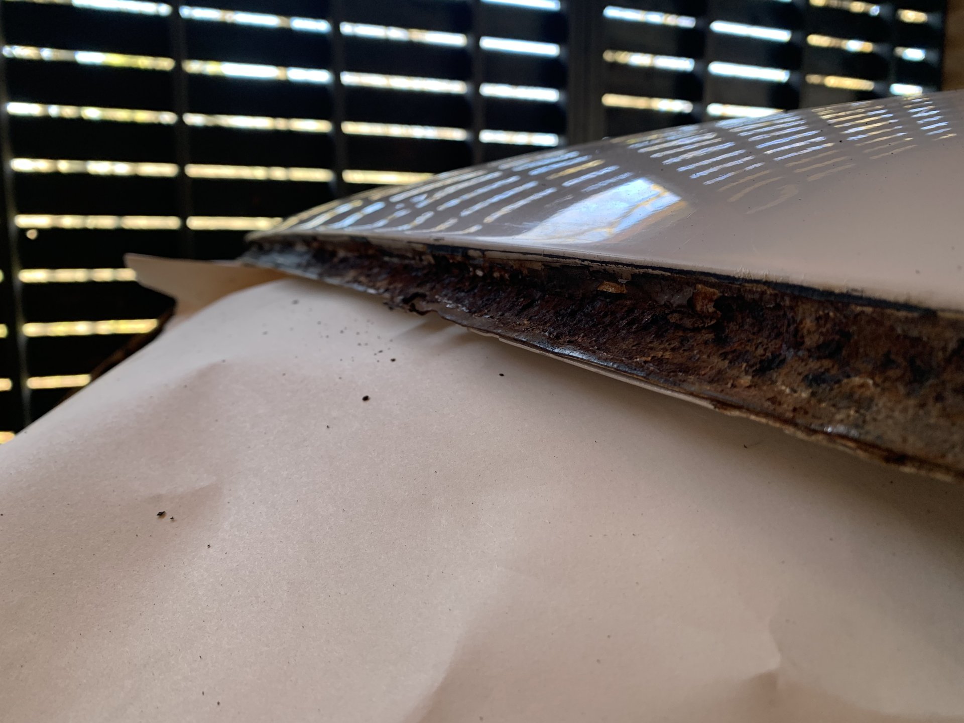

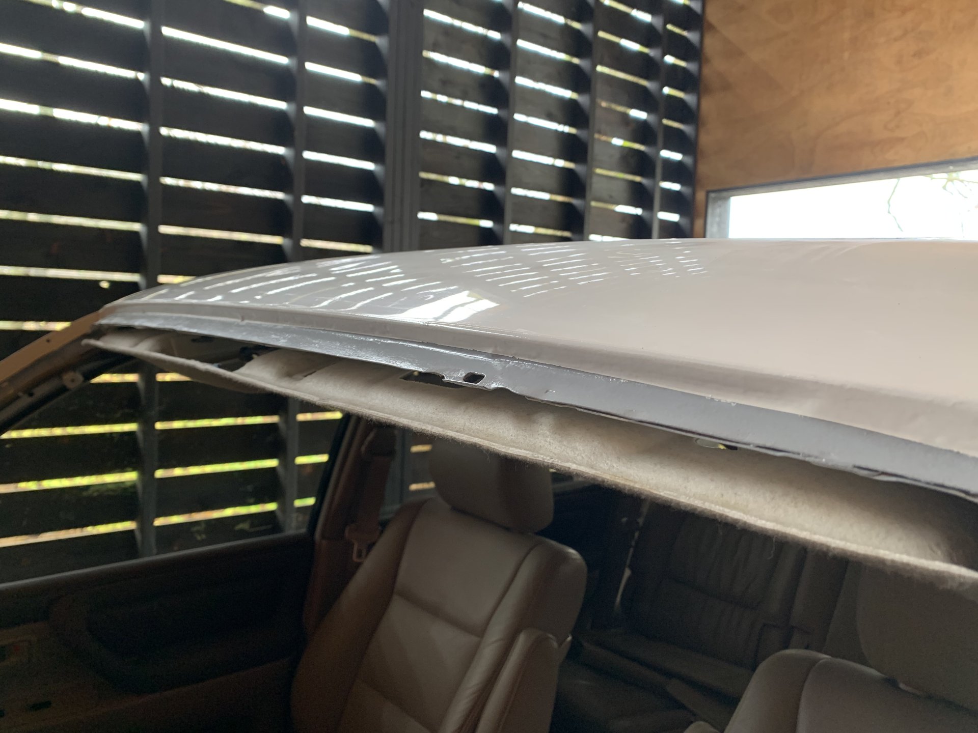

I did it a couple of months back. It was not a replacement, but I removed the current windshield, repaired some nascent rust spots and re-applied the sealannt properly to stop a leak on the driver side pillar. Nothing overly complicated.
The FSM asks for "stoppers" - 56115-60020. I ignored them, which in hindsight was a mistake. You can do without them, but they are used to properly space the windshield from the roof and you should be prepared for that. I eyeballed it and now the top horizontal trim piece (75531-60030) is too loose, as the windshield sits a tiny bit too low and the channel is too wide.
The "dams" (56117-60040 x2, 56117-60040, 56117-60050) are more important - they space the windshield forward from the body and the distance is essential so that the windshield is flush with the side garnishes. They also stop the sealant from smearing within the viewing area once you press the windshield.
Other than that it is relatively straightforward. Take care not to damage the headliner. Check the FSM at LC100 Workshop Manual - https://lc100e.github.io
(looks much worse than it was. Most of it is just dirt.

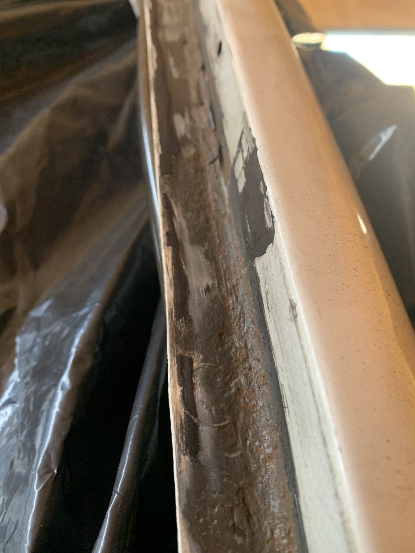

Epoxy primed after wire wheeling any rust spots.

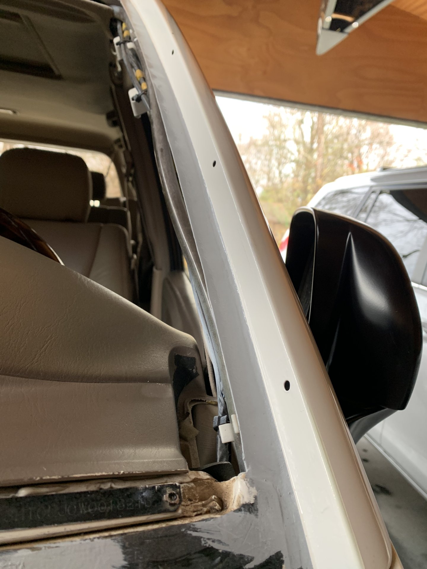

Here you can see the dams installed before applying the sealant. Use a good sealant and 100% apply primer before it!

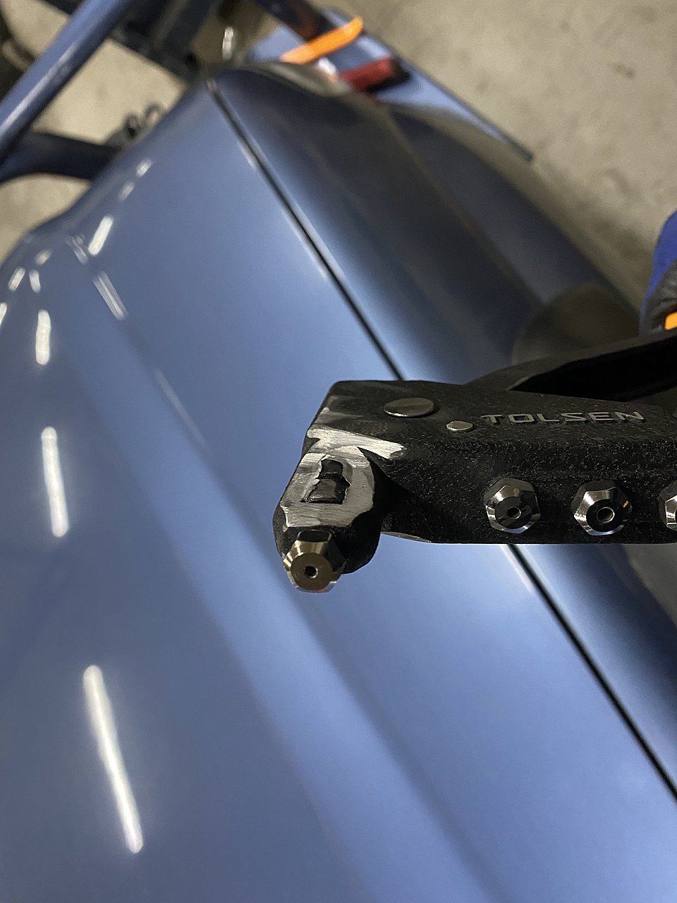

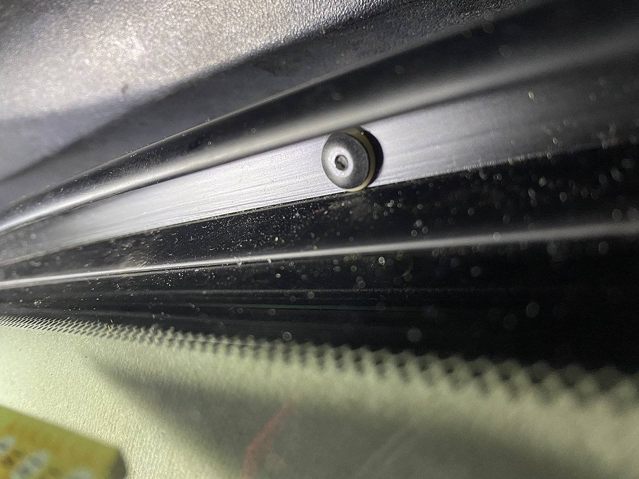

Use the OEM rivets. They are not so special, just thinner. I bought the cheapest rivet gun from the construction market and ground it so that it fits in the garnish.

Set aside plenty of time to pull the windshield and assess any possible damage underneath (rust). If there’s rust depending on how much you’ll need to remove it. I wouldn’t recommend rust converters, I personally don’t think those are effective, just my opinion. The rust needs to be completely removed by cutting, grinding or wire brush. Some pics from mine, I had rust issues and removed it was via wire wheel and carbide cutting tools. I then epoxy primed the surface the windshield would mount to and repainted the surfaces the trim would mount to.

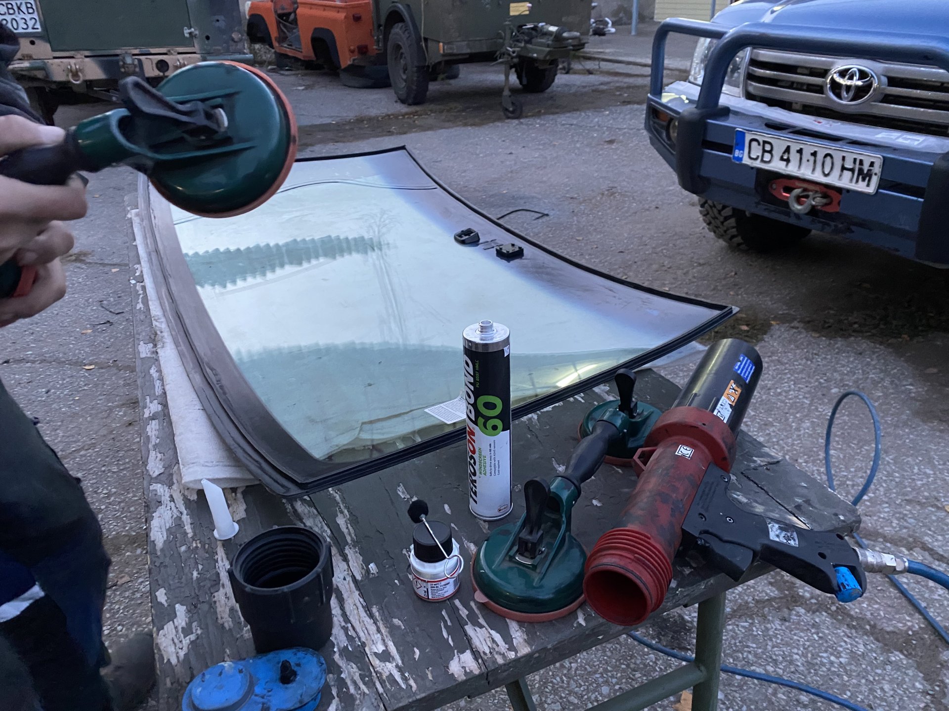

I used Teroson Bond 60 by Henkel, because I have access to it via a friend who works with it. It might or might no be available in the US, don't know, but is OEM used by some of the big German automakers.

The windshield I purchased from a local glass company, just shop around and ask for delivery if you don’t want to pick up. For the tools I purchased a Milwaukee gun just for the job. I figured it was worth it since taking it somewhere would still cost more or even if I broke even with the cost of everything doing it myself it was still worth it. As mentioned above the suction cups can be bought from harbor freight or Amazon. The urethane I also purchased from Amazon which was a 3m Auto glass urethane adhesive. You could also try a auto body supply store as well just make sure you get urethane adhesive for auto glass installation. Take your time and give yourself plenty of room to work. Also protect the areas around the windshield with tape or similar so you don’t scratch the paint or get adhesive on it.
