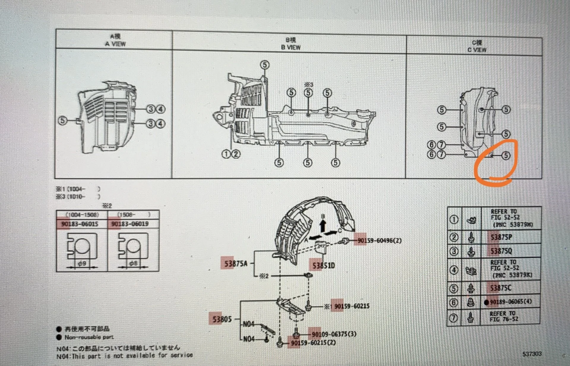

6) Of course I have 1 clip left over from the drivers side (I installed the Slee battery tray while the battery was out)....anyone remember a sneaky clip location? I looked EVERYWHERE and can't find where I took it out of. (I removed the fender liner to do the battery tray and removed some of the cover plates to get to the UCA thrubolt)

No clue what you mean by extra clip. Maybe post a picture..

The plastic clip is just the standard black panel push button clip. I just ended up with an extra and have no idea where it came from.
Should be seven on the panel above the radiator, one on the windshield washer fill port sub-section.. possibly a handful holding the plastic side panels surrounding the AC condenser coil to the core support. The fender liner clips are much larger diameter and obviously different.
Found it. With the help of Toyota parts diagrams
it’s behind the rear mudflap. I had put that on and ended up covering it. I thought it was the screw hole for the mudflap screw.
Maybe it will happen another poor neurotic soul in the future.
