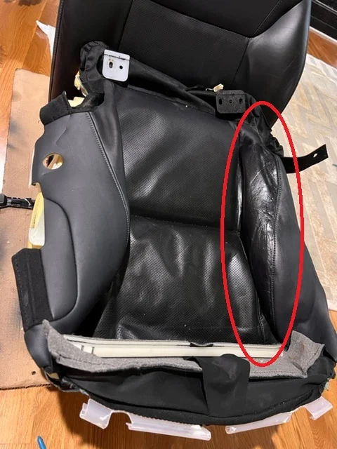

My driver side leather seat bottom was unprofessionally repaired at the Nelly Lexus of Atlanta prior to the sale (see first circled pic).
It looked so bad in person and I knew I had to do something about it.

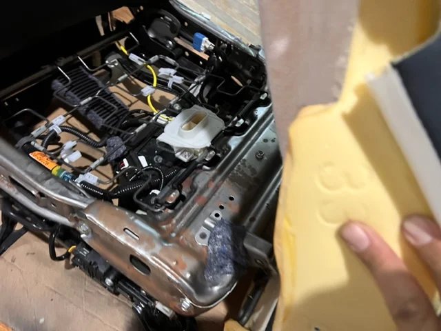

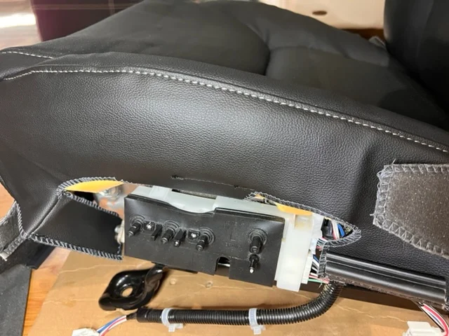

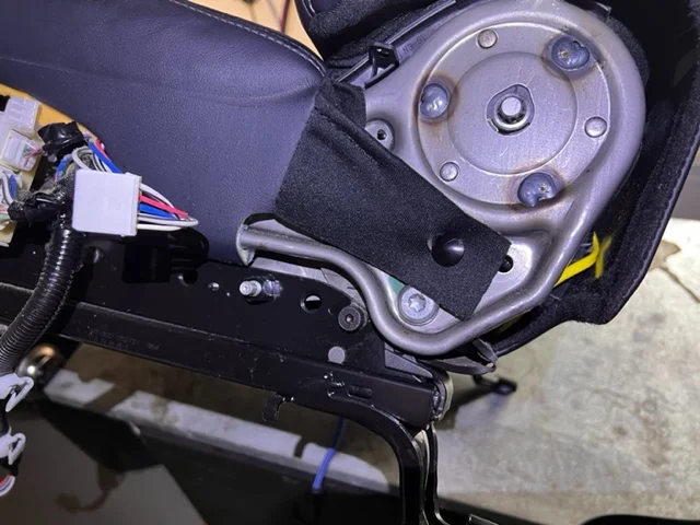

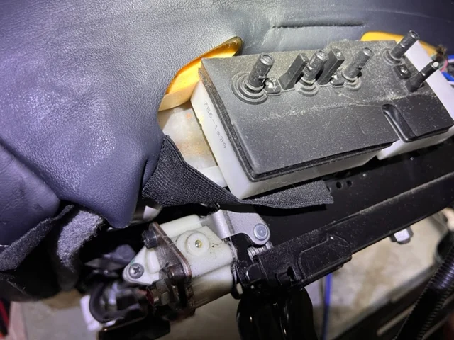

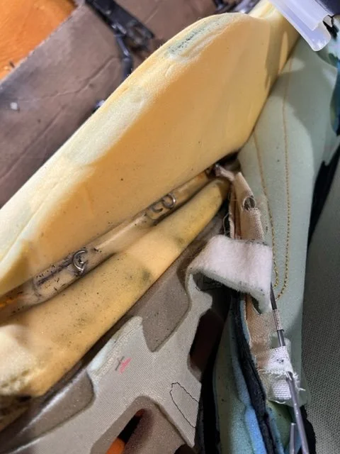

Just tried the bottom piece first to see whether or not it is worth the time and effort to replace.
As you can see the from the picture, it looks pretty good and feels very nice.
One thing to note, it is in matt finish compare to satin finish of OEM leather.
You can apply some sort of leather conditioner to help blending with OEM leather, however, I'm planning to replace the whole front seat anyway.

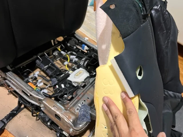

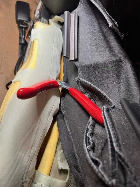

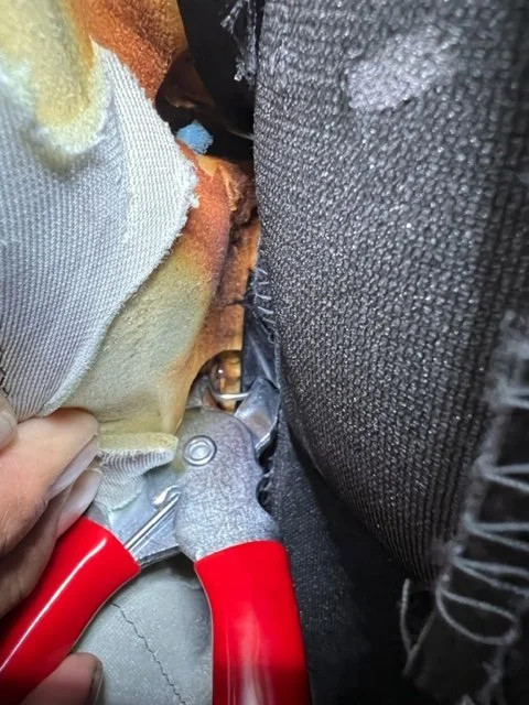

The process is pretty straightforward, however, If you're an impatient person, maybe have someone install it for you.
My local shop quoted me for $400 to replace 2 front seats and arm rest and I think it's totally worth it.
However, if you have time and you're somewhat DIY type of person, then by all means go for it.

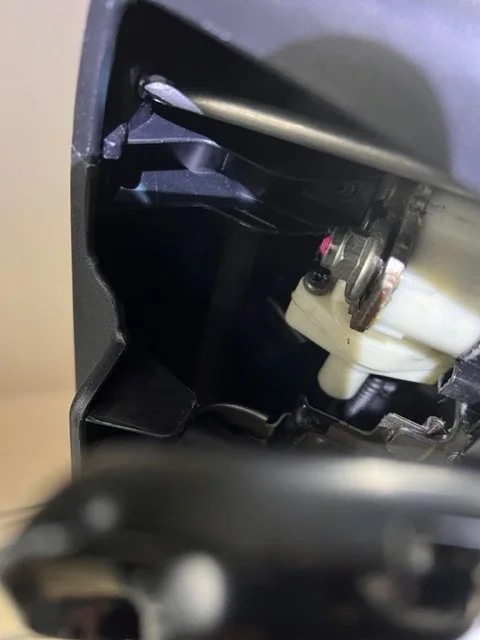

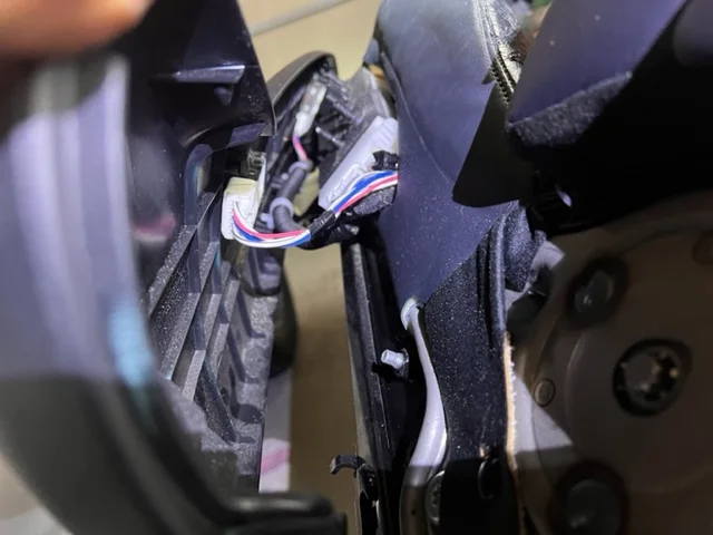

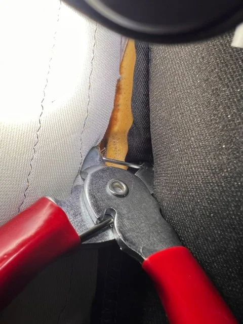

Just take your time and make sure order a Hog Ring Pliers Set from Amazon
Angled pilar works even better but I didn't have any issue reattaching the hog rings.

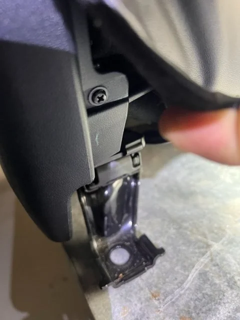

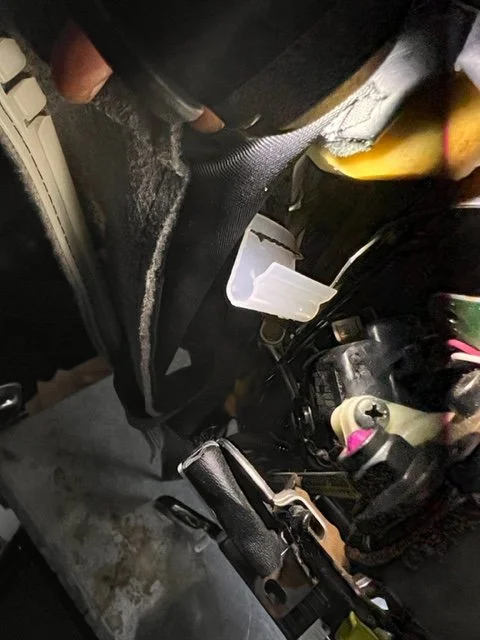

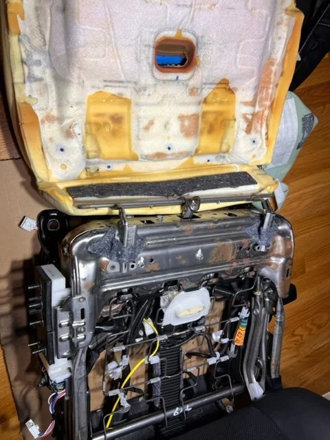

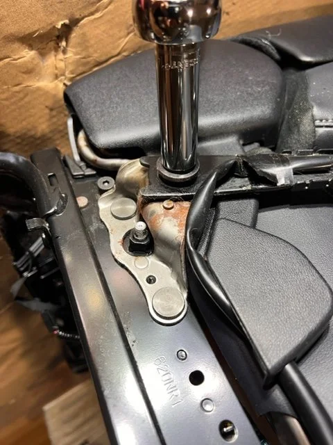

Also, make sure you disconnect the battery before removing front seat that has an airbag.

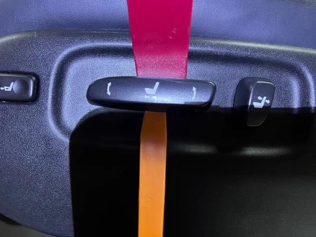

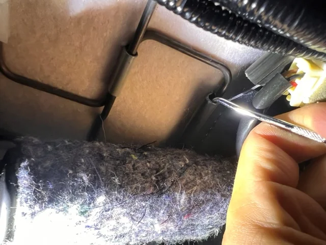

The plastic cover of front seat got some screws so don't try to yank it.

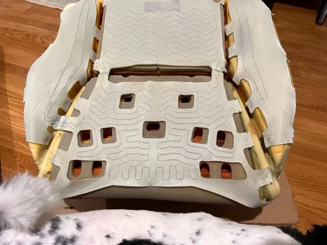

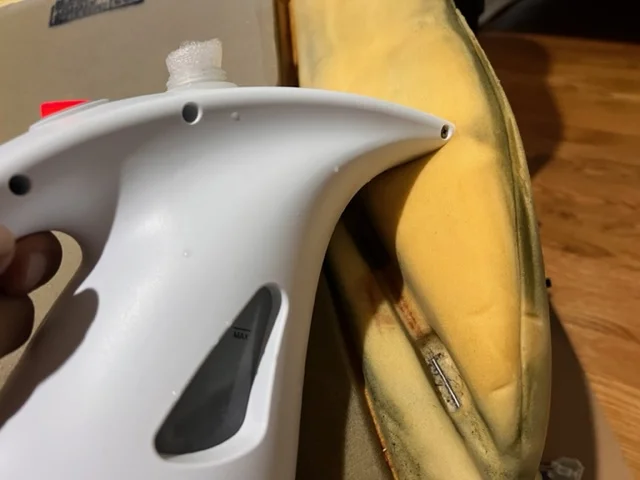

Use cloth steamer or even a high-pressure steamer to recondition the seat foam that compressed over the time.
Also use the steamer to reduce the wrinkle after the installation if needed.
Document your progress with pictures so you can put it back together properly.

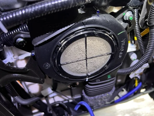

Now it is a good time to clean your seat fan cover.
