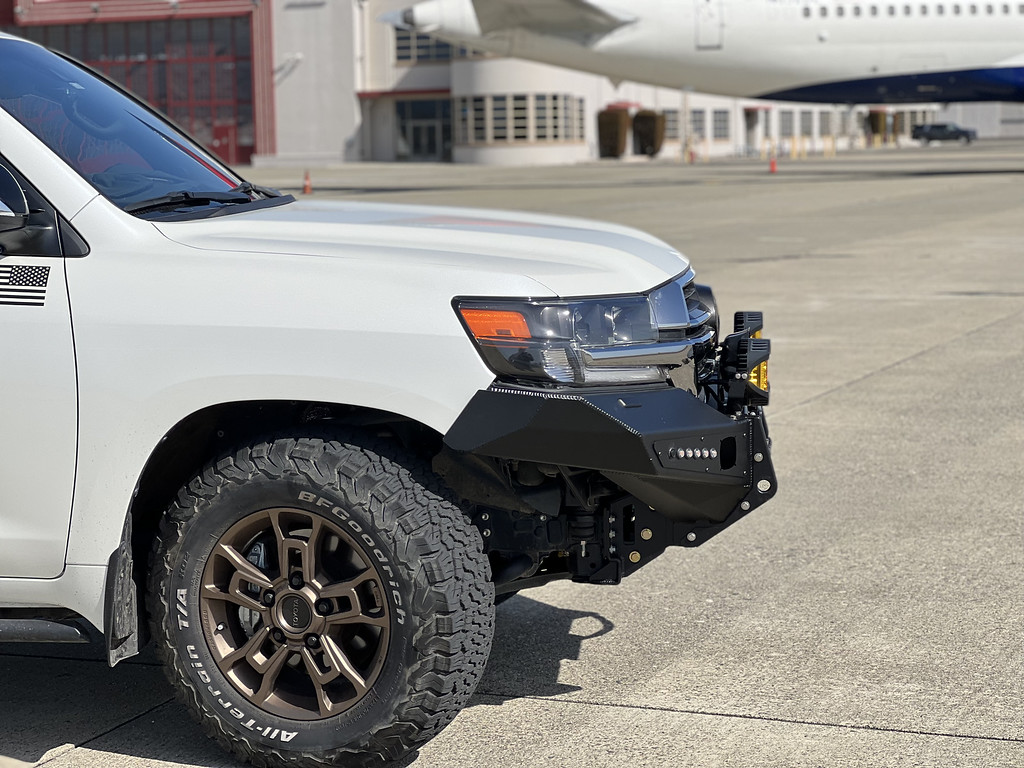

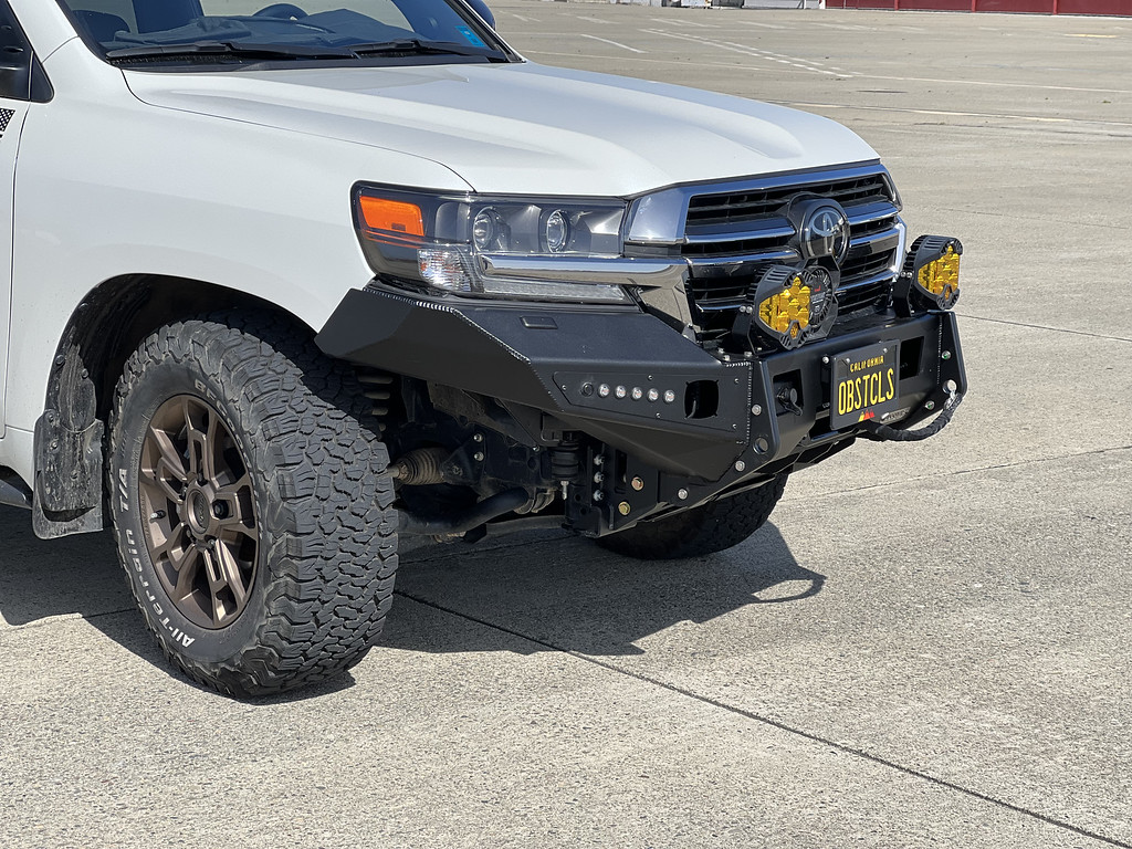

Just waiting for flush mount bezels from Baja Design to complete the install. Finally got the personalized plates as well after a few months.
Looks good; glad to see someone not running the Rigid 6" lights. I am looking at doing a Dissent full front like yours later this year, but was leaning toward the Squadron flush mounts as well so it is nice to see someone else go with that option too (though I'm still undecided on the bullet lights). Please post pics once the lights go in--did you go amber or clear?
I have a choice- I already had the SAE clear Squadrons in the original bumper, so I'll probably just use those. I have a set of amber Squadron Pros in the combo lens, so they might end up being mounted on the front rail of the tent. I'm also not 100% sure on the bullet lights but they are easy to delete if I decide I don't love them.
My flush mounted 3" lights ended up being low ditch lights the way they angle in the bumper -- maybe yours are different with the full bumper
Ordered some 15 degree offsets that should be here today but if I don't like it I'm gonna get the 6" SAE cutouts
I cut these out myself for a Diode Dynamics 3" and 2" pods
I have a choice- I already had the SAE clear Squadrons in the original bumper, so I'll probably just use those. I have a set of amber Squadron Pros in the combo lens, so they might end up being mounted on the front rail of the tent. I'm also not 100% sure on the bullet lights but they are easy to delete if I decide I don't love them.View attachment 2998203

Great build. What did you do to address the white painted metal plate (lack of a better word) behind the bumper? I did the full replacement and my truck is silver so it stands out too.
Great build. What did you do to address the white painted metal plate (lack of a better word) behind the bumper? I did the full replacement as well and my truck is silver so it stands out as well.
Hi,
I rattle can painted those areas with matte black plastidip- totally makes them disappear and I can peel it off if I ever need to in future.
Best,
Ken
Hi,
Best,
Ken
Nice! I was thinking the exact same thing. I have a can of plastidip sitting around but haven't gotten to it yet. Thanks for confirming.

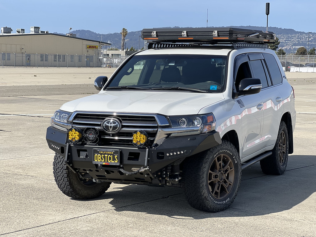

what’s that Triton thing you have mounted?
Airhorn speaker. Bit overkill. Would like to mount it back behind the bumper really.
nice! what do you have powering it from inside the rig? and your intended use - yell at neighborhood kids?

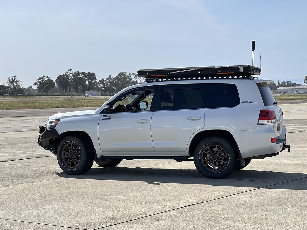

Looks great! Are those Bud built sliders? Been debating if I should get those or something else! Would love to hear your opinion if you like them or if the install was tricky?
Hi- thanks, those are Bud Built sliders. Install was very straightforward, just 3 hours total I believe. The only awkward part was having to drop the gas tank shield.
Thanks for the quick reply! Hope to see you around the bay sometime!
