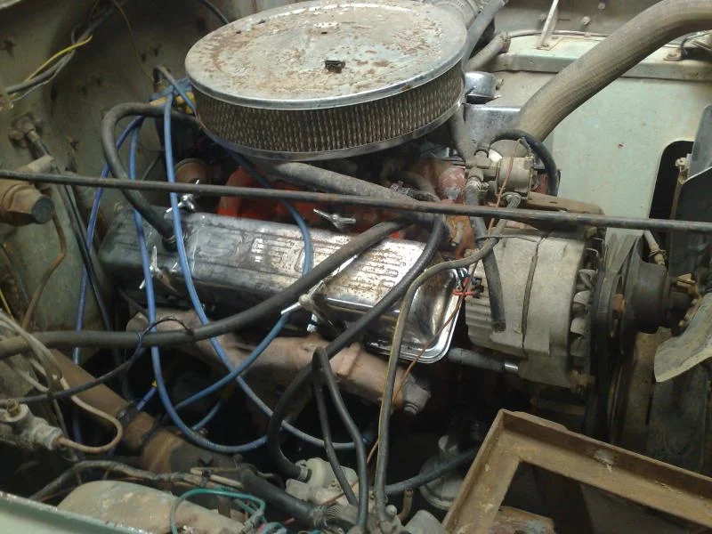

I'd graft the firewall section off the 42, install the pedal swing arm assy, steering column and the p/s system as well.......
Looks as if that cruiser was on propane once, being a fuel cut solenoid and regulator are still intact........

yeah its on duel fuel,just not running on gas when i got it,its all there though,the gas carby is sitting on the passanger seat,propane is known as gas in australia by the way,what you guys call gas we call petrol,its common over here,propane that is,only scarce in remote areas and at 1 third to half the price of petrol and diesel i tend to mostly run on propane

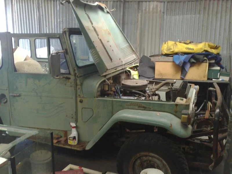

so will i need to also swap pedal assemblys,at the moment its got the original 3 speed in it,clutch isnt working though,has no cap on clutch master cylinder and appears to be full of water,oh i found this shorty at the wreckers down the road,havnt done alot with it yet,just pulled roof off,been sitting round for a while because of the 45 ute i bought,but time to get stuck in to them both i guess i should put up a build thread,but this is all new to me so sussing my options,re converting to newer disc front end,i was thinking of using the bjs power steering in the ute and going 60 series power steering in the shorty
