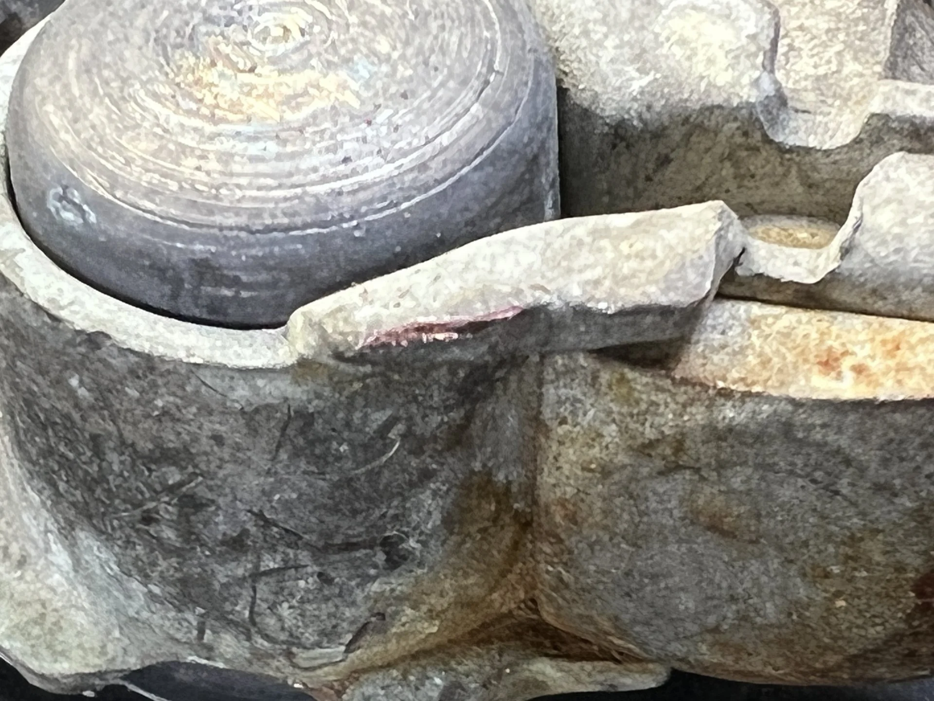

My existing connectors are realistically "fine," in that they allow the truck to start without issue and I don't see any big problems with them. They might not be grabbing the terminals as nicely as they could have been due to being slightly deformed, but there's no real urgent problem. The new connectors are just a nice-to-have at this point, so there's no rush and the 3-week timeframe is fine for me.

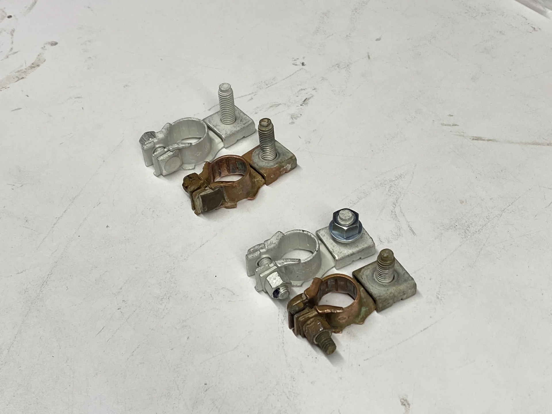

Yours appear to be aluminium? Pretty sure mine are copper, which is a better conductor. Interesting to see what the new ones will be like.
@32cls6speedt - As far as I know, mine are OEM, yes.
OEM are not copper. They’re aluminum.
They appear to be aluminum but are actually copper with a coating that resembles aluminum. Possibly zinc? Lead wouldn’t be durable enough..
That coating having corroded away is why @eatSleepWoof terminals clearly show copper.
Terminals arrived much quicker than expected.

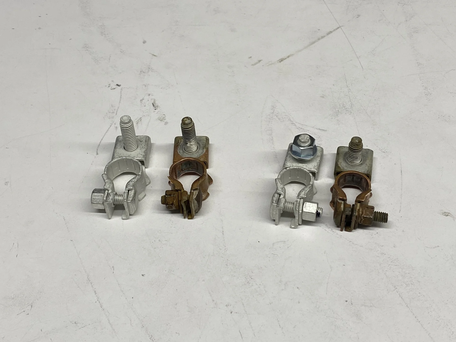

Comparing the old & new.
A few notes:
1. The positive terminal did not come with a nut at all.
2. The negative terminal came with a nut that has an attached crush washer (physically attached - I've never seen this before). My original negative terminal had a flange-nut on it. I used the new setup.
3. Blue threadlock was pre-applied on the clamping bolt's thread on each terminal.
A few notes:
