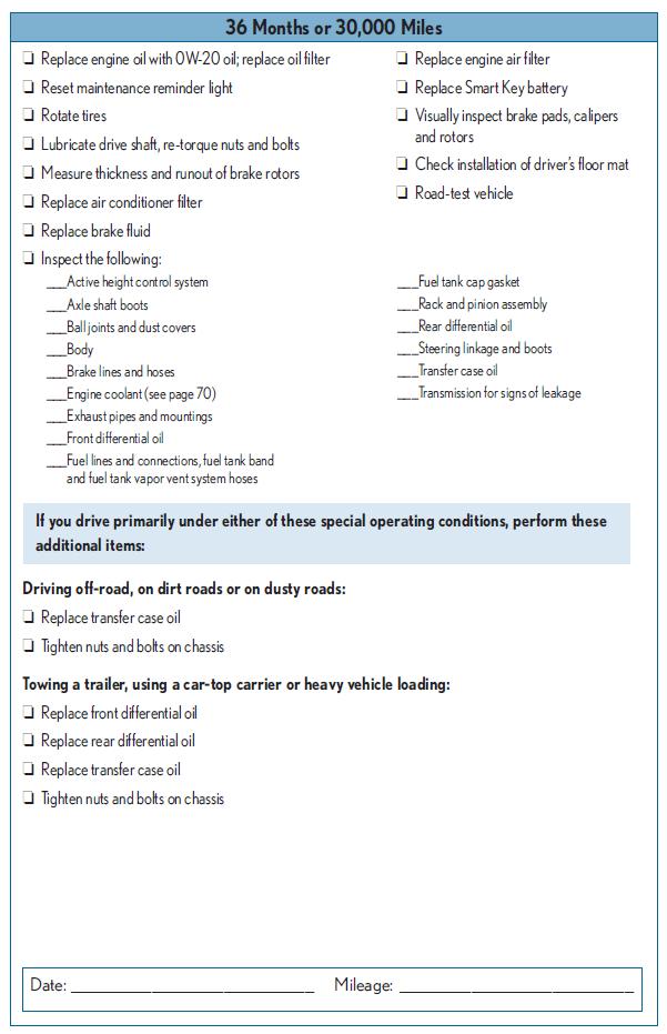

I usually start w/ the manual. Toyota has the schedule in the manual with options for mall crawler to off road warrior, or light maintenance to heavy.
From there I usually deviate based on my schedule, how and where I've driven the truck, opportunistic maintenance, feedback from here.

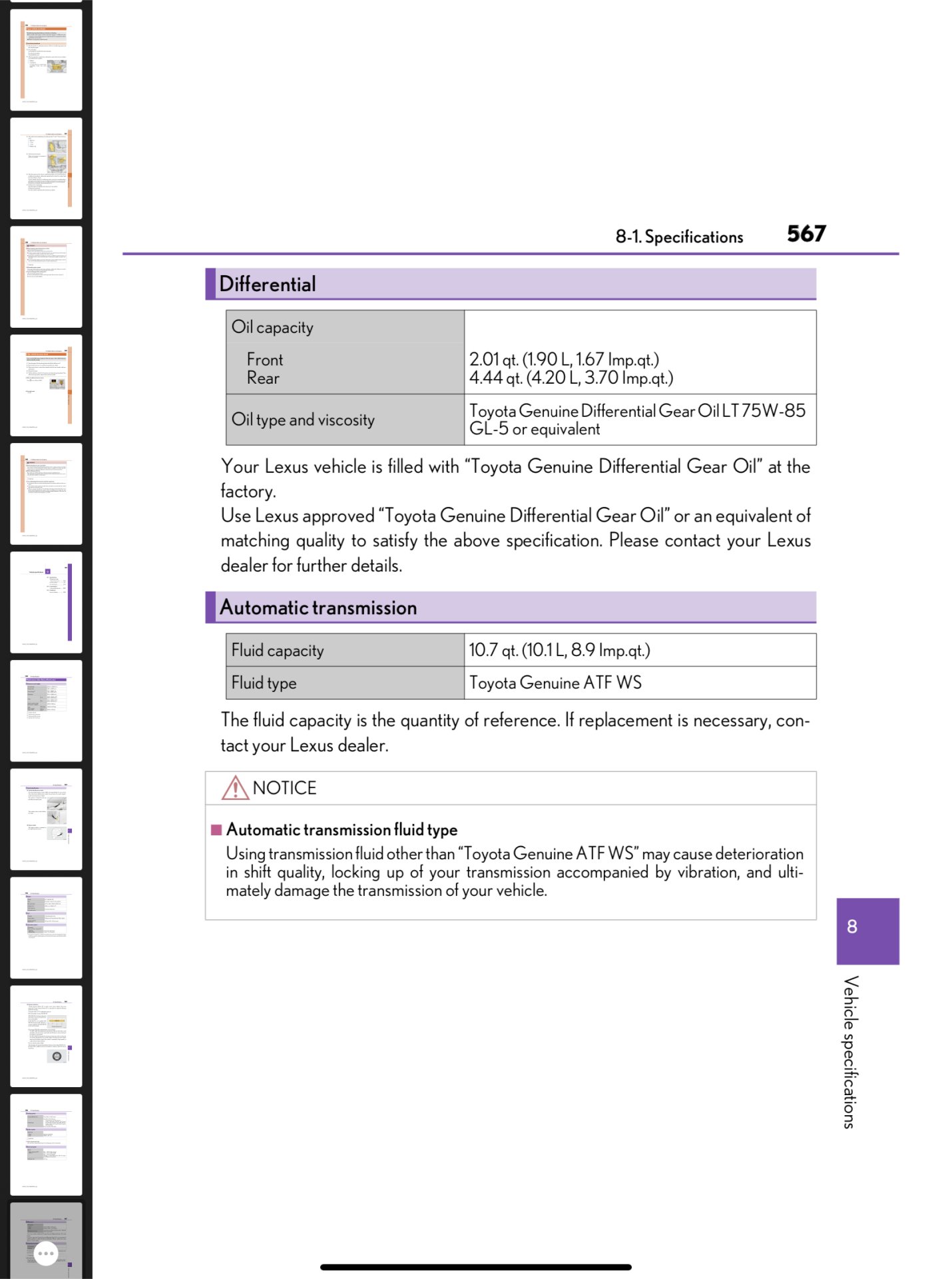

For my LX the manual is called "WARRANTY AND SERVICES GUIDE" available on Lexus owner's web site for download as PDF. Looks like this
I also have front and rear e lockers, and use them regularly. I'll service on the factory maintenance intervals unless I have some reason to do otherwise.
If you don't have extended breathers and you go through deep water crossings, that is a good reason to service sooner than recommended. Water in the gear oil is bad news.
Severe service, like towing a ton is another good reason. But that is covered in the factory intervals.

I thought it was the transmission that is “sealed” and requires the World Series (WS) special oil. Transfer Case in factory specs seems pretty easy to get.
Transfer Case:
  1. Mobil 1 GL-5 75-90
  2. Amazon product
Transfer Case:
  2. Amazon product
