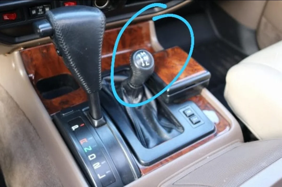

Hey everyone, hope you all are doing well. I have a question, I was driving my LX450 the other day and by accident I shifted the lever next to the gear lever into L position. I heard really loud gear rubbing sound for a few seconds then the car stopped running. I stopped, turned off the engine then shifted it to H then it started running again. I am wondering if i did any damage to the car. Please let me know since I am worried. Thanks. Attached is the picture of the lever I shifted.
That is not an accidental diff lock you accidentally put it into low range while driving. It would be like shifting the car from 5th to 1st gear. It is unlikely you actually got the teeth to mesh or did any serious damage but it is really not good for the gears. I would stop the truck, put it in N and then shift back into L and see if you have any unusual noise.

Anyway, it is almost certain that the only thing that happened is that high range was disengaged and the teeth/splines on the dog clutch might have ground off a couple of thousandths against the teeth/splines on the low range gear. Irritating and awful sounding, but no real damage done.
Why would you change fluid? If there was damage done, that would not fix anything. *Maybe*, *possibly* a careful inspection of the fluid *might* reveal a chipped piece. And *maybe* you could determine where it came from. And "possibly* that might tell you that you have a problem at some point down the road. *maybe*. *Possibly*.
But it can not hurt anything and since you just got the rig, it is never a bad idea to check all the fluid levels and take a look at the magnetic drain plugs to see how much metal dust has collected on them.
Transfer cases get their gears ground once in a while. It happens. Usually not at road speed but it happens. No big deal.
BTW, the "lever next to the gear lever" is the "Transfer Case shifter".
The "L position" is for Low Range and the "H position" is for High range.
It's an on road/off road 4wheel drive truck kinda thing.
You "car stopped running" because it was shifted into the "N position". "N" is for Neutral (Transfer case Neutral).
Actually, it did not stop "running" until you turned the engine off. It just stopped powered movement down the road because the transfer case was in Neutral. This disconnects the power from the transmission to the driveshafts.

Thanks dude! He is only sitting in the back from now on!!! Also I put the car in neutral and tried to change the transfer case shifter to low range and no problems so I think I am ok!
