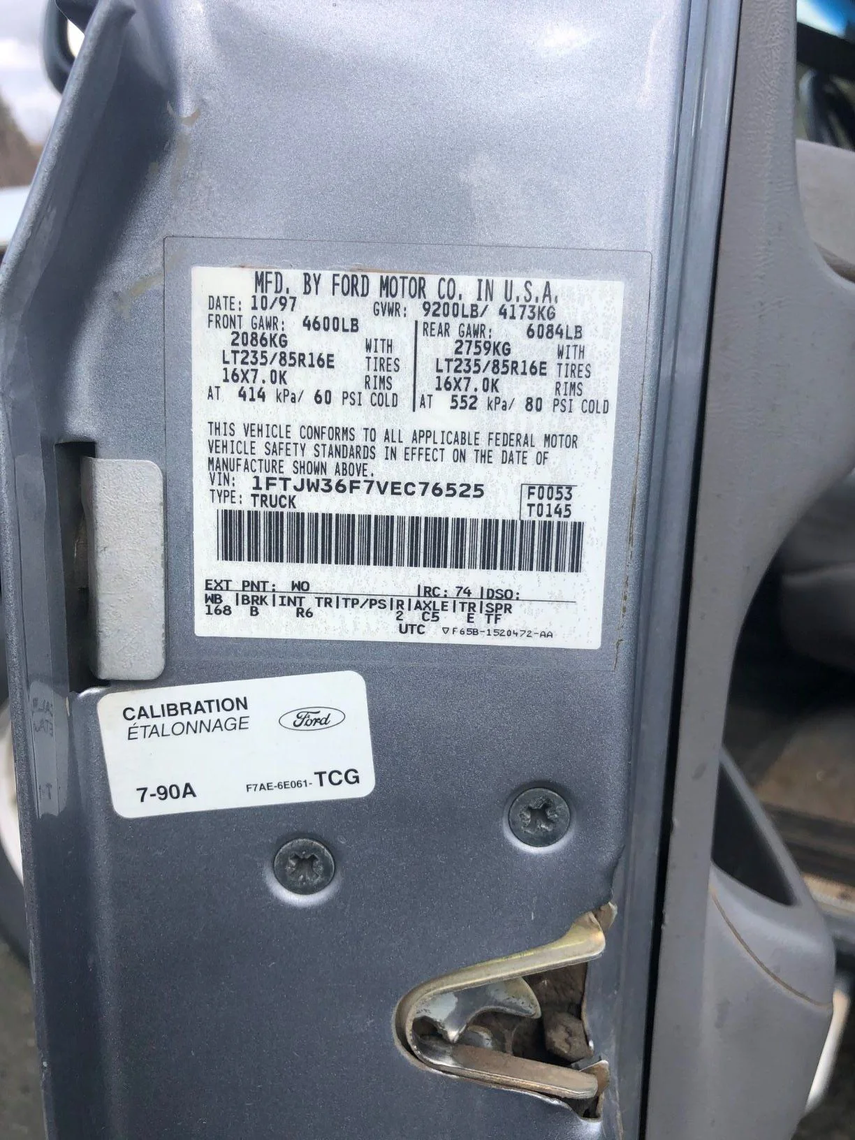

Does your door sticker look like this?
This is from my '97 and as you can see, it calls out same as yours. But the tire pressure's noted are not "recommended tire pressure". Looks to me to be max pressure for the max rated load. When running same size tires, front & rear, the only reason for running different psi, is if your weight distribution between axles is not near equal. Scales should tell you what weight is on each axle currently. And that will change more significantly on a pickup as opposed to a sedan or SUV because of how they're used (example: hauling bigger loads). Chalk test is best for determining what psi you should run. Otherwise its just guessing or experience. I have a Lance slide-in camper that's supposed to weigh 1350lbs dry. I'll run 75lbs rear and 65lbs front when hauling it. Otherwise its 45 - 50lbs empty for all four. My tire size is 285/75/16 on Toyo M55s.
