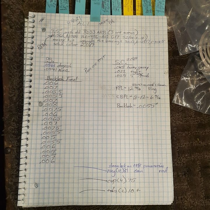

Update from zuk
More setup info and pics
Cost breakdown. Zuk didn't like my Koyo bearings So i bought some from him.
