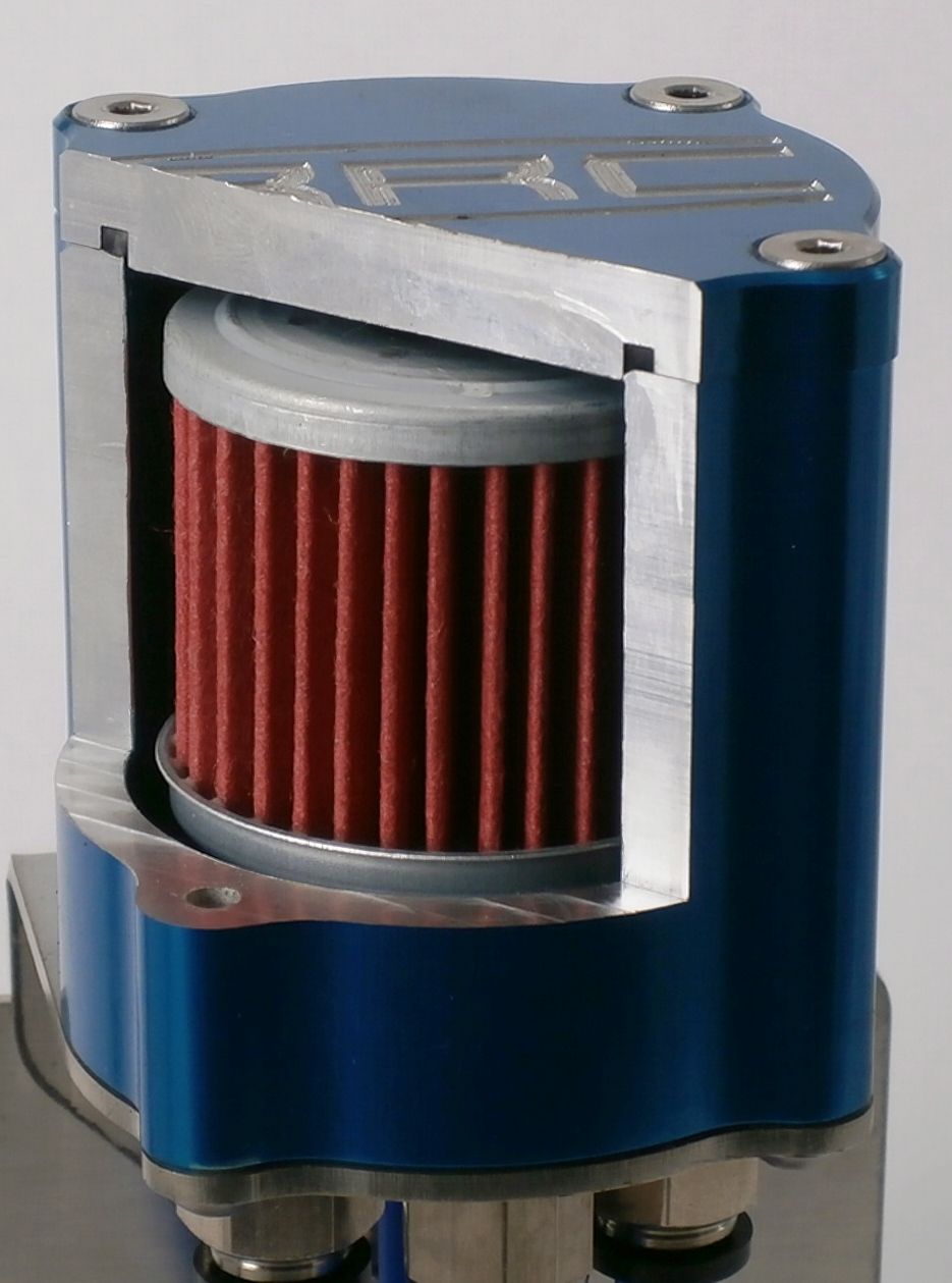

Is there a diff breather kit like ARB has for the 80? I’d rather buy a kit than try to compile a bunch of pieces. I can’t find anything online
Thanks
This is what you're looking for....
https://www.amazon.com/ARB-170112-Differential-Breather-Kit/dp/B00QBQYNF0/?tag=ihco-20
I have this kit installed on my 100 Series. Actually, 2 of these kits. I ran the rear diff breather up behind the left taillight so I would be able to maintain a consistent "rise" in the line. The front diff and transfer case breathers run up to the 2nd kit which is installed on the firewall.

I have no doubt the ARB is quality. I wish the kit came with clear hose and three separate filters, though.

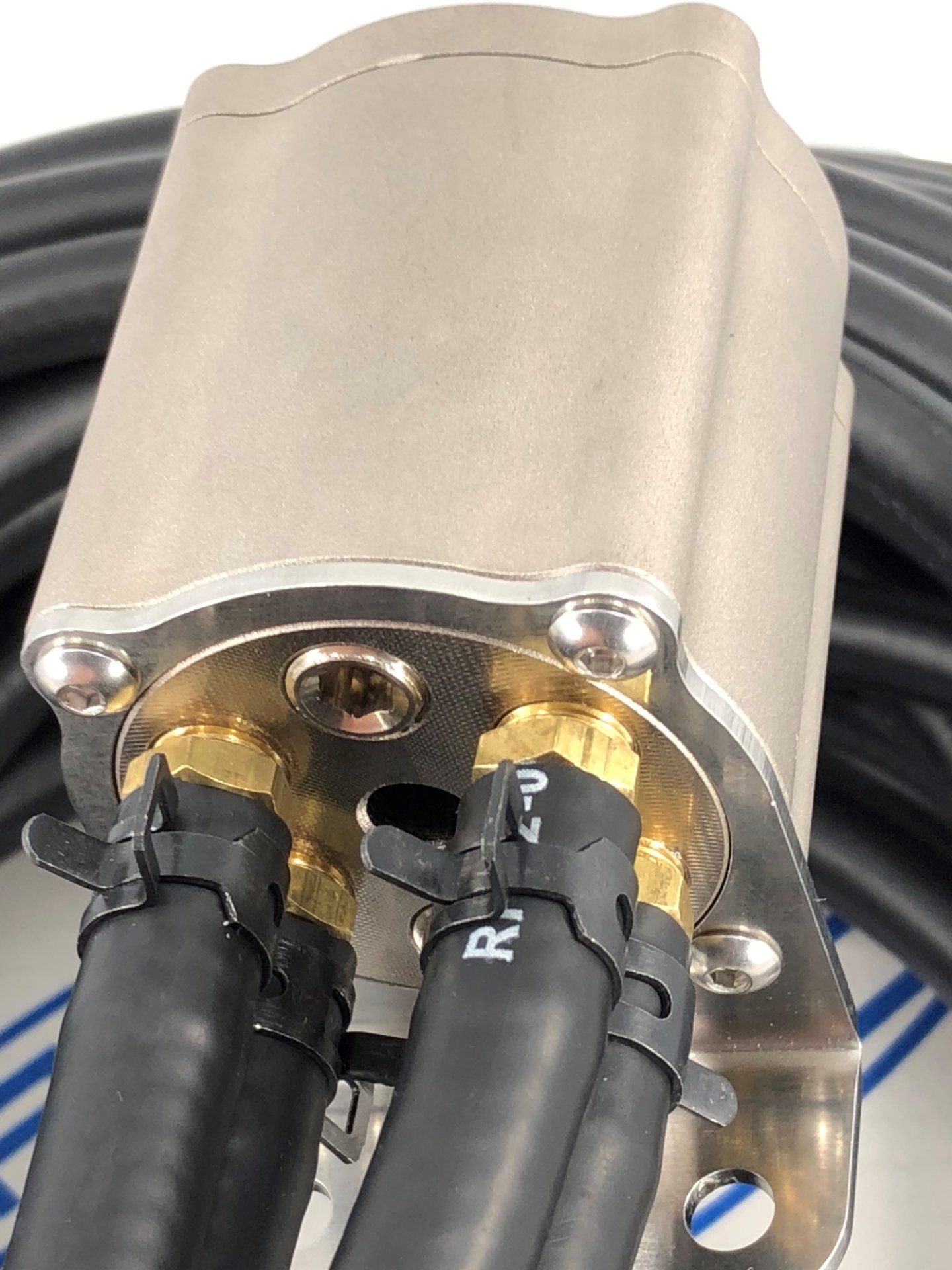

Hey guys, can you not just use 8mm nylon air line up onto the engine bay, then use pneumatic exhaust filters on a bracket?
Sure, you could do that. Tons of examples of homebrew kits out there. The ARB worked for me since it was all inclusive and I'm a self-described "convenience enthusiast". And, for just $70, I figured my time was more valuable than any savings I would have had by building my own.
Thinking about going the Aussie way.....should be enough hose and breather caps/filters to do everything
Buy a roll of basic 1/4” fuel line and make your own extensions.
Be careful what you terminate the hose with- some of those small porous filters can get clogged with dust and not breathe too well- which can over pressurize the diff and cause seal leaks.
