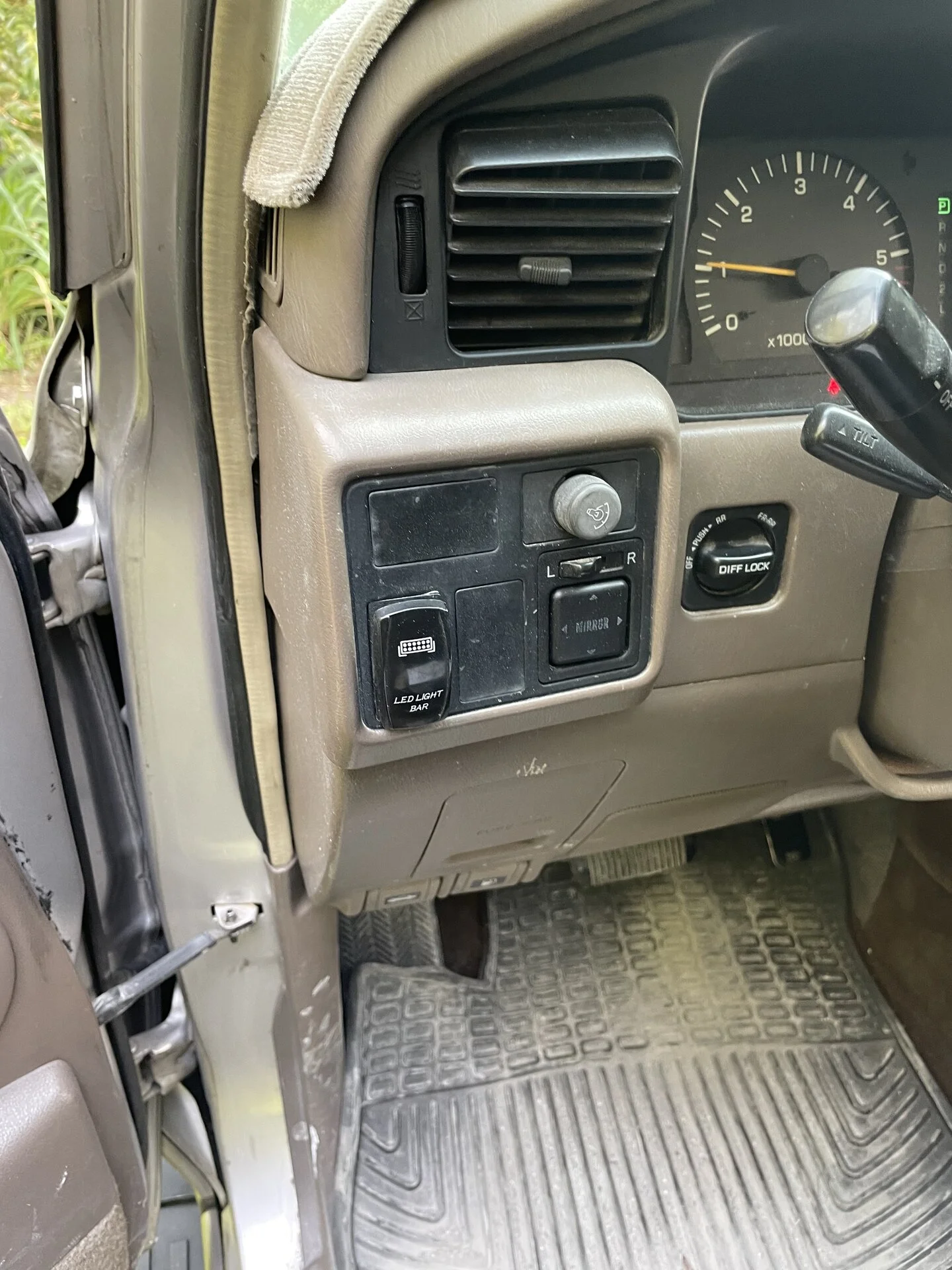

Lockers and diff lock not engaging.

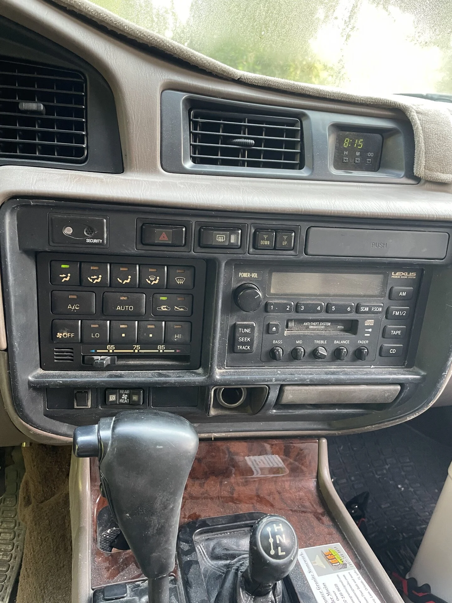

Is it really tripple locked or did they just install the dial.
What's the K code?

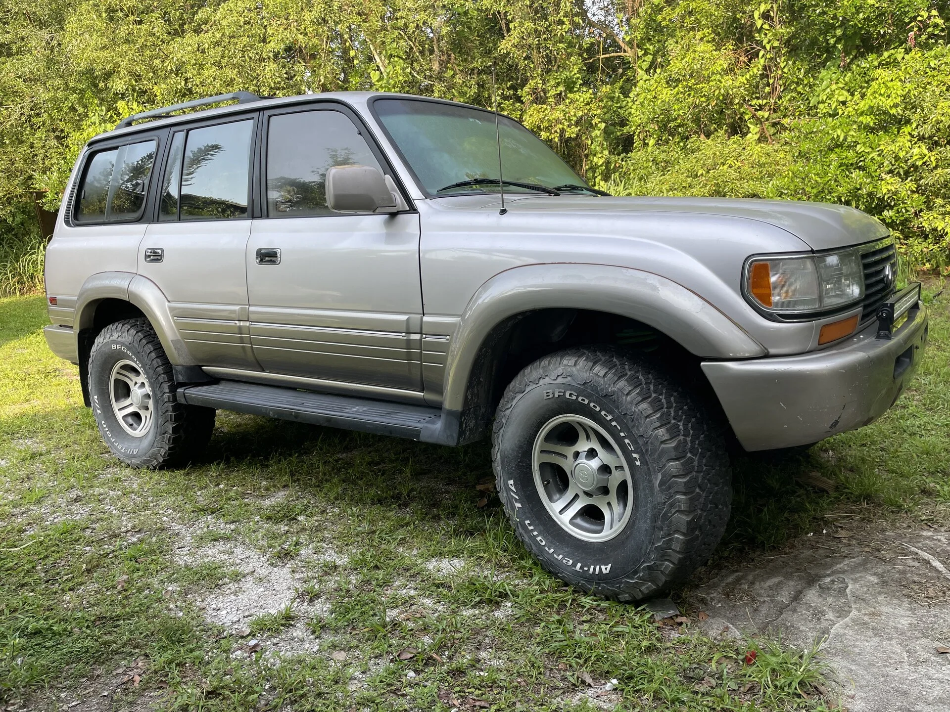

Looks like a nice original OLD truck to me. Welcome to IH8MUD, #1 RTFM and #2 read up on baselining for your new project

Be sure to read the manual (or the FAQs on these forums) on how to engage the differential lockers, putting the transfer case in low is a good start.

You'll need to play with the lockers. It'll need to be in 4 lo. Drive around in circles and if they don't engage, its not too hard to pull the actuators and clean them up. The instructions on this site are excellent.
What's the K code?
A friend of mine nearly got taken by one of the wannabe lockers, he look at the diff. and walked away.
^ They didn't come with one from factory
My 94 is triple locked and came with cdl button my buddies 94 no lockers came with cdl button my 95 had lockers no cdl button and yes the wiring is there for that. Eas just saying op said triple locked so that would mean lockers and button....
