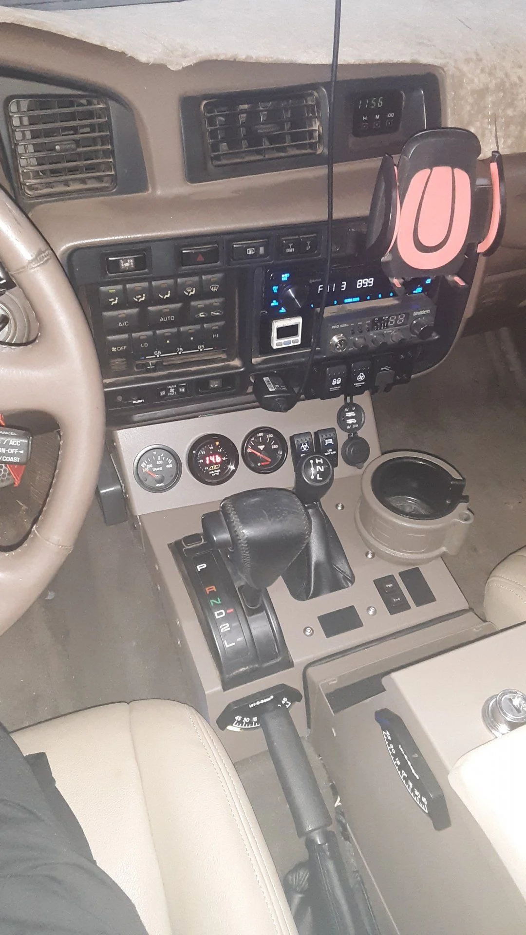

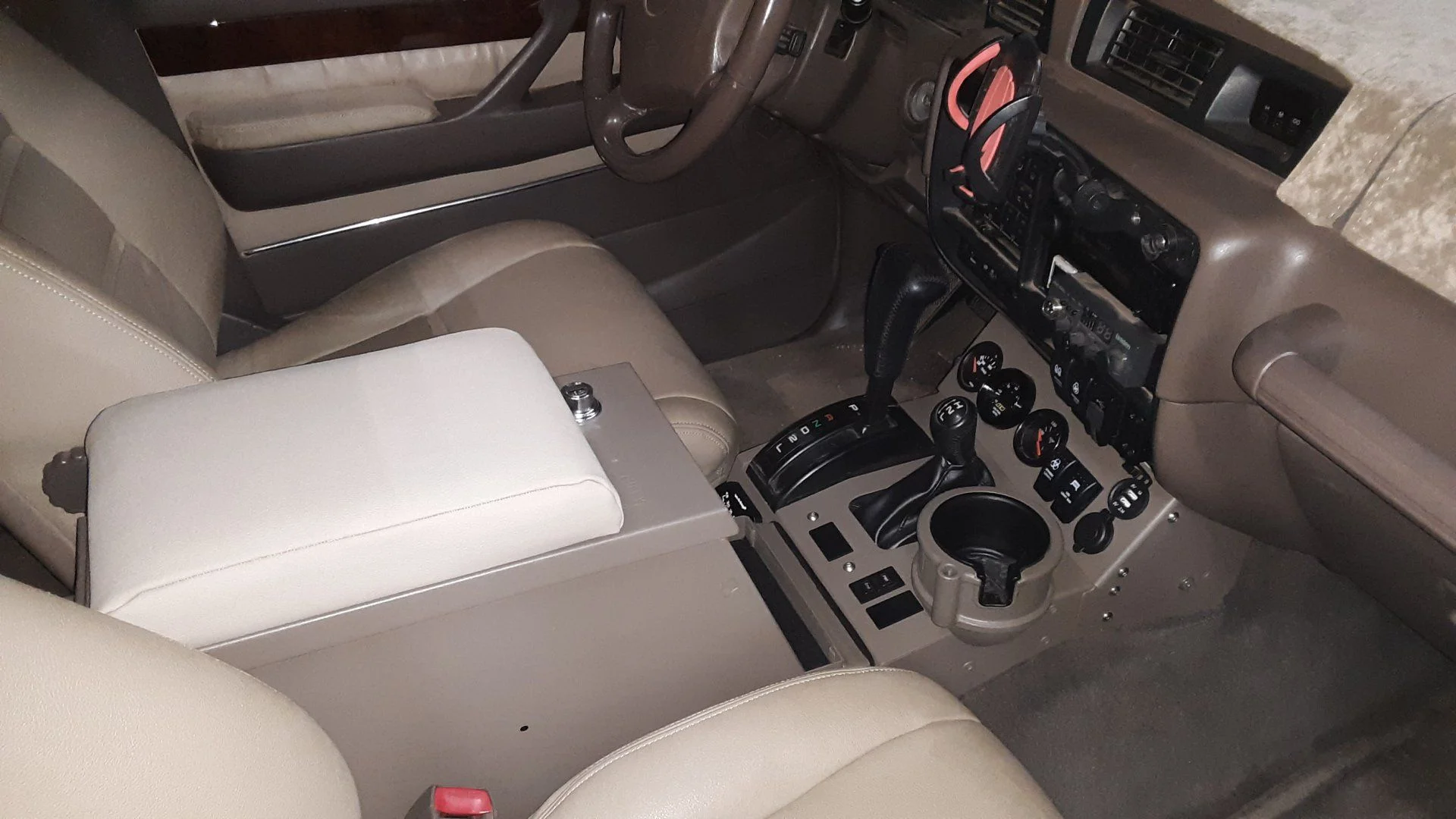

I wanted to share a recent project and I am happy with the results. I wanted to improve the center console of my 96’ LX450. It didn’t have much space because of the factory subwoofer and for me the arm rest was useless. I had some gauges on my dash for my turbo setup and wanted to get those down low too. Basically here is a list of the improvements I wanted.
-Useful armrest
-Additional USB ports
-Additional 12V power for front and rear passengers
-Location for 3 2” gauges down low
-Additional locations for aux switches
-Retain factory cupholder and 3D printed cupholder
-Additional cupholders for rear passengers
-More storage space and lockable
-Maintain functionality of rear heater
-Maintain rear seat folding and tumbling functions
-Clean, factory-like look

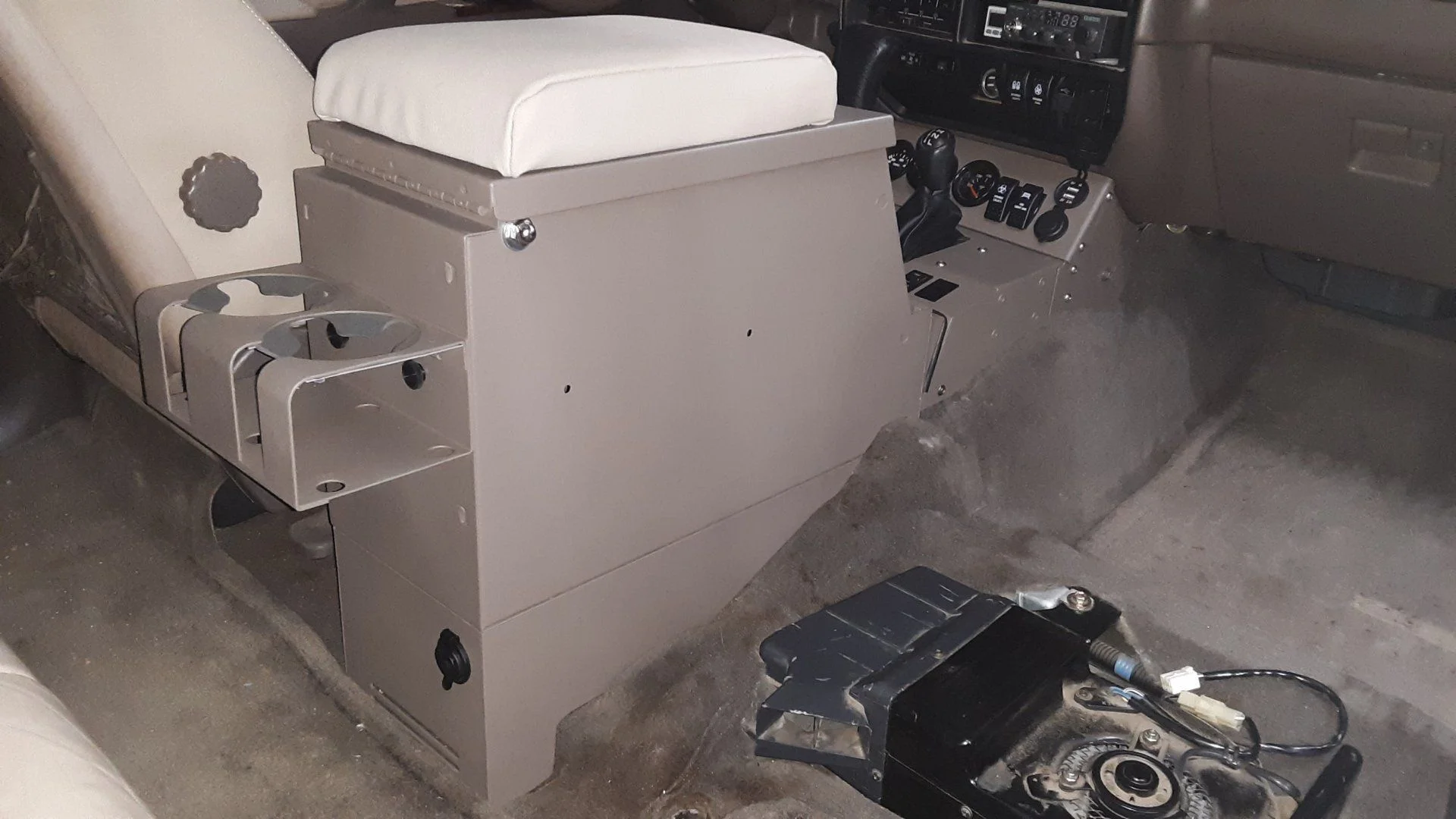

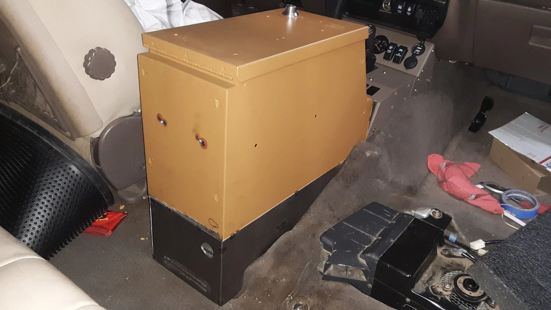

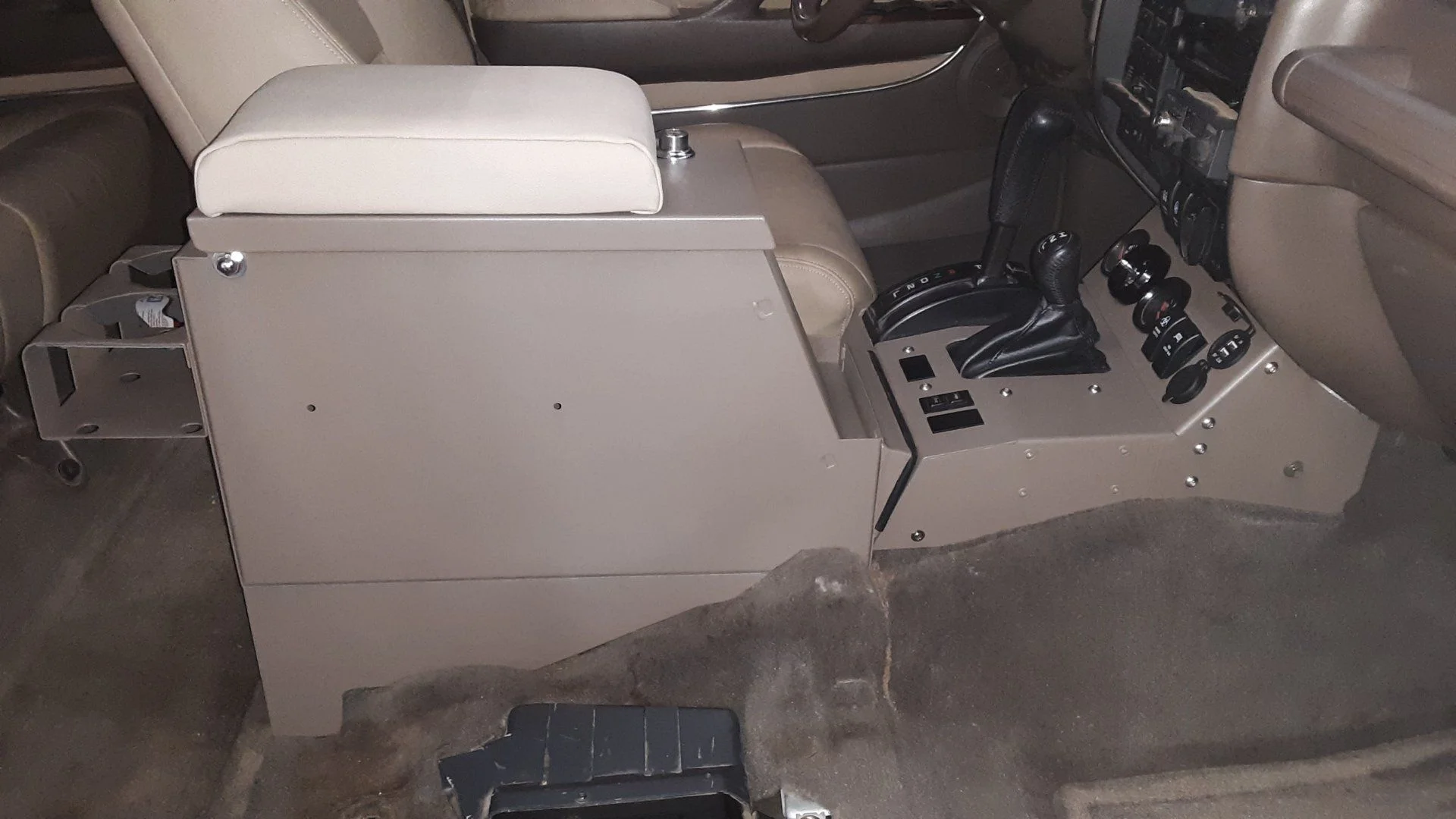

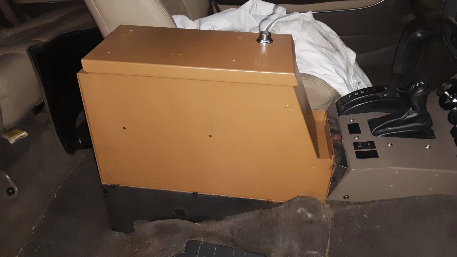

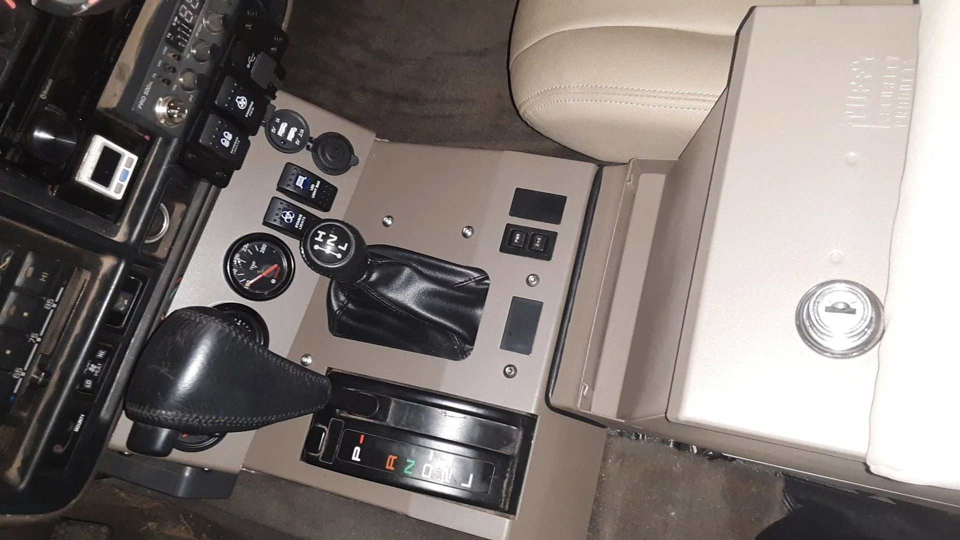

My solution was a Delta Vehicle Systems shifter console/ Tuffy Console hybrid. The Delta Vehicle Systems shifter console was pretty straight forward and fit well. The tan color option wasn’t a good match and the gauge panel was anodized black instead of being tan. I ended up sanding everything and painting them.

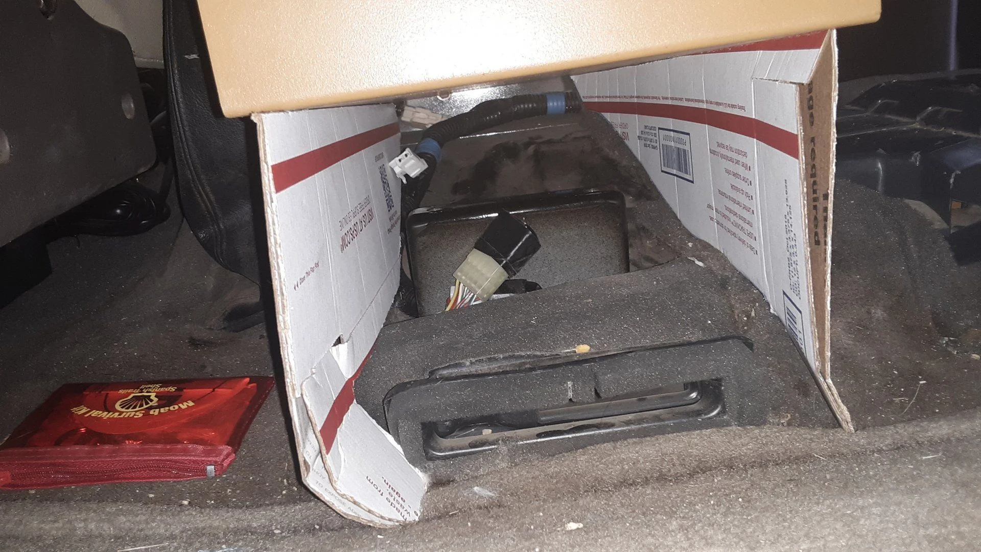

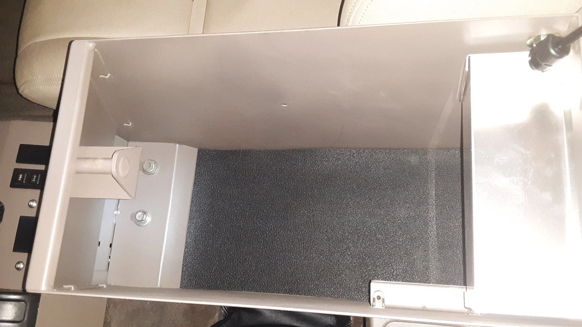

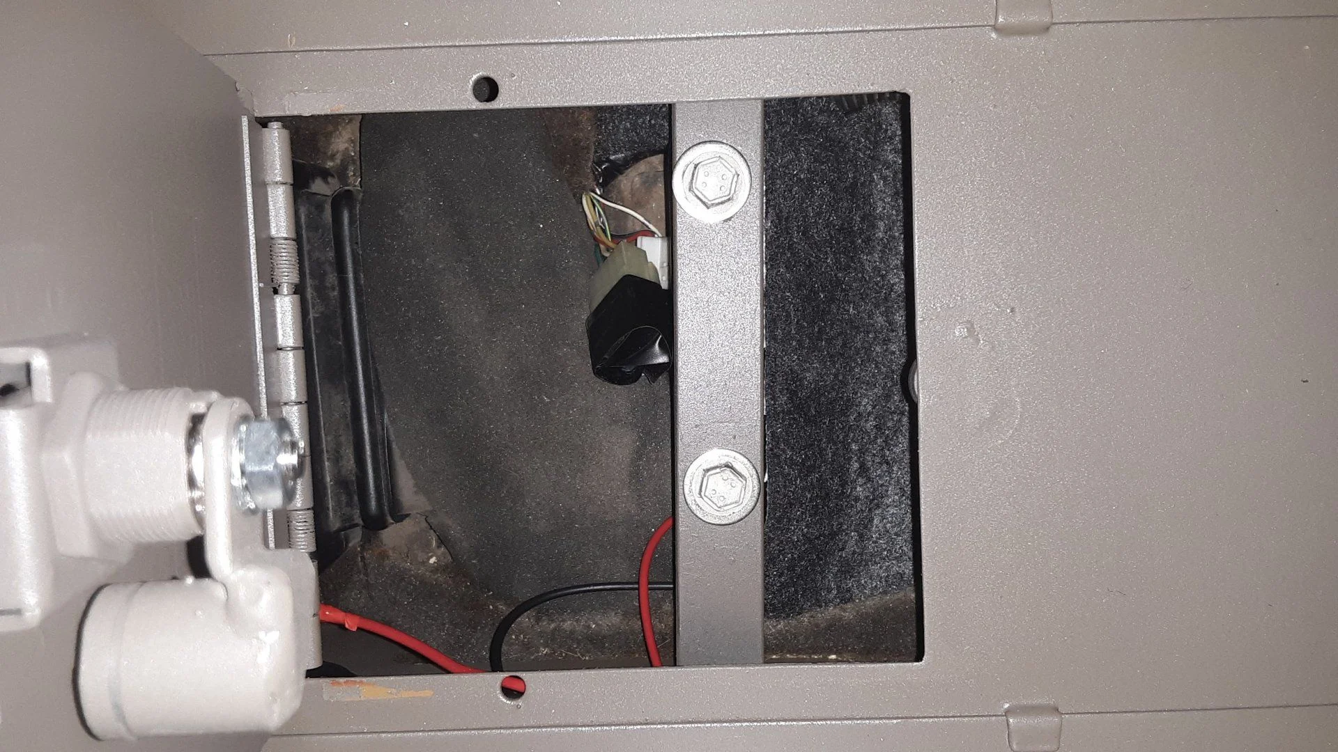

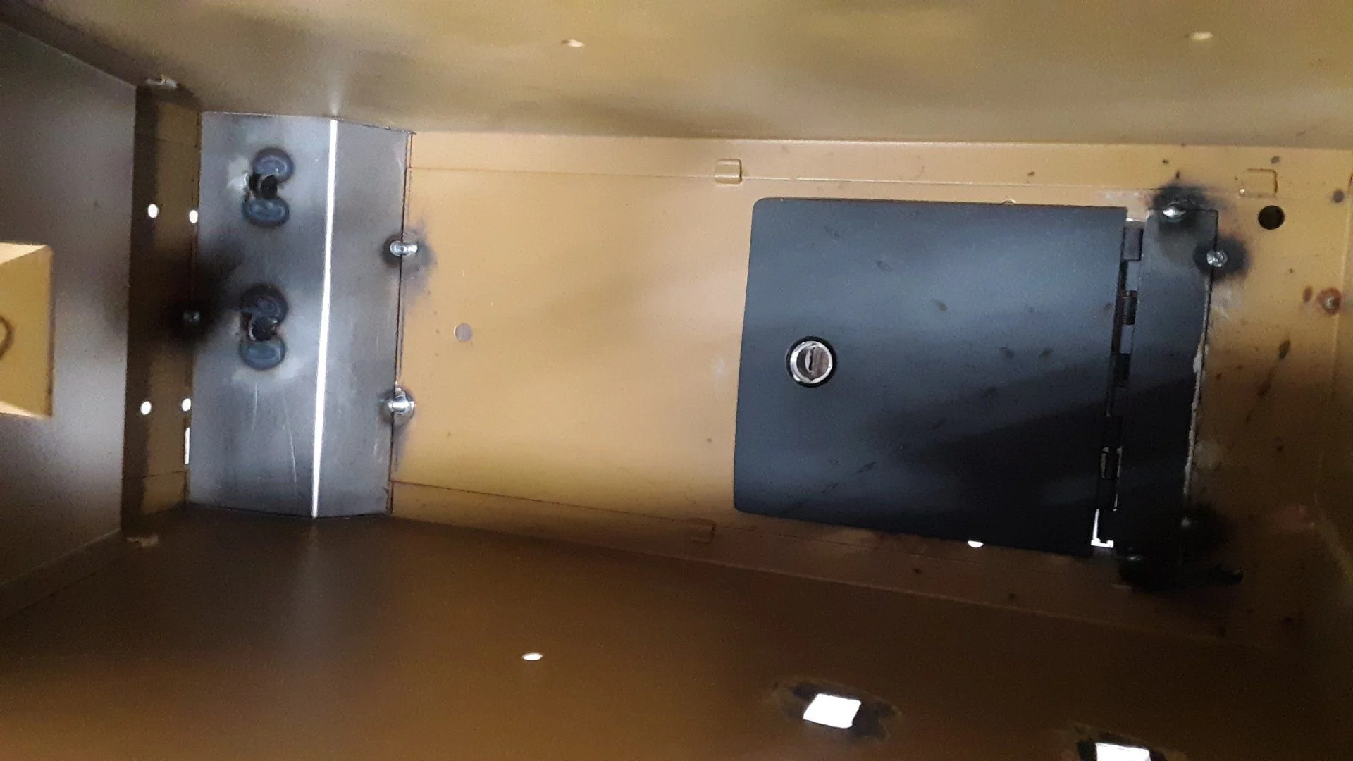

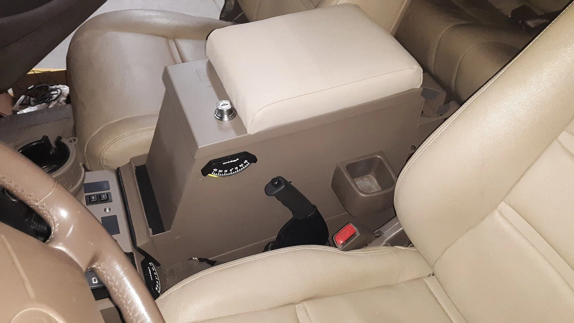

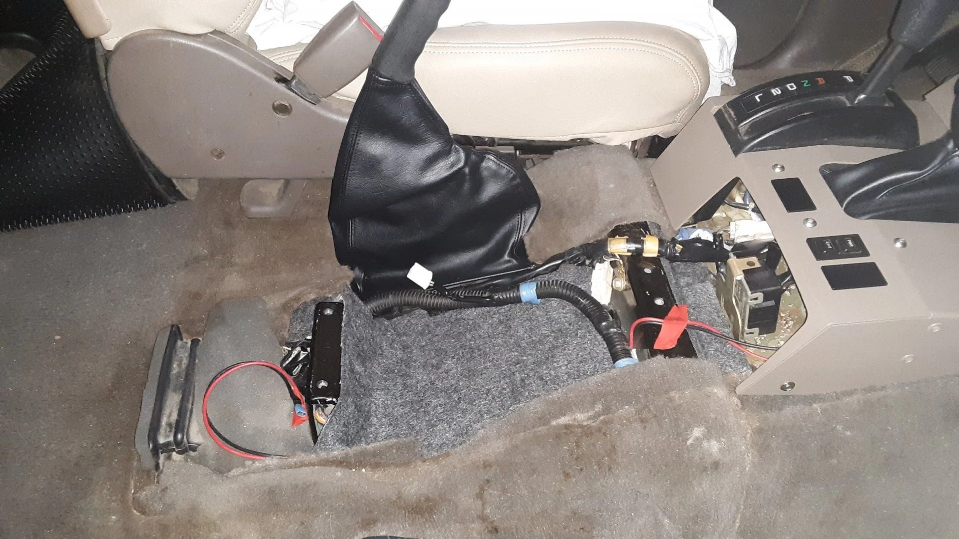

The Tuffy console was positioned as far forward as possible. It was notched to clear the body stiffener on the front and sheet metal skirting added to raise it up to a comfortable arm rest level. Slots were added to the rear skirt for rear heater vents. The rear cup holder was added with thumbscrews so it can be easily removed if necessary, this required welding nuts inside. Square holes were cut for adding the factory driver cupholder. The added skirting created a unique space under the console so I took my Wits End lock box that I no longer needed and cut the lid off. I then cut a hole in the bottom of the Tuffy and attach this hinged lid with Medco lock. This creates a second lockable storage space that is kind of secret and a surprisingly large area. Features were added so the box bolts in four locations using factory tapped holes in the body. A transition piece was welded to the front to make a smooth transition between the Tuffy and Delta consoles. The Tuffy armrest pad was removed and used as a master to cut and sew a new pad cover out of the Lseat leather. I am really happy with it and between the Tuffy, Delta shifter console, Wits End ashtray insert, and Wits End cubby insert I now have some clean storage, plenty of gauges/switches/USB/12V, and cell phone holder. I think that covers everything I did. Here are a bunch of photos showing the progression and end result.
