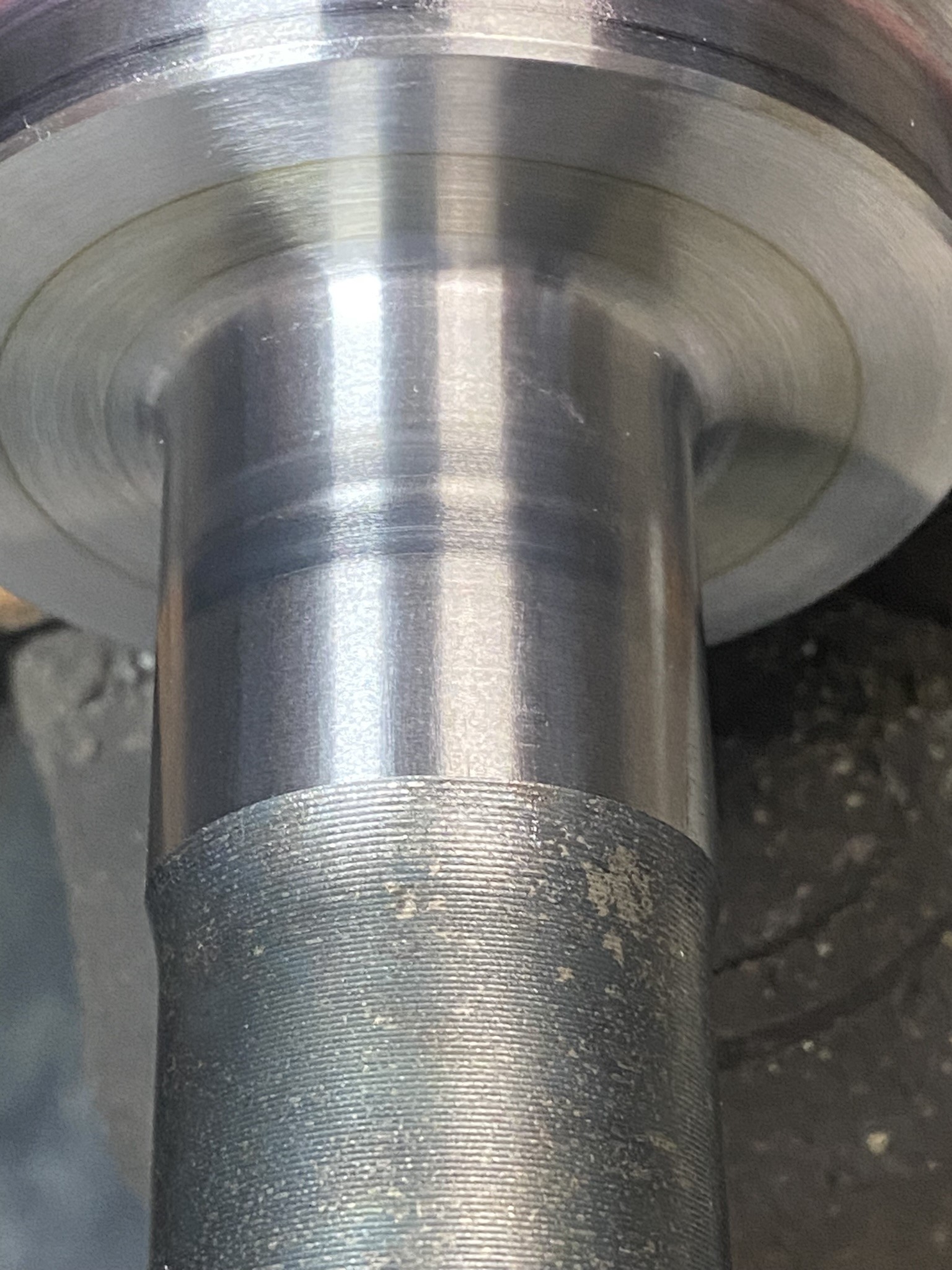

What was condition of needle bearings. Best clue is where the needle bearings ride on outer axle of FDS (AKA: cv)
This FDS axle had less than 2K miles on it. Needle bearing scored axle, unevenly. Notice the different and narrow bands of color variation. Replacing needle bearing illmated, the unusual rotational sounds.

This would reduce angle on FDS. If hub flange snap ring gap to wide, it may result in slight change where needle bearing, knuckle & FDS outer seal butt/rub and contact with brass bushing.
