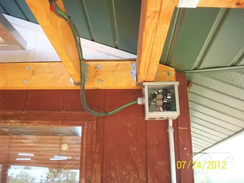

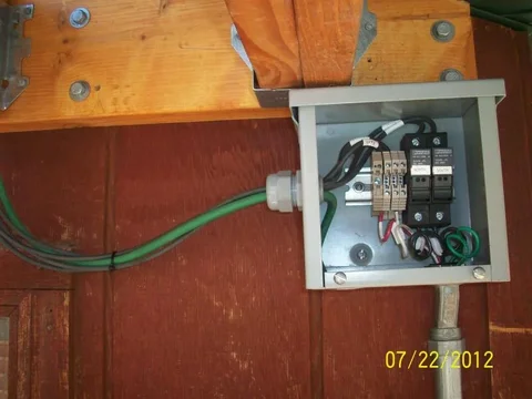

All DC wiring and ground come to this J box
Closeup of the J box. There are terminal blocks mounted on DIN rails:two fused and two non fused. NEC says that less than two strings doesn't require remote fused disconnects, the main disconnect at the inverter will suffice. I didn't have to put the fused terms here but it was convenient location for quickly disconnecting the strings to check something.
Typical #8AWG USE-2 ground wire scheme throughout the system

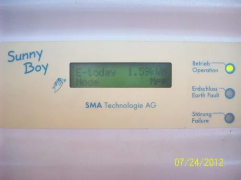

It's ALIVE.......
Well, the time finally came for me to "throw the switch"! I did this four days ago and maniacally started to chant in my Gene Wilder's voice "IT'S ALIVE".....
It's 9am so the South string hasn't reached a full Vpv= 375 vDC yet but can't complain of the power production
The all important number that we live/die by: KWH So far, South string has been producing about 12kwh/day. On my electric bill, we used approx 15kwh/day last month. When the North string is online, I should be able to make more than we use. :bounce:
Mpp = Maximum Power Point tracking. This is where the inverter is doing the most efficient conversion of power from DC to AC. You want to see Mpp as much as you can.
