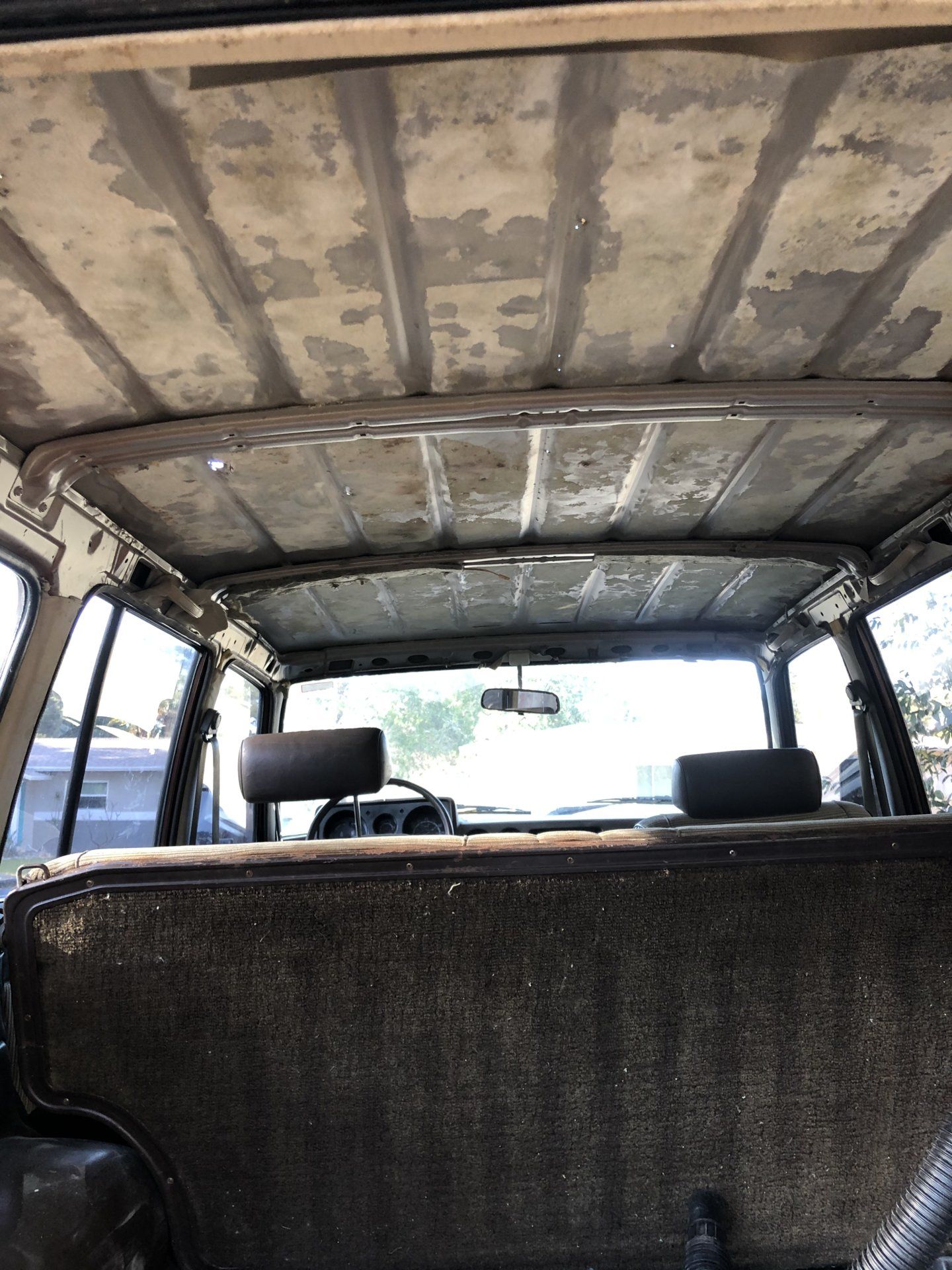

With this thinking, I've decided to go the DIY roof fix for now. I needed a new headliner anyway, and boy am I happy I decided to rip the old one off with no chance of salvage (it was torn up anyway). The roof damage was worst than I thought. No worries, I'm committed at this point and excited about the prospect of having a truck that doesn't leak anymore!

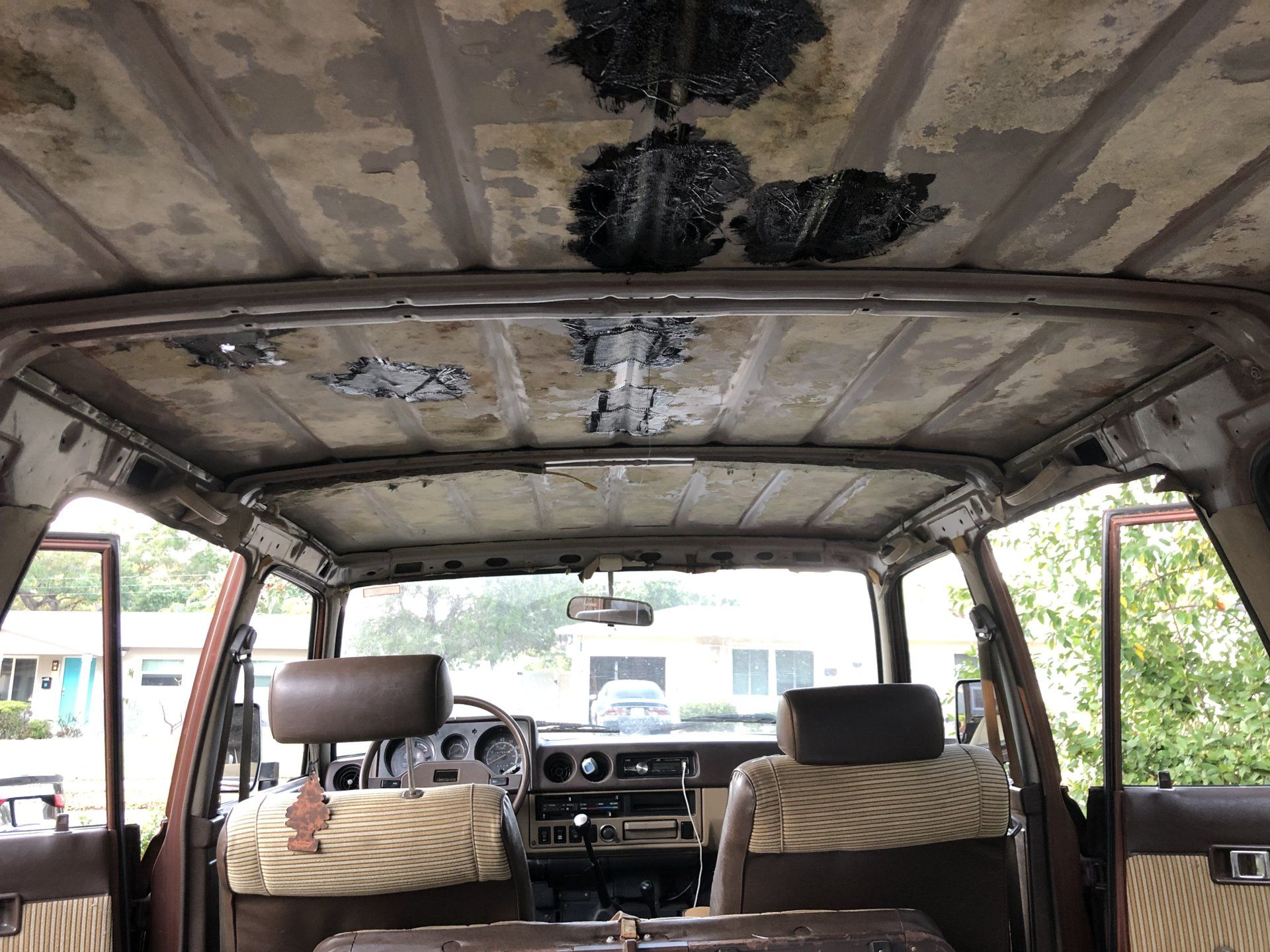

I sanded around the holes, even made a few larger by getting the loose rust off, and prepped the metal for a first coating of POR-15. This is my first time using this stuff. The plan is: 2 coats of fiberglass cloth and POR15 on the inside of the roof, then Bondo on the outside with either POR15 over it or some sort of sealant, open to suggestions.
If done well, this should stop the rust from spreading (lolll), but most important: Seal the truck up completely. I will still probably, at some point in the next decade replace the roof. But, in the interim, this should do it. Still not sure what im doing with the rain gutters, while I can fix the leaks, the aesthically demonic look of the gutters still exist. I've thought about grinding them off and sanding down the area. Not sure. Maybe I'll do that around everywhere minus the windows. But here's a list of the plans for it this week and then in the near future with the saved $3k. Also, before anyone gets wise and tells me to jump into a new one, i've already tried. The wife won't let me sell this monster and get another, rust free one. It's a losing battle with that woman.

My roof is in similar condition. It hasn't gotten much worse in the past couple years. So you can leave it for now. Get a used Mig welder and start practicing with some scrap sheetmetal
yup that might end up being the plan for the next few years. We shall see. I’m just excited to fix these holes and seal this bad boy up.
Welding and real repairs a can be lot easier without headliner in, so just something to be aware of down the line..I set fire to my headliner welding in a new roof patch :-)
I second this. I would add get a grinder. In the end your welds may not look the best, but as long as you have not punched through the metal, a welder some fiberglass filler (to fill in any pits) and some glazing putty and you will have a decent looking roof that does not leak.
Great tip for the amateur welder:
After welding if you have access to the panel behind, take a flashlight and look for pin holes you missed and weld them up.
I am a crappy welder, but have yet had a panel fall off.

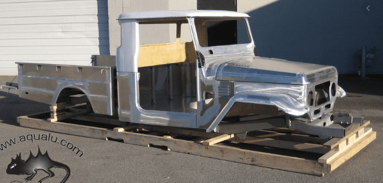

That is one charismatic narrator. Though an all aluminum body would solve alot of problems.
it worth having a look at Land Cruiser to see all the possibilities. I did price out a frame and body to build a 45 series with a 6" longer cab and it added up around $14,000 before shipping. So a full proper build that way could easily hit the $40k to $50k if you do all the work. But I'd like to build a 45 cab on an 80 chassis and mostly need the cab....hard to find a steel cab in the USA. All dream thoughts now anyways

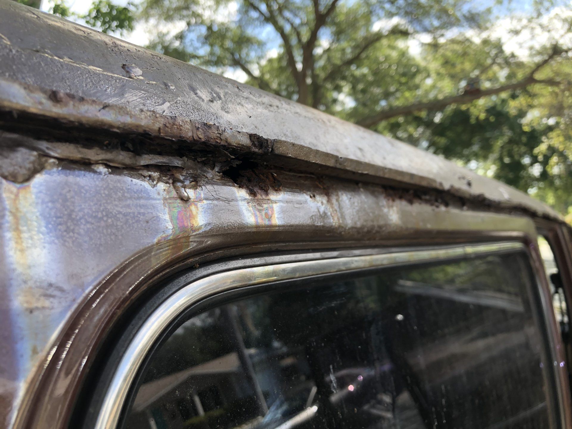

Outside of the roof it’s just the inner wheel well which I’m taking care of now. Seems the rust started in the rain gutter, shocking. Poor design originally, seems like it’s obvious it’s the culprit for a lot of the rust issues.
Anyone have ideas on the rain gutter? Mines pretty bad, not sure if I should wire wheel it off and sand down or what? Open to all ideas

Ya running out to grab a grinder now. It’s remarkable, using a set of pliers and hardly any strength and that gutter just crippled. Think I’m going to cut it off, patch the holes and call it a day.
