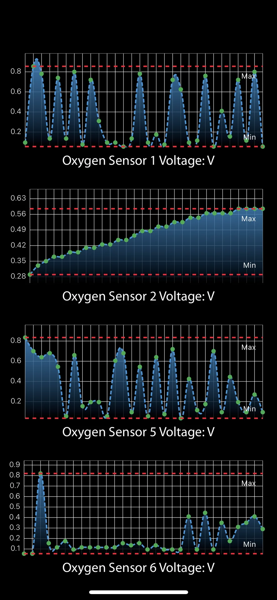

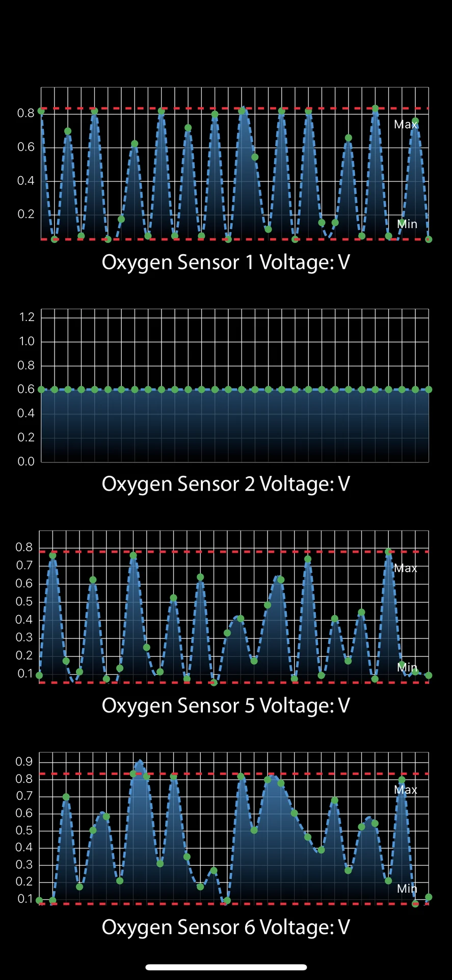

I have an update on the O2 sensor issue! And I don't know if it's good or bad. My OBD2 reader is a Fixd, and when it scanned and gave me the code P0136, that's already been covered in this thread. When Fixd scans your car, it'll give some info about the code, it described it as a downstream sensor malfunction in both bank 1 and bank 2 at separate points in the article. I did some research and it seems like everyone says bank 1 (driver's side), so I replaced that O2 sensor with a brand-new Denso and cleared the code. I've only idled it for maybe 10 minutes, but enough to look at some live diagnostics from the Fixd. You can see the O2 sensor voltage results below.
As you can see "one of these things is not like the other". O2 sensor 2 "warmed up" (first pic) and then stayed incredibly steady at about 0.6V (second pic). So I don't think this fixed the problem although I forgot to look at the data before I swapped them, so it may be different. I haven't had the CEL come on yet, but I expect it to. Certain websites say that the downstream O2 sensors should flatten out, but I think that's after the cat warms up.
If anyone has any advice, please let me know. The electronics of this car scare the sh*t out of me, but I ought to learn at some point.
A little update; I ran the live data tool and drove the car around my block a couple of times. The Sensor 2 values did change and did so accordingly (voltage increased when I stepped on the throttle and decreased when I lifted). It's just weirdly smooth compared to the other sensors. Now I'm wondering if there's another sensor that's supposed to be reading smoothly and isn't. As usual, any input is greatly appreciated!
