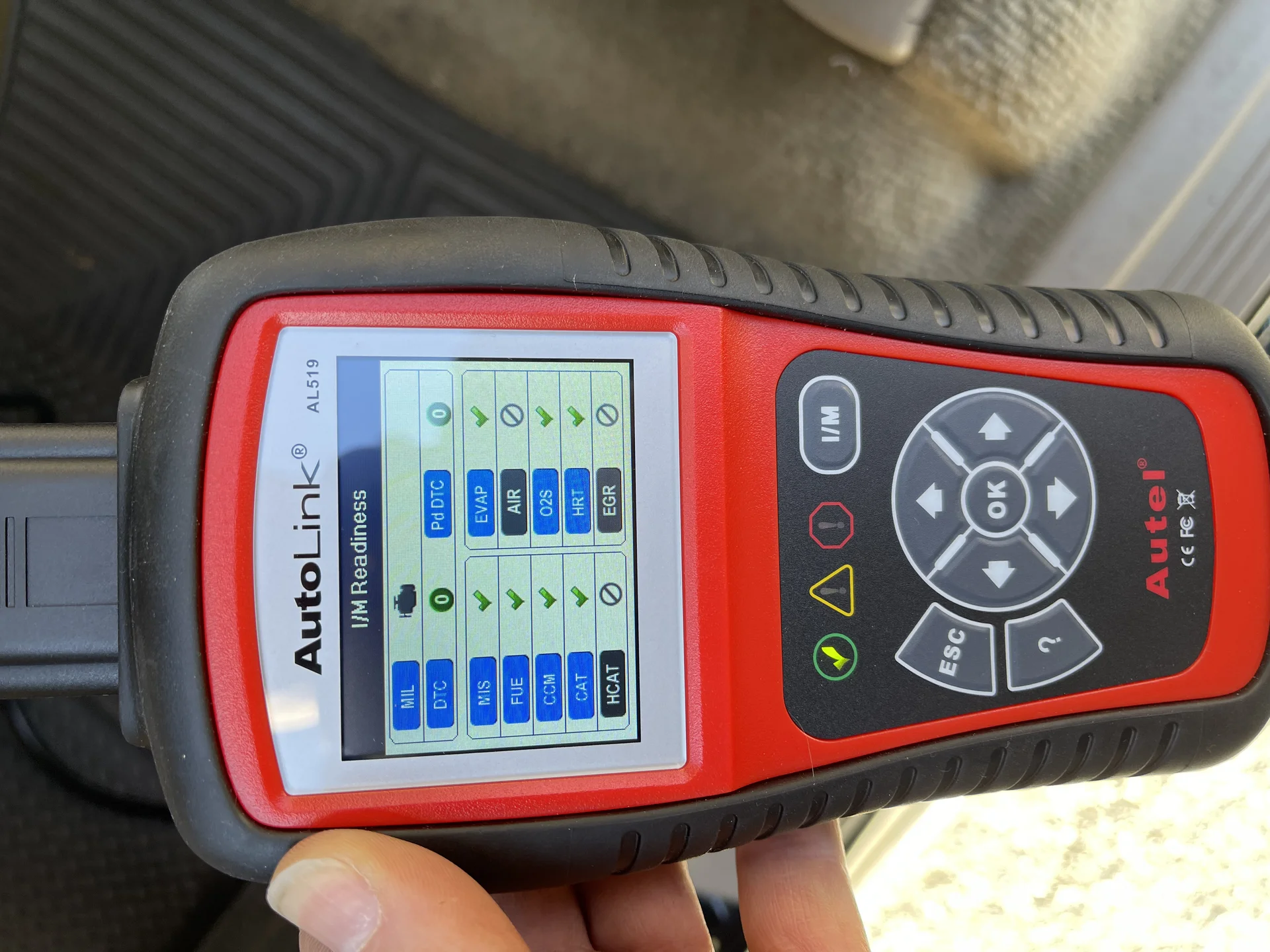

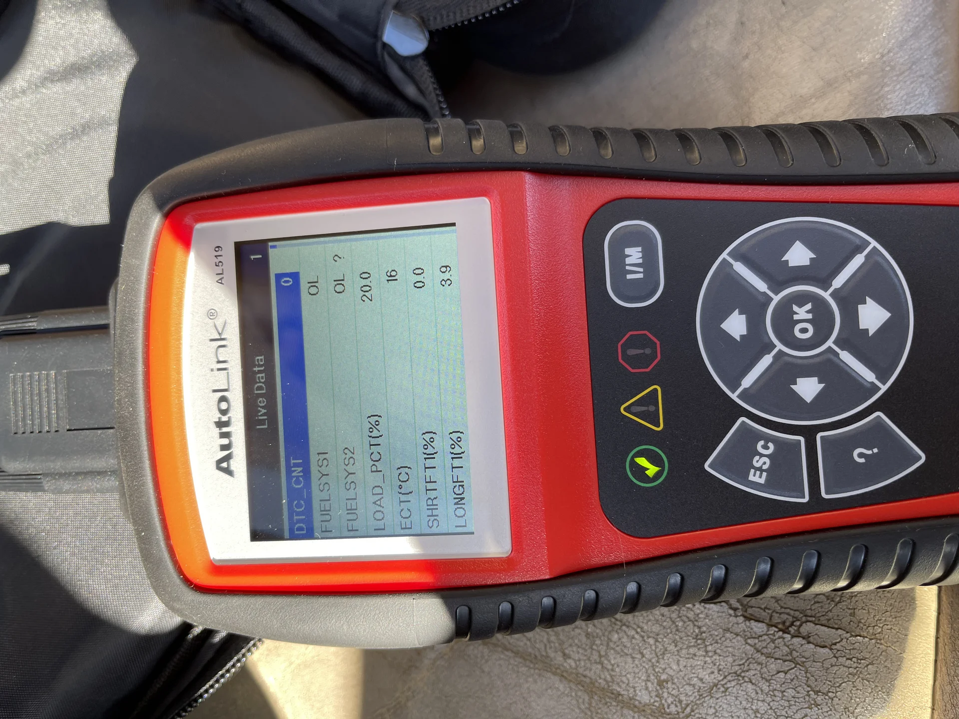

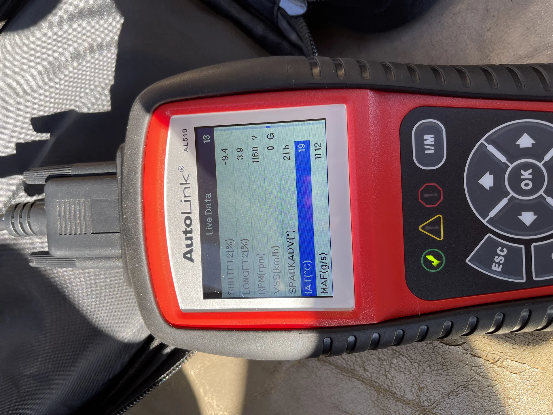

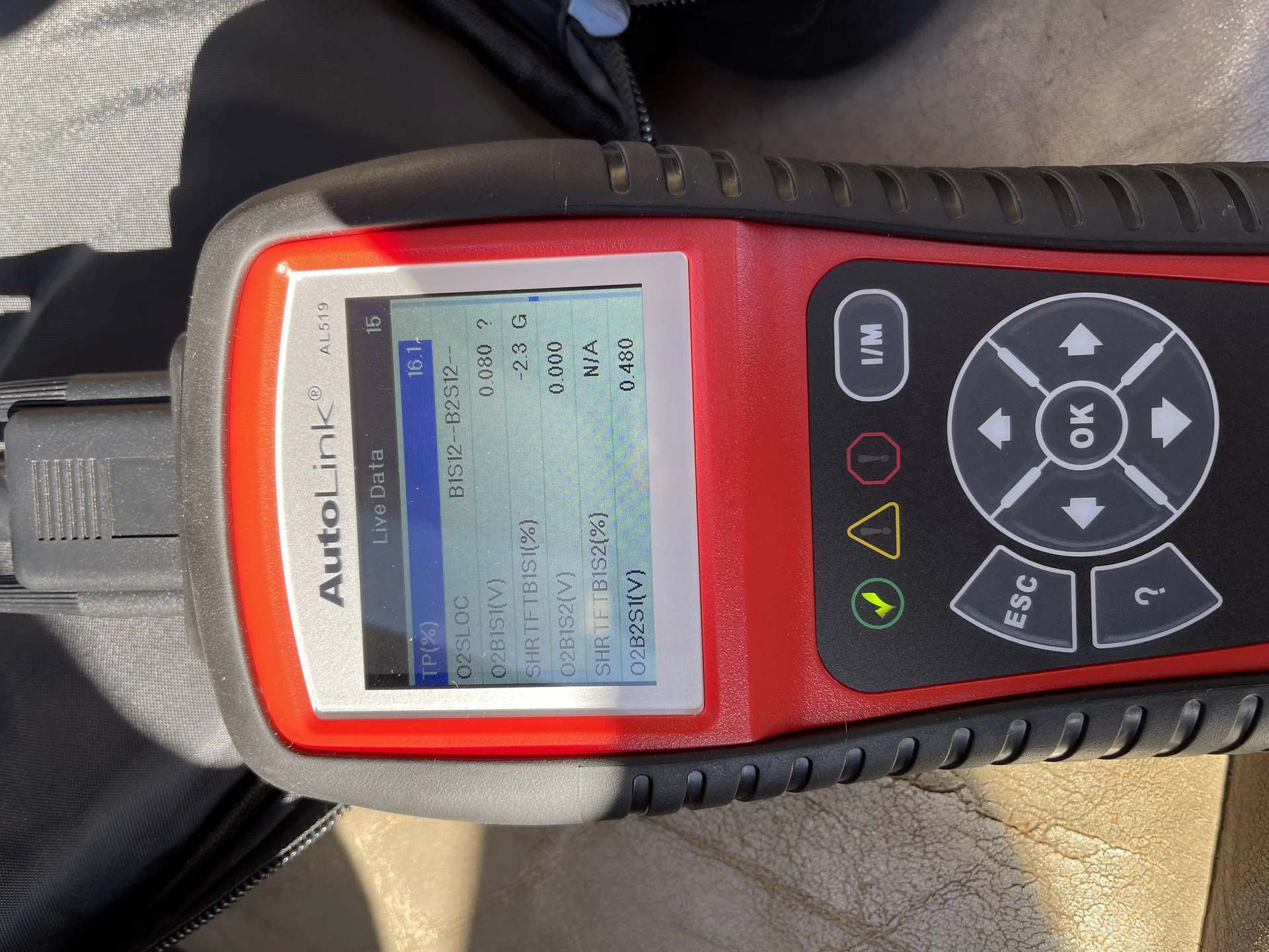

I'd be hooked to tech stream, scanning for DTC confirmed or pending.
I'd watch crank speed/RPM through tech stream.

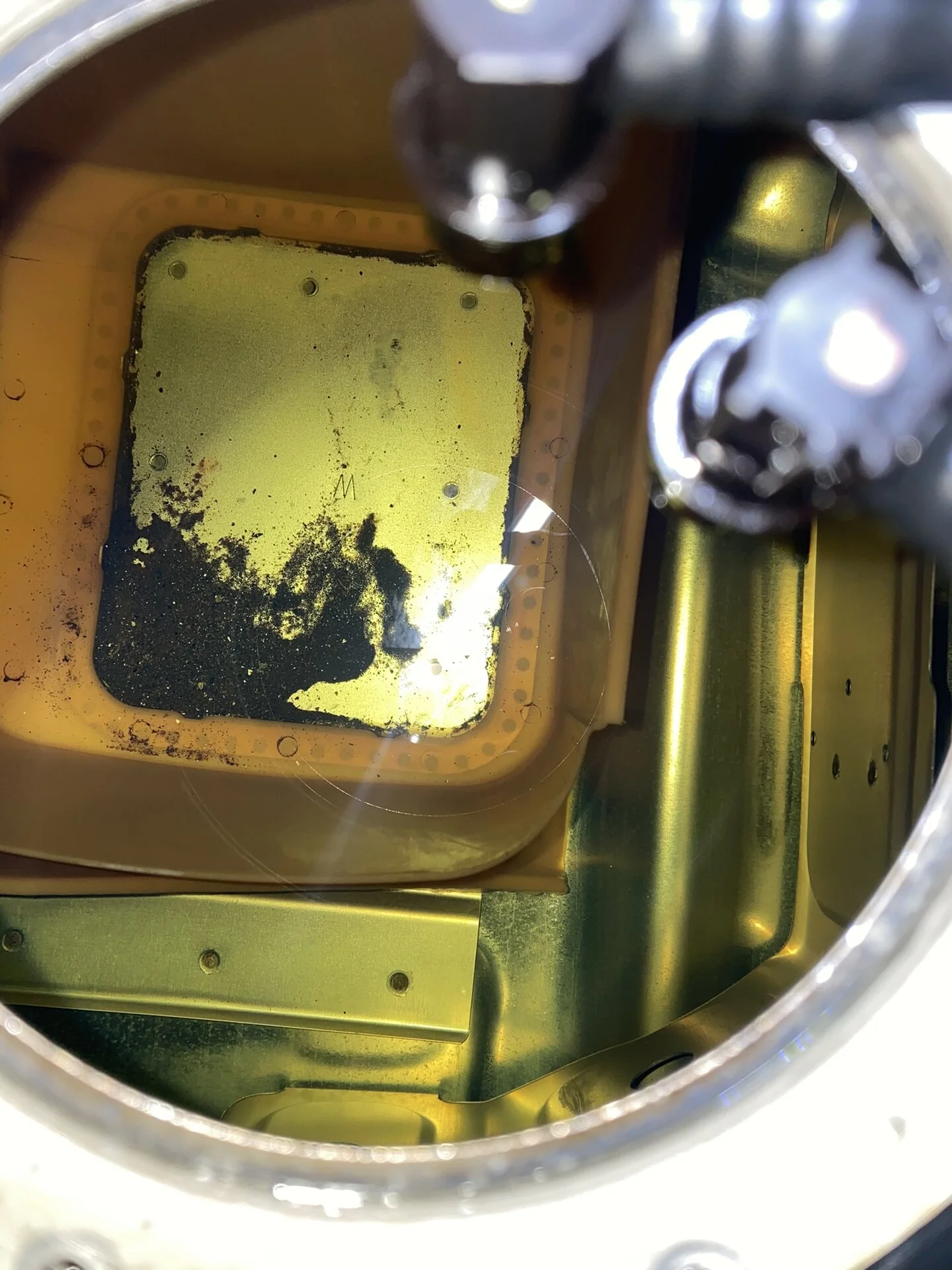

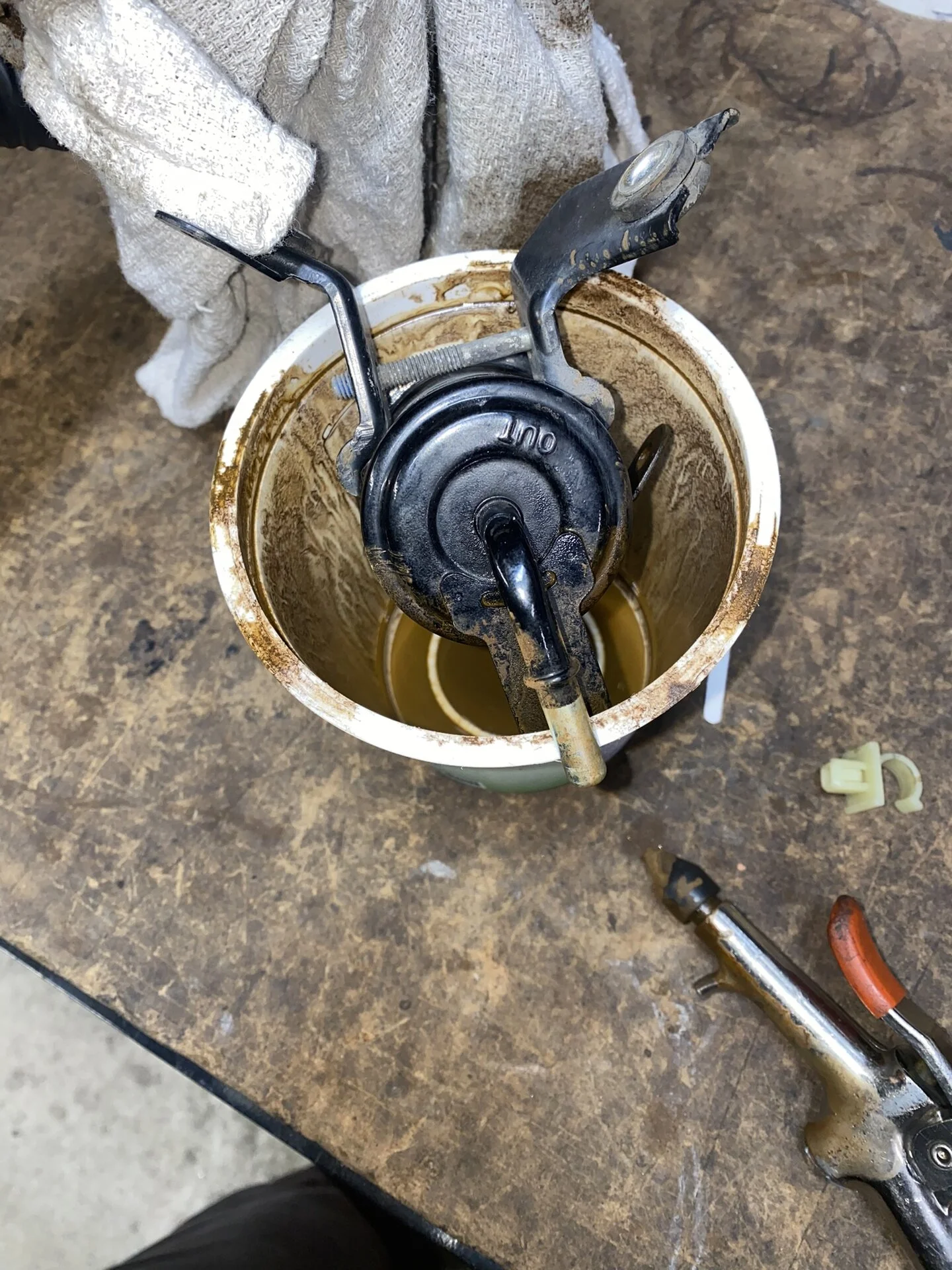

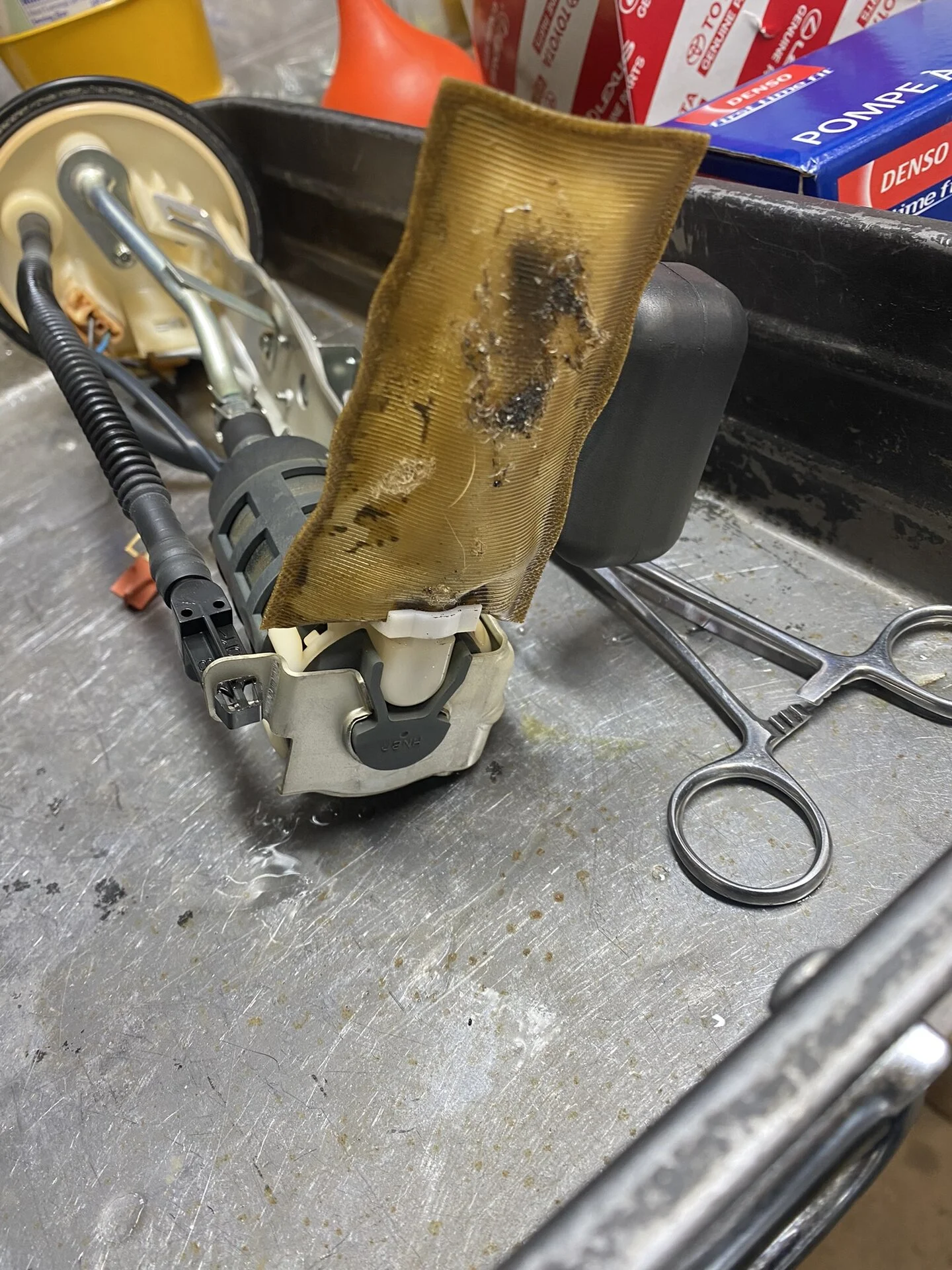

This came for 06LZ 250K miles. Started okay. But Long Term Fuel Trim (LTFT), hung around 7% , which is not great. Issue was not fuel pressure, but fuel flow restriction.
After vacuuming fuel tank, R&R fuel pump and filter. LTFT a respectful ~3% now.

I'd take test drive while monitoring: data, of which include Fuel trims & Engine Coolant Temp.

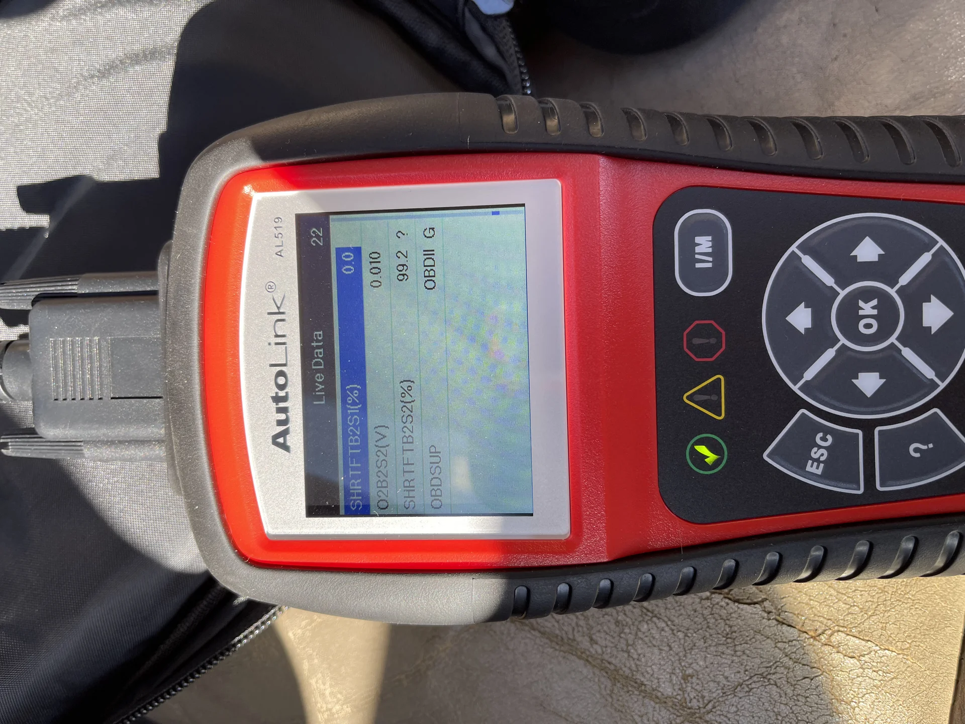

The pictures of my scanner were taken right after a cold start. About a 40 degree day. Also, the symptom disappeared on me again.

I posted my scan results from my OBD scanner, and all looks clear.

For anyone who has a scan tool, and does not know anything about what to determine from its values, this is an excellent video. You can get an idea of what values to look for when OBD scanning your LX470. The vehicle Scotty uses in his video is a 1998 Lexus LX470 with over 310k miles. Scotty goes over the different fuel trim values, MAF, etc. It's a great cheat sheet.

I notice the recent MAF (g/s) reading I took is 11.12, which is HIGH compared to the reading in Scotty's video, and one of the first suggestions of things for me to check by member @2001LC
