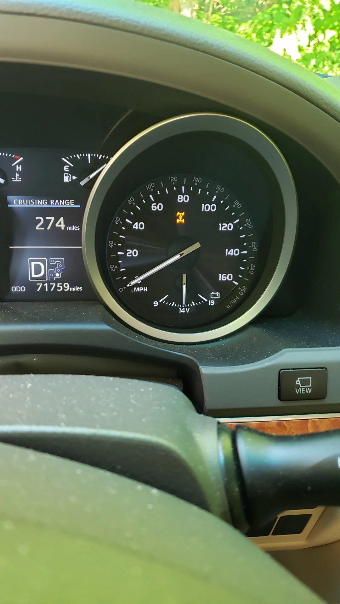

What does this light tell me? I cut it off and back on and the light goes out. Thanks in advance. RB PS i did look in my OM and could not find this particular light.
Well that doesn't look like a 100 series dash... Center diff lock light
Indicates center diff lock. If it is flashing, it is an issue with the lock/unlock process. If it is solid, the diff is locked.
There are other threads about the diff lock light flashing at odd times (meaning without purposefully trying to activate the diff lock) with no particular consequences. You can find info about it with a search. That light is definitely in the owners manual and the symbol is on the diff lock switch.
