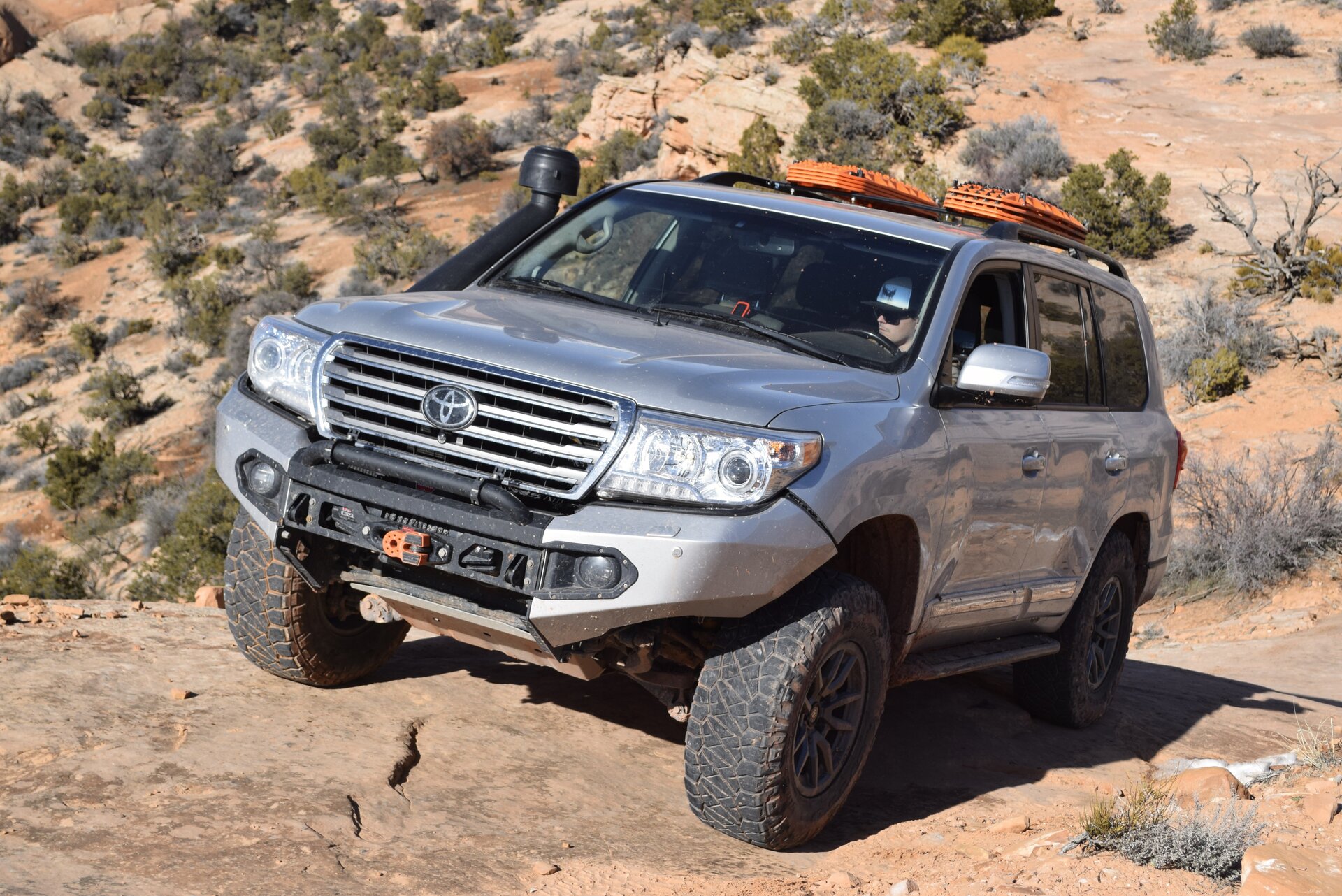

I have this pre cleaner and have been really happy with the dust performance. I recently had an oil and fluids service at a shop known for replacing every little thing, and they noted my air filter looked brand new - even though I had recently completed 2 multi day wheeling trips.
A couple things observations - the pre cleaner makes a bit of intake noise because it spins, so when the window is rolled down it’s noticeable. It seems mpg dropped slightly over the ARB snorkel head - maybe 0.5-1 mpg. Overall the benefits outweigh the downsides if actually used for dusty environments. I only use the Land Cruiser for off road trips, so for me it’s worth it.

I experienced first hand the benefit of running the Sy-Klone. Last summer my buddy and I did the Dempster and a bunch of remote travel in Alaska. We both run the Safari snorkel. I have the pre-cleaner and he is running the stock scoop.
We both started the trip with brand new air filters. After we had completed the Dempster and were about half way through doing Top of the World, his truck started to lose power. We stopped to check things out and opened the airbox. His filter was absolutely packed solid with dirt. Thought it would be good to check mine and found that it looked nearly brand new. We cleaned his the best we could and bought a new one in Palmer. He added the pre-cleaner after getting back from trip. :)
That experience sold me on the absolute benefit of the pre-cleaner.

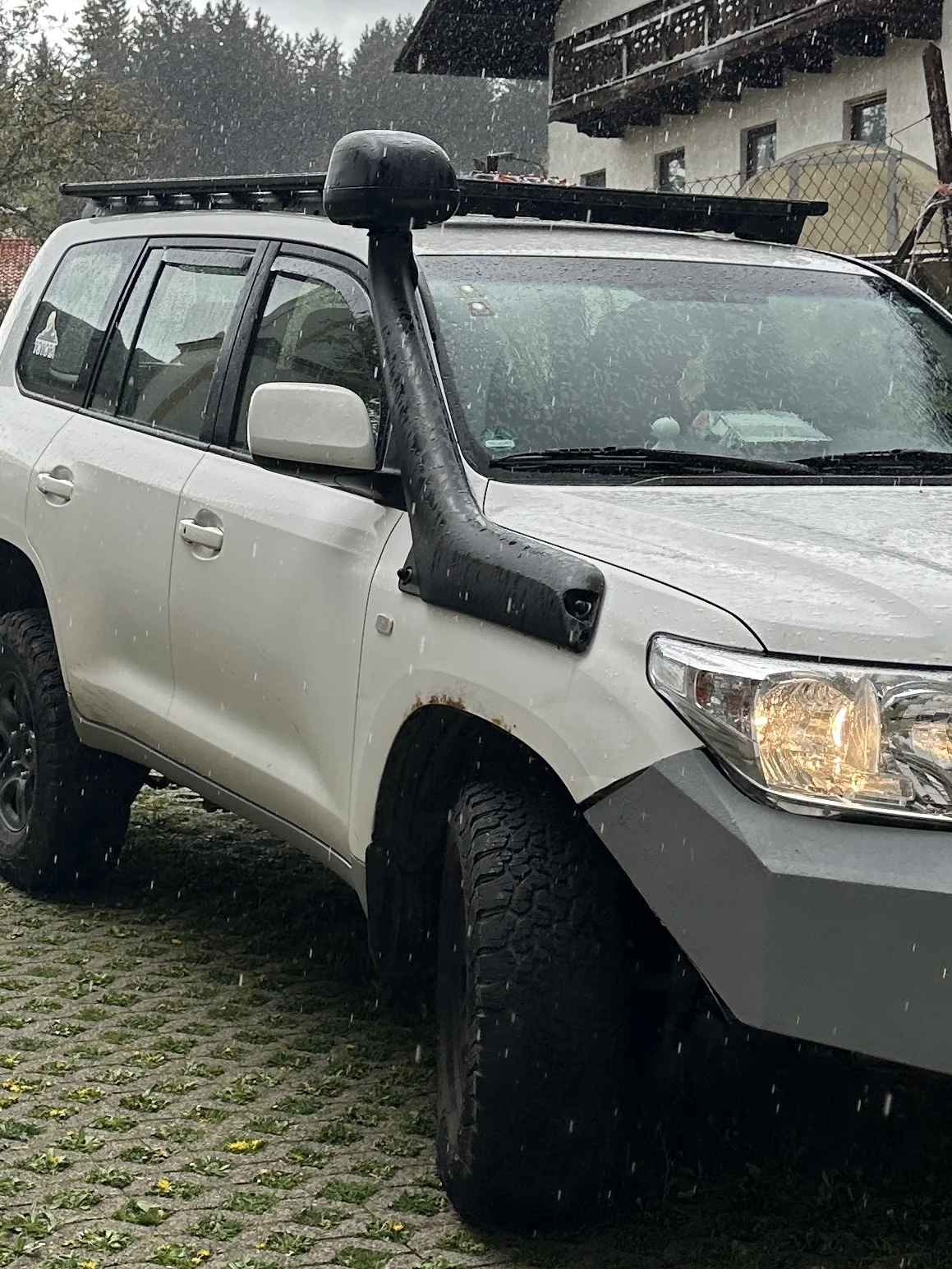

I am running the oem snorkel with the cyclone mushroom on my 200.
So in my case it wasn’t something I choose since he came with that one in the trunk so for sure I mounted it.
Even on dusty and sandy trips (wich for sure are rare where I live hehe) there isn’t much dirt in the air box
But it charms the classic UN/NGO/Dark Africa- style of the 200 GX

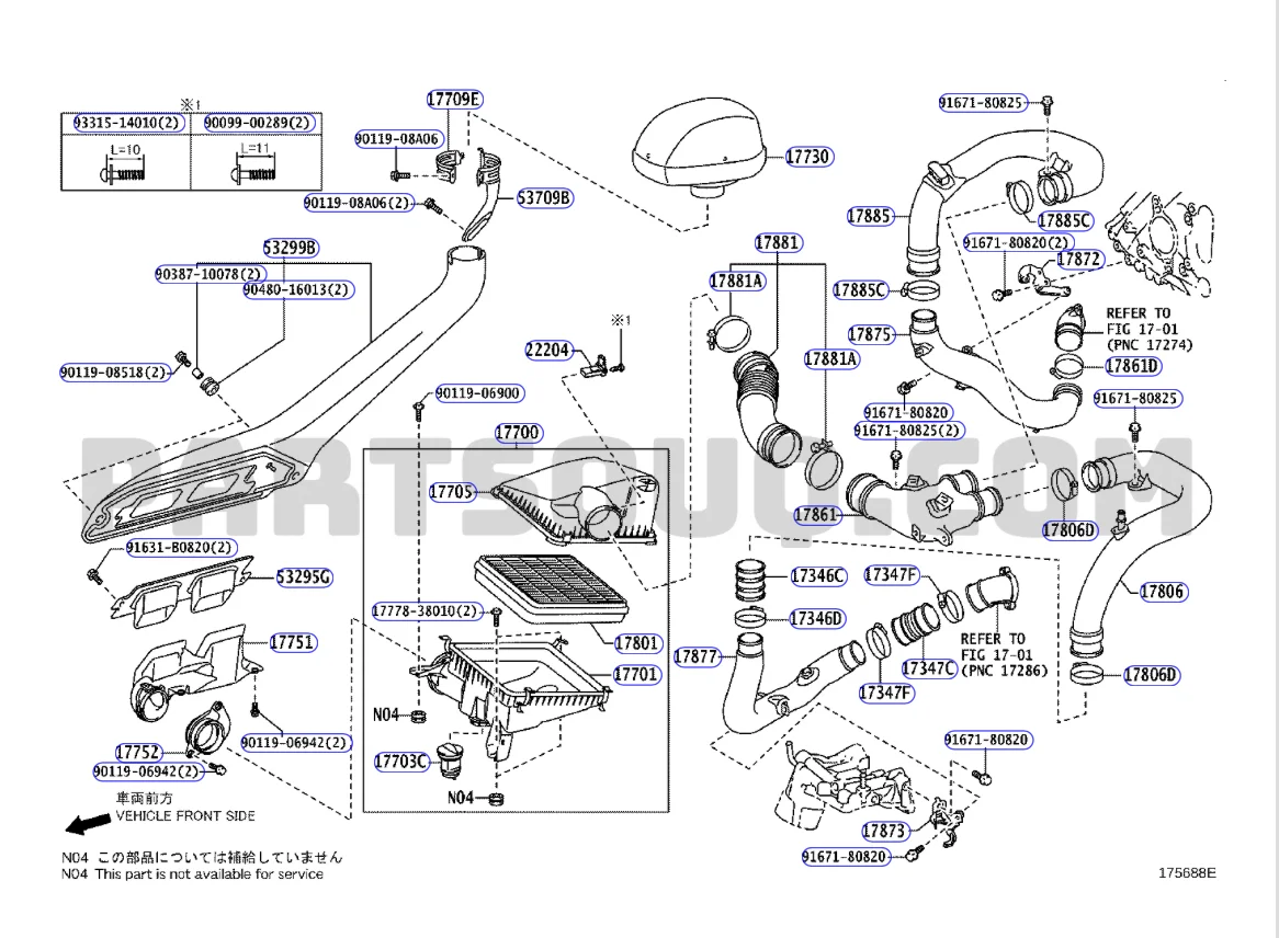

are you able to get me a part number for the oem snorkel?
Here you can see the parts. Probably you need to get the stuff down till 17752. For the diesel engines it should fit directly like a charm but for gasoline you maybe need to retrofit a bit since I don’t know where and how the airbox is located at these.
Air cleaner Partsouq
