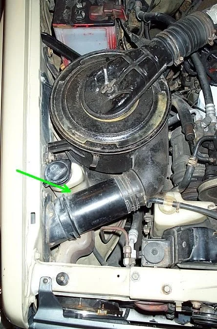

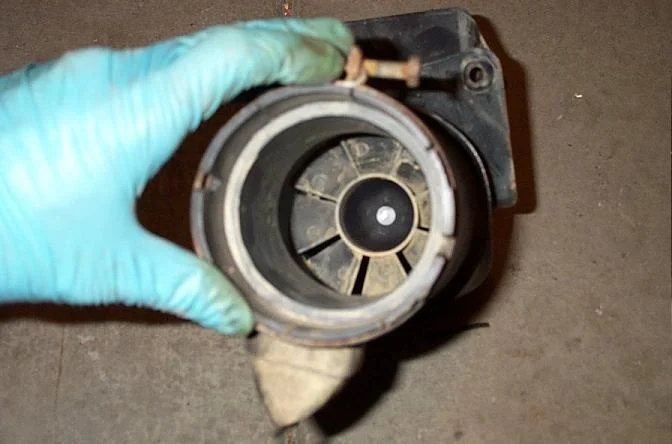

Sorry to steal the thread, Zachary, but talking about cyclonic air filters, I found a cool feature Toyota puts into some cruisers. There is a cyclonic precleaner built into the air ducting to the air filter. The duct that looks like an innocent piece of tubing until you remove it. Thee is a rubber bladder underneath the tubing to allow dust to collect.

Hey....what's a Hiclone doing in a LC? :D
Ya, those are cool eh. I've noticed a few too. Some that tuck into the fender I've noticed have the spinner right before a large catch basin, with valve on the bottom to release water. I suppose to spin out dust/dirt and perhaps small amounts of water.
ZRotheohv, I am not familure with the air can in your truck, however we have two HJ61's we are parting out right now. They will have the baffle in the can that directs the air, and the dust bowl attached to the bottom. I replaced my Cdn spec BJ60 can with one from an HJ61 and it was bolt in.
