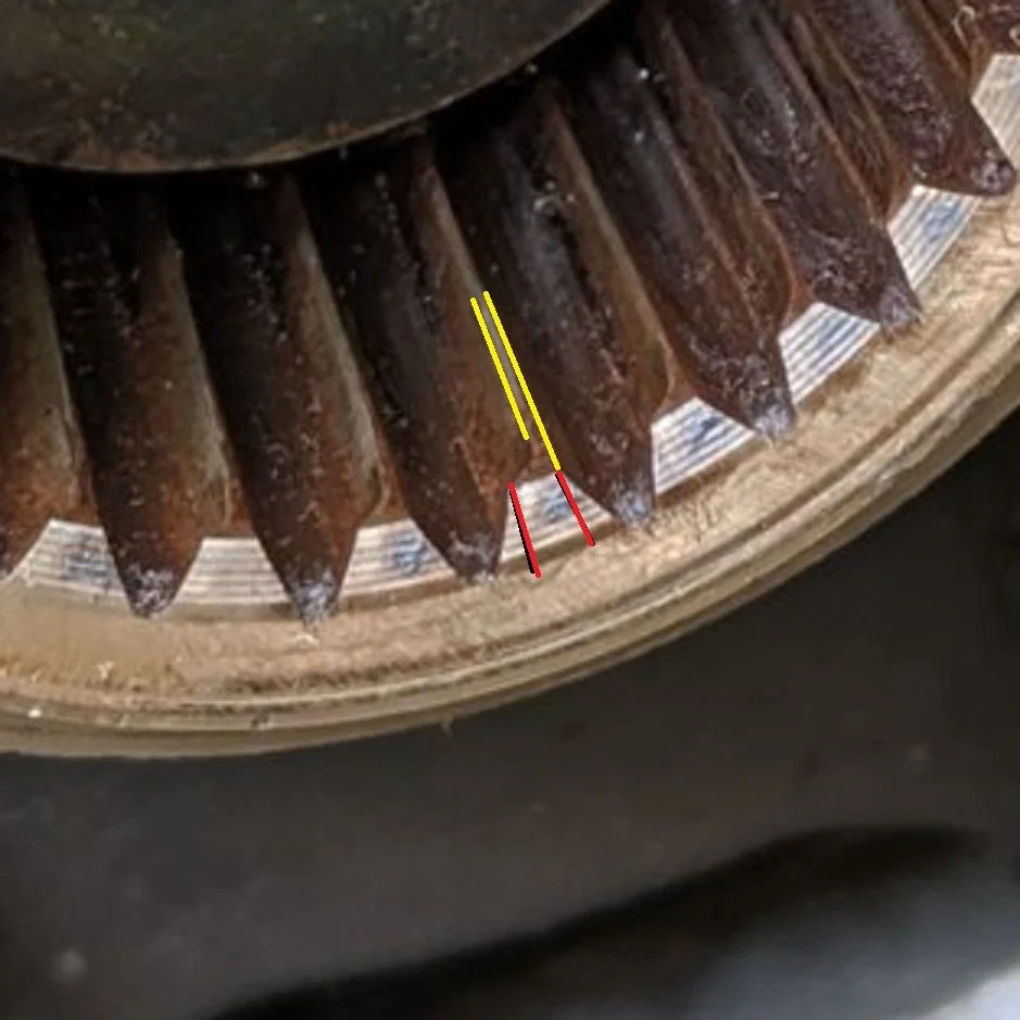

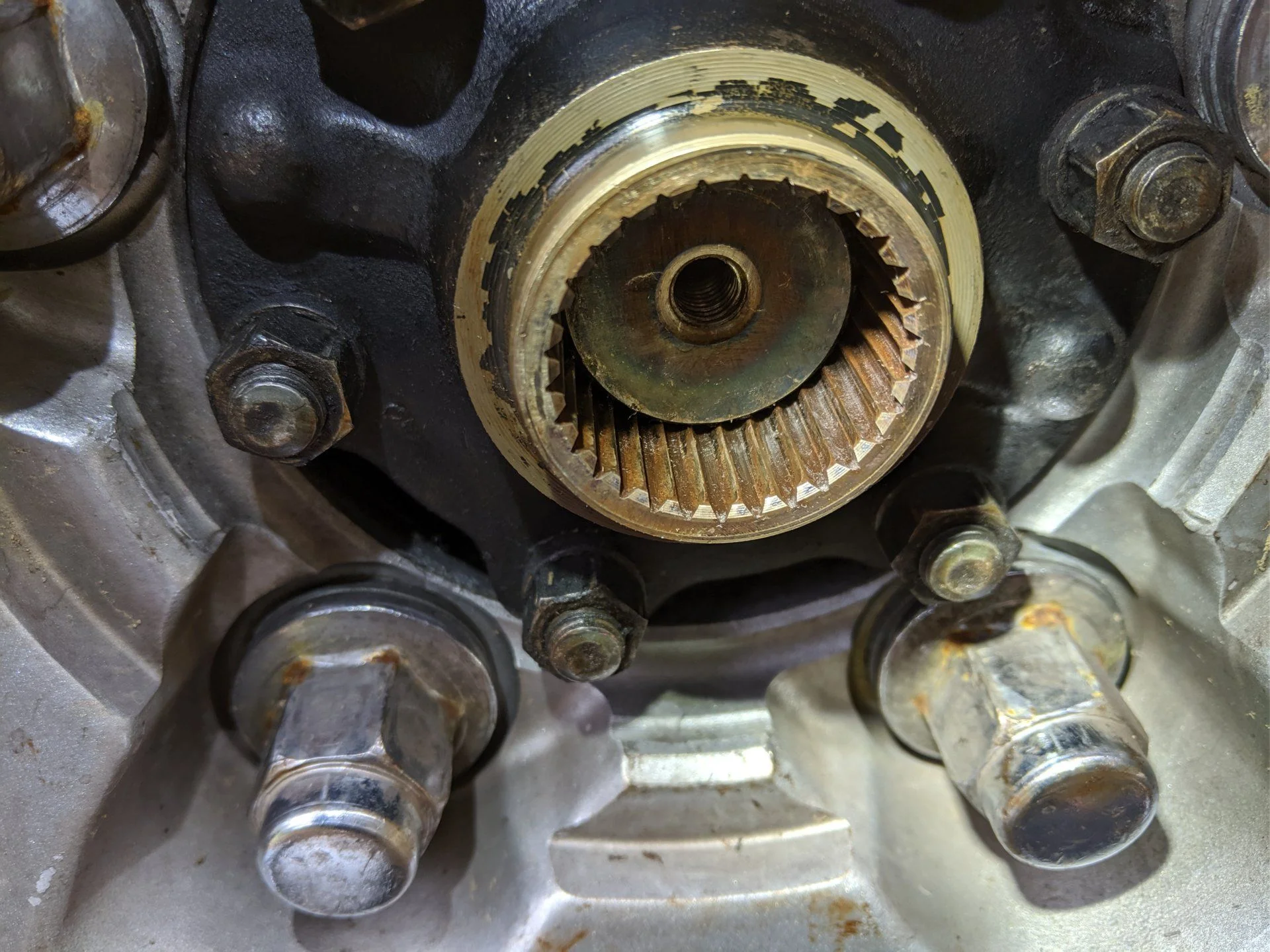

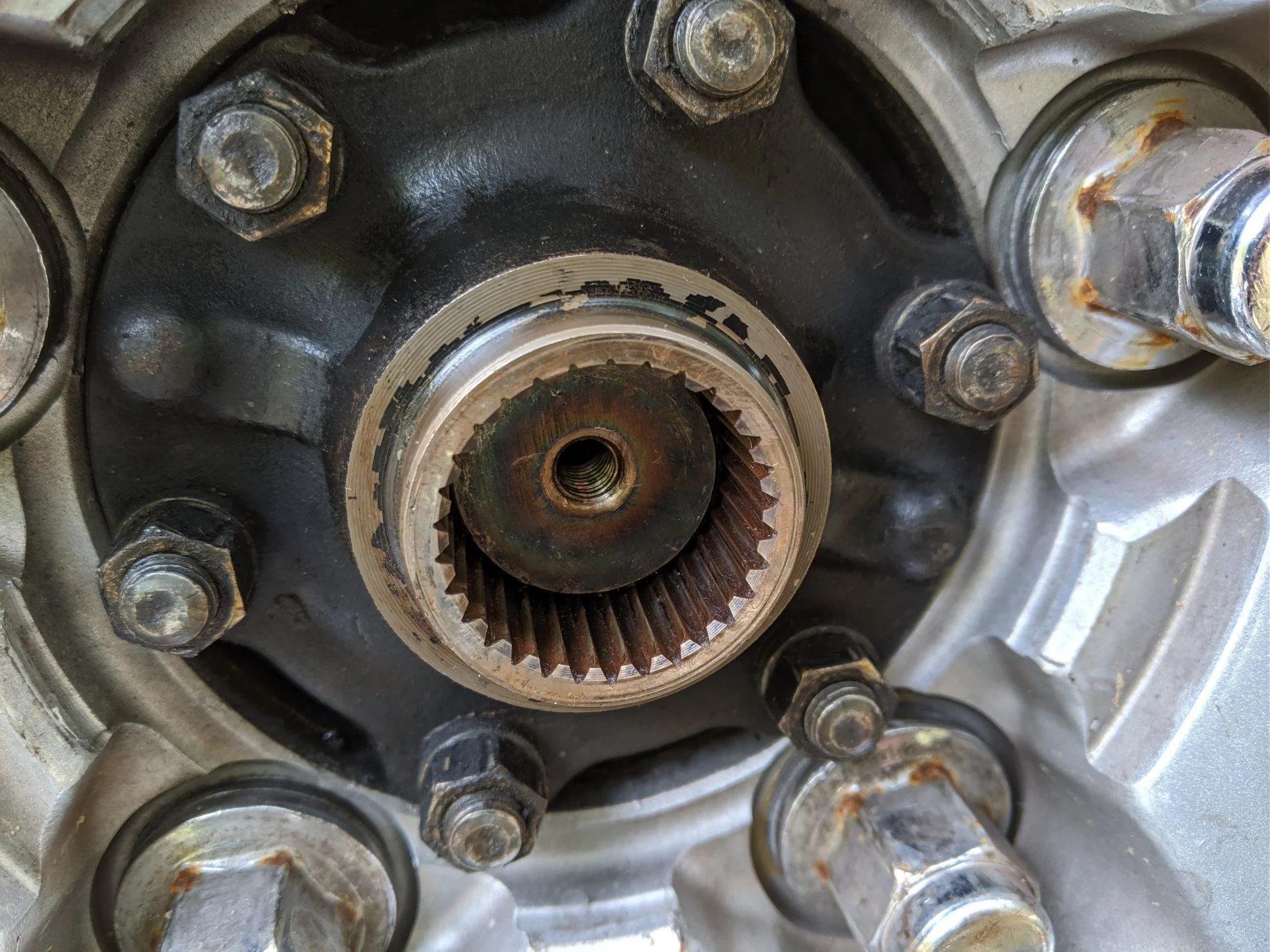

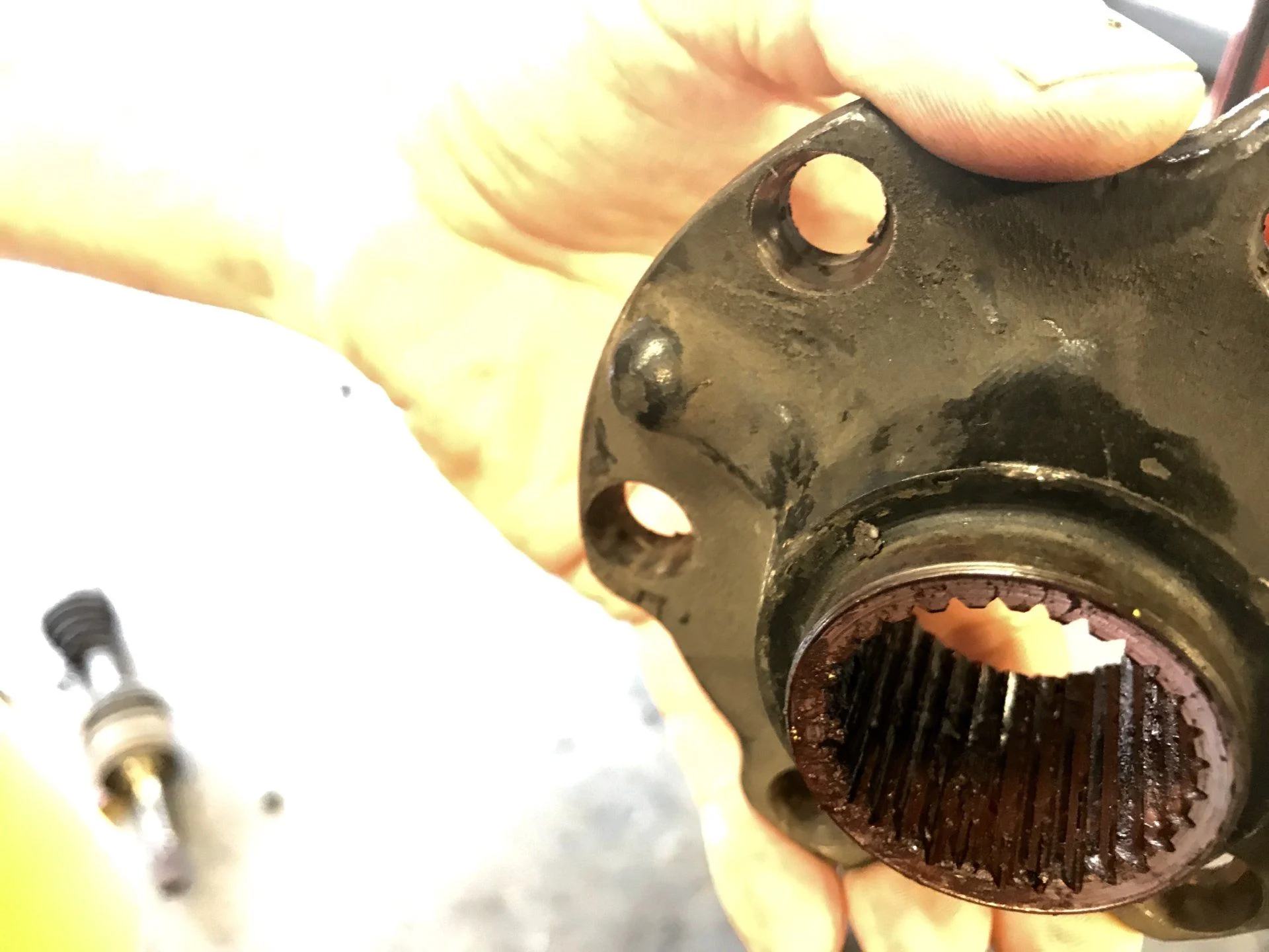

I have a clunk and can turn the CVs a little bit by hand. I pulled the caps off and checked the gap and there is play and I need a 2.8mm snap ring. I pushed the CV's in with the snap ring off to check the hub flange. The groves on the threads look sharp and not worn out. Grease was brown rust colored, but otherwise clean.

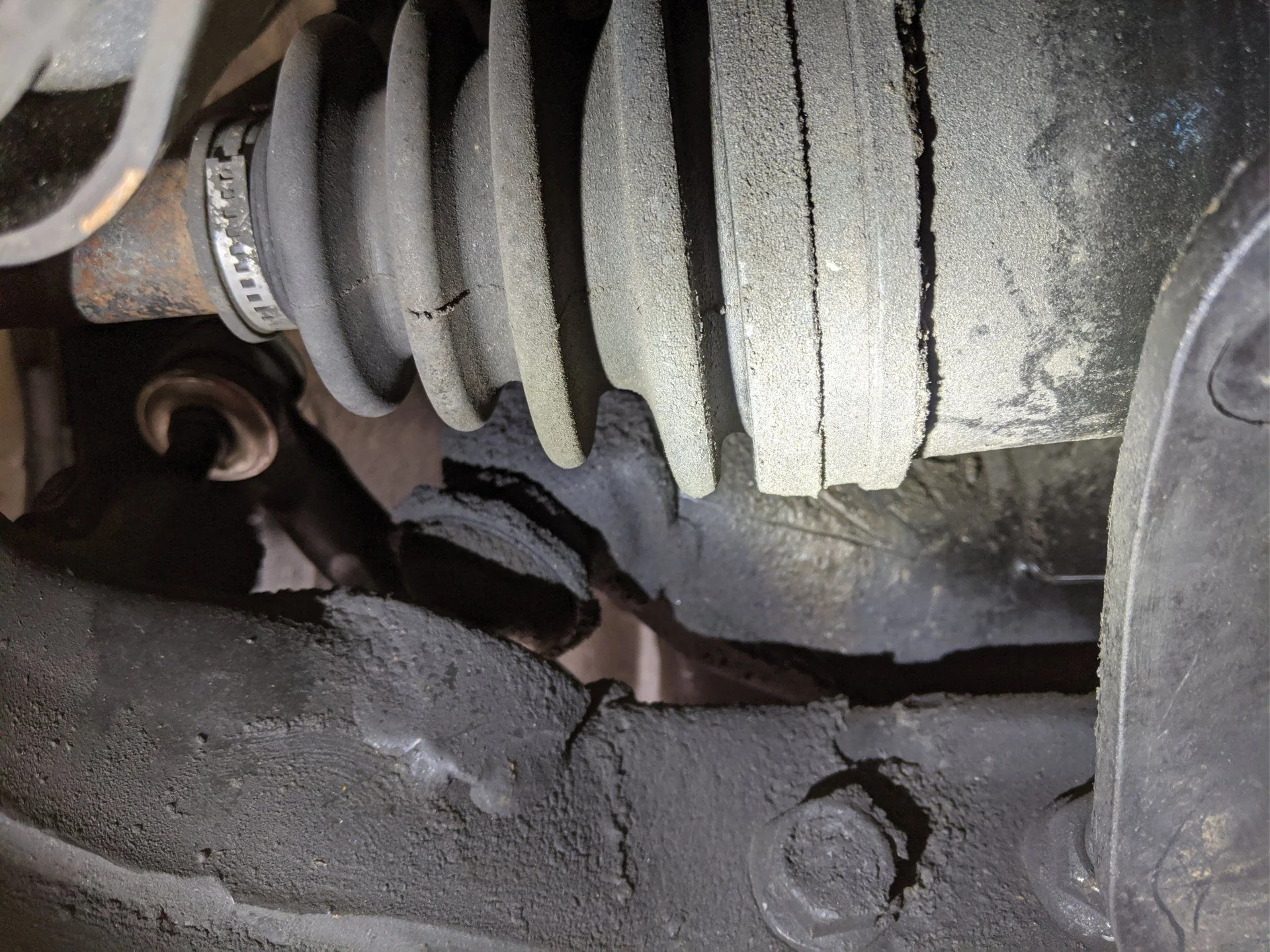

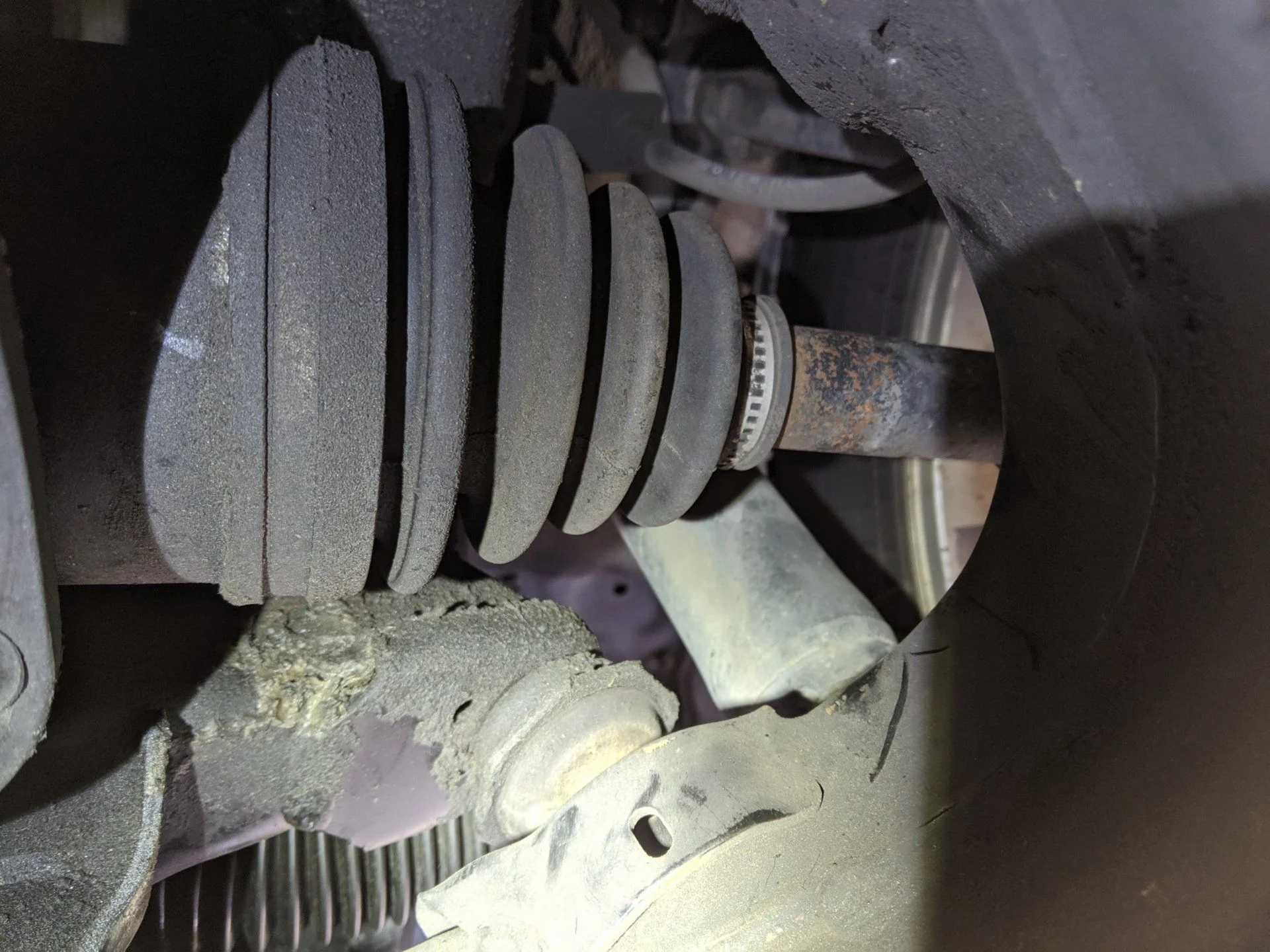

CVs leaking since before I bought the truck. The inner boots appear to have leaked from a loose clamp on both sides. Some grease flung around, but no splits or tears in the boots. A little dry rot, but they are intact. Should I get a full kit and rebuild the CVs or just replace them whole based on age and grease loss? Rather spend $80 a piece on a boot kit vs $350 for axles, but not sure if they will be worn out with the grease leaking like that. Would not be mad if you all told me to just replace the CVs, because then I wouldnt have to deal with the mess of cleaning repacking them.

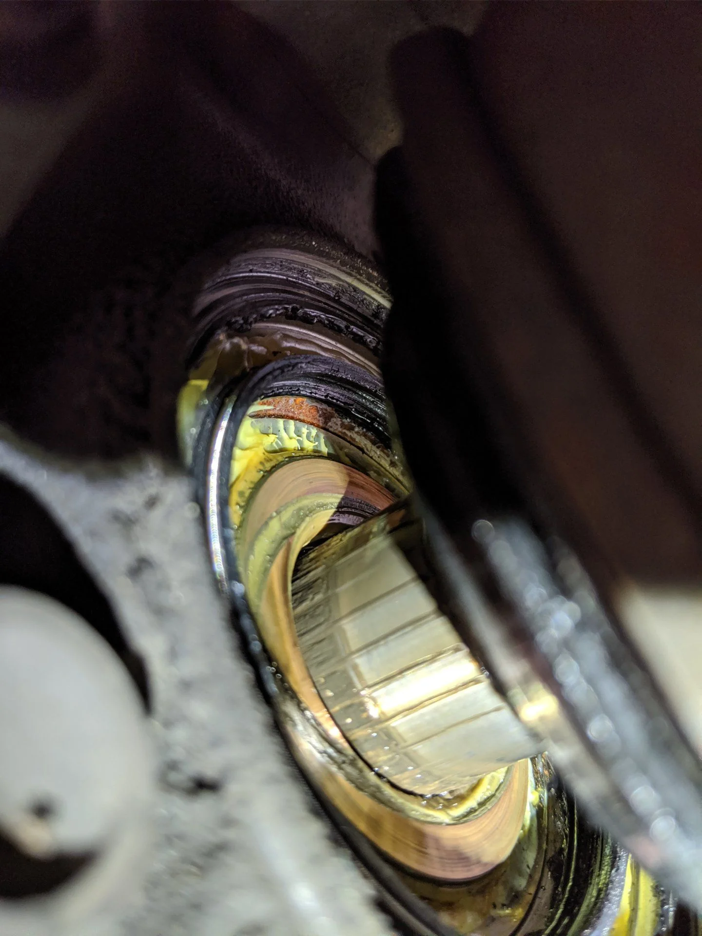

Seals on the back of the knuckle have some rust and factory grease, so they look like they have been there a while.

Some pics here: CVs and axle flange
