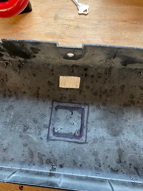

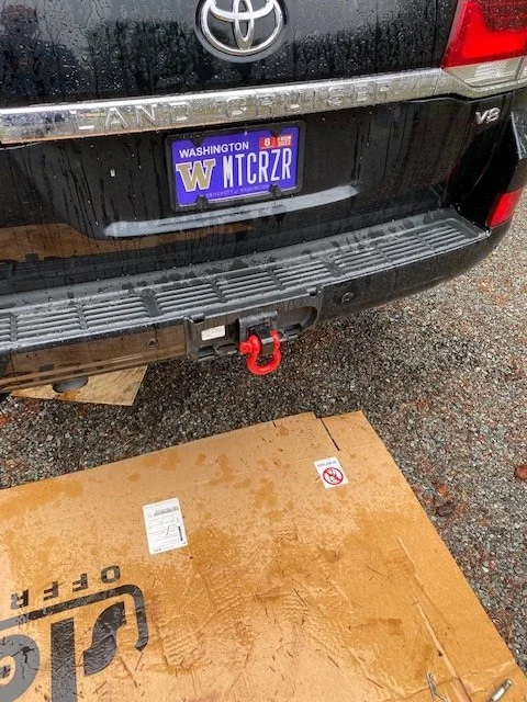

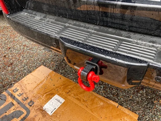

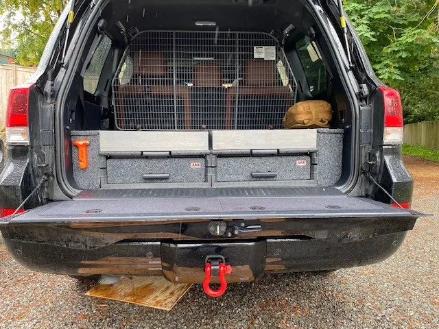

Cut a hole in your hitch cover. And trim it out?
That’s what I did. A dremel and a careful 20 minutes will get the job done.
Exactly what I was about to post. Mark your line with a sharpie, cut with a dremel cutting disk, debur with a sanding drum on the dremel, and trim out with flexible trim (I got it on amazon for my winch fairlead hole when I had a hidden winch mount). I suspect you'll have trouble accessing both the hitch pin and the chain hook eyes, but you'll sort it out.
